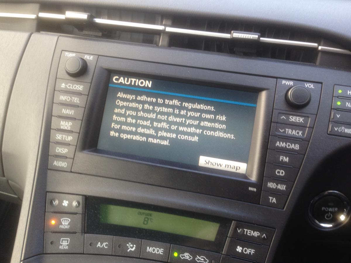

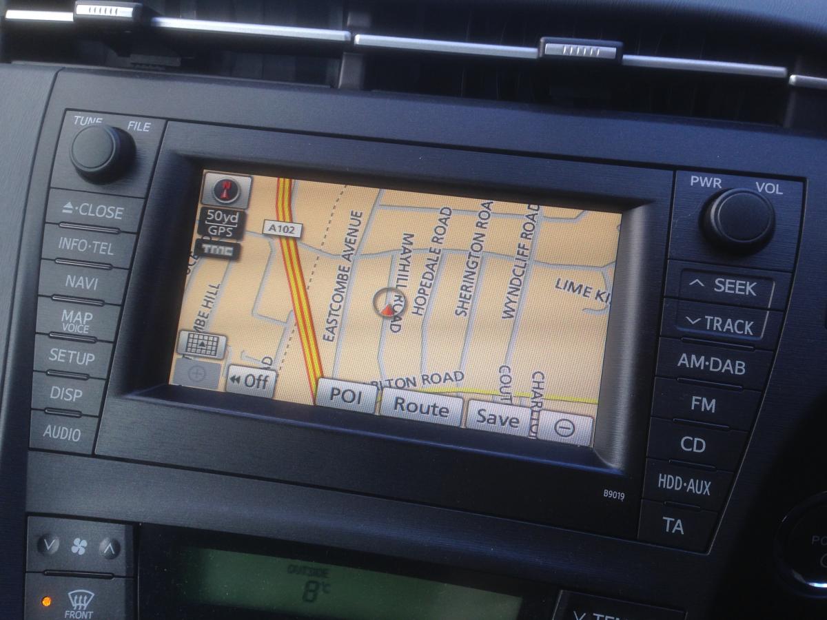

I have a 2011 prius T spirit and I want to upgrade the software to see if the problem I have disappears. Only problem is I can't seem to find the software version that I have at present. Can anyone advise on finding this version info. I have attached a couple of photos to show which model have. Hope someone can help with this.

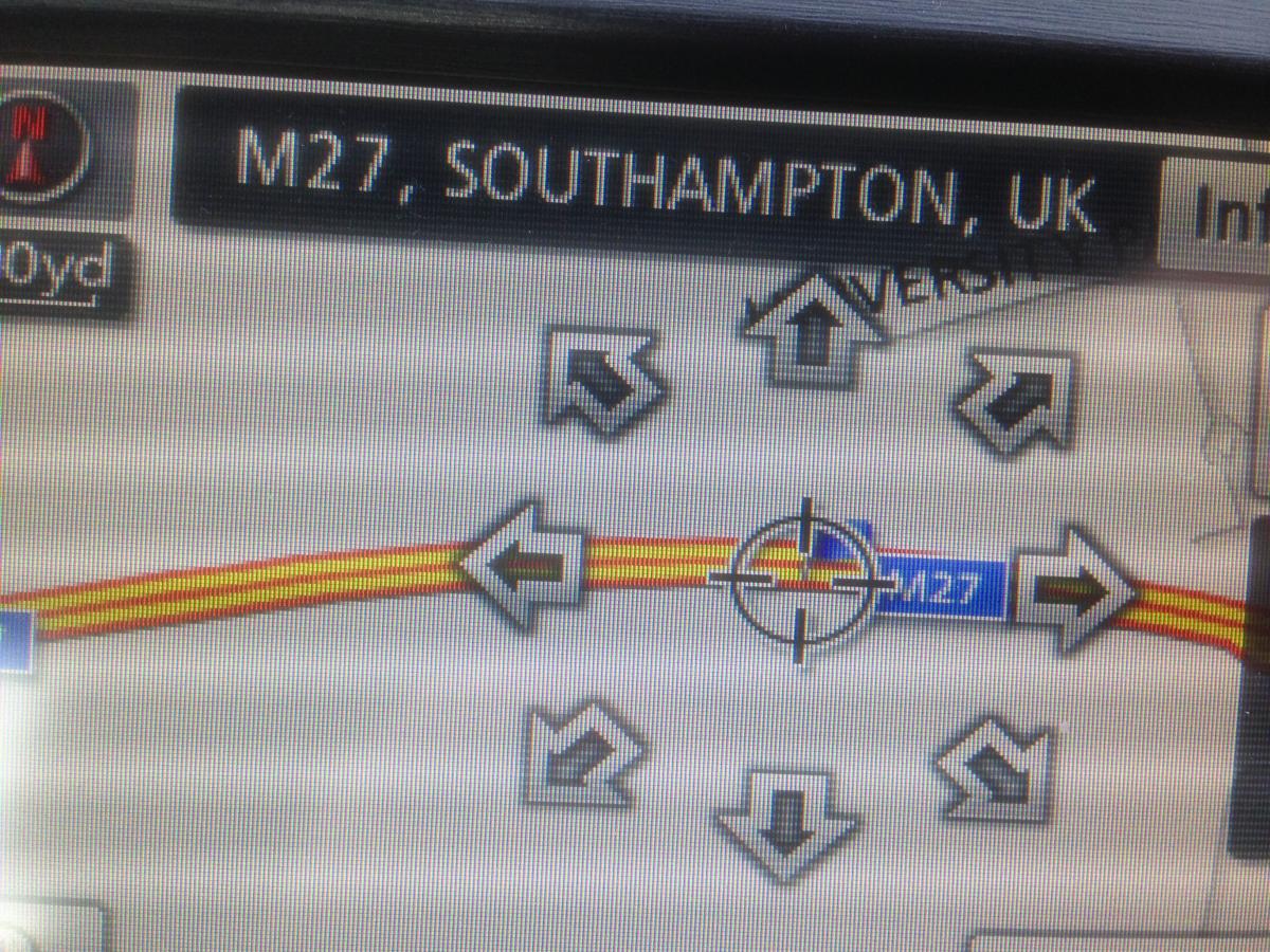

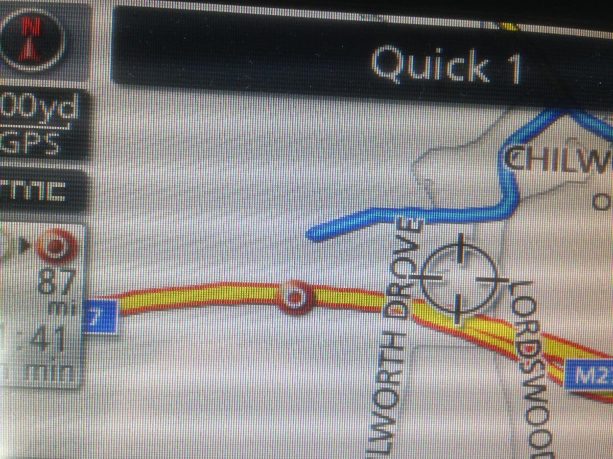

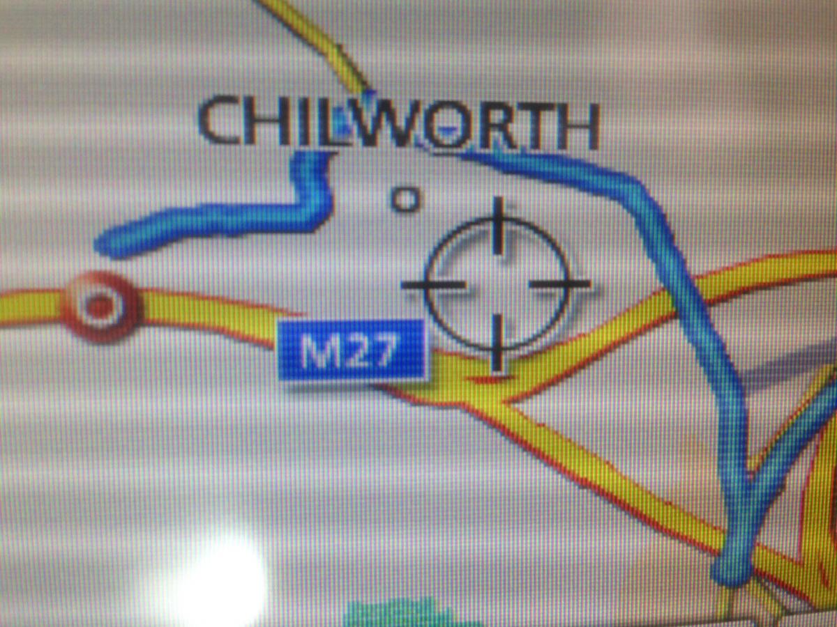

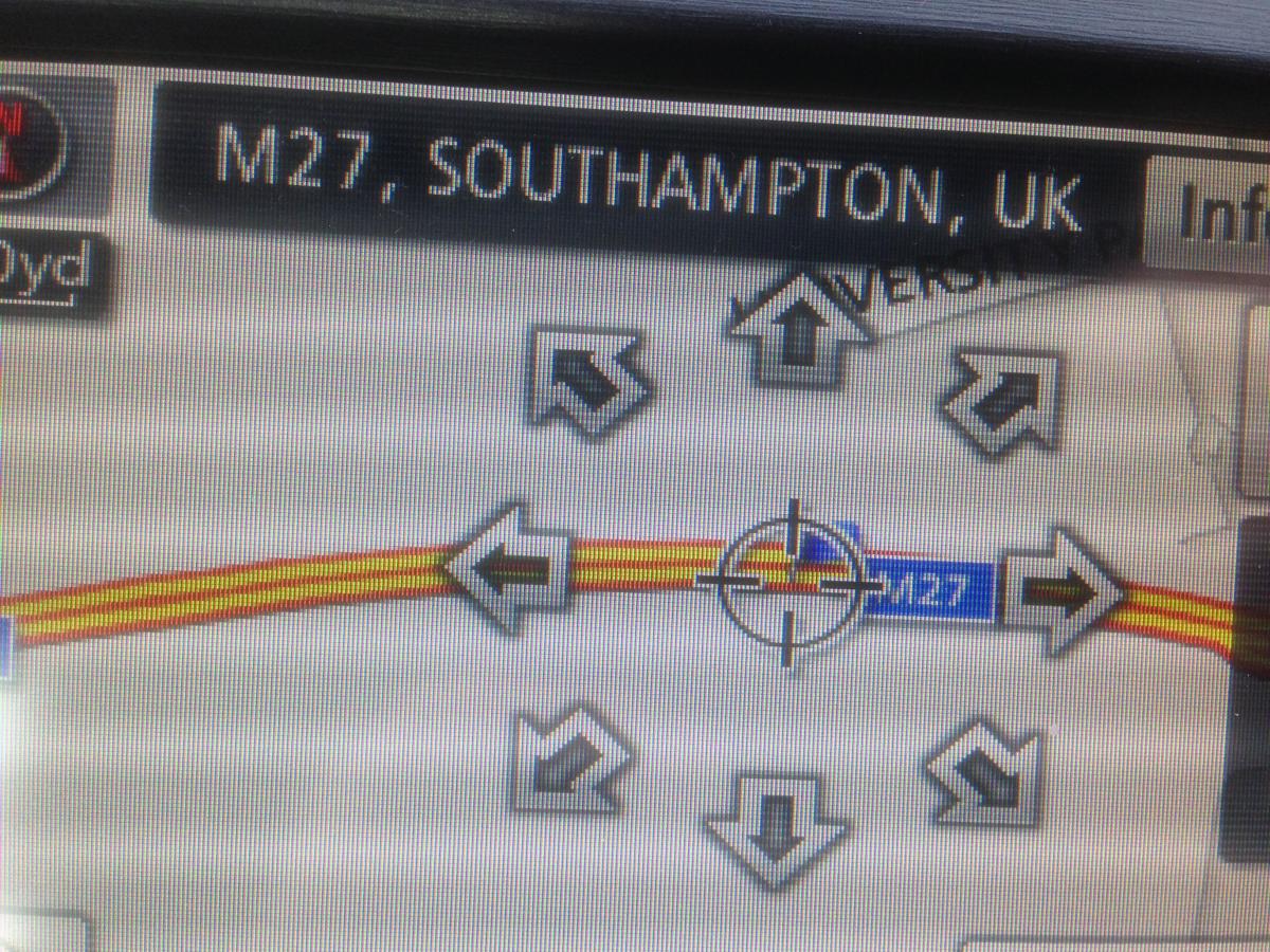

I am attaching a few pictures of the problem as its a bit difficult to explain but basically I select a destination, in this case it was to direct me from the M3 around a link road to the M27, it has fooled me twice before and thats why I wanted to use the sat nav. I select the point on the M27 as first pic but when I start navigation it points to a road somewhere off the motorway and takes me all around the houses to get there. I shoulld add that as I have only used the sat nav a couple of times I don't know if this happens at other locations but surely I didn't pick the only place in the country this would happen did I !!! I hope I have explained the problem.

Perhaps the nav will not let you set a motorway as a destination, the nav appears to be defaulting to the nearest non motorway point to the one you have selected. To check try picking another point on a motorway and see where the nav decides is closest
Thanks Devon Aygo
I had already tried several other motorway destinations and all of those seem to be OK, in fact when you select a motorway destination it asks if you are sure you want to set a destination on a motorway, when you answer yes it will take you there. I have no idea why this particular area of the M3/M27 is a problem for my satnav.

Think I have isolated the problem with my satnav. If I select the destination using "Map" it seems to be OK about 50% of the attempts and will return the comment "are you sure you want to set destination on a Motorway" and then it will be OK.
If I get the exact co ordinates from Google earth and enter those as a destination into a "quick" memory location it will fail as in the picture on reply #7 Also if I set the "quick" memory location using the Map it will fail again as #7 So it seems to be the "quick" memory that it doesn't like. I would love to hear from anyone who has this satnav (as in my first post) to see if they have the same problem. The co ordinates for the offending motorway point is 50 57 39 N 1 24 02 W or any point along that stretch of the link road to the M27 from the M3
