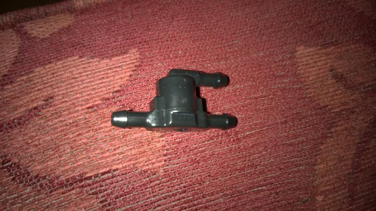

Anyone had any problems with the front windscreen washer pressure? I'm getting good pressure on the passenger side but very poor on the drivers side. I've traced it to the tee piece located on the underside of the bonnet that splits the washer pipe to both sides of the car. I'm wondering if it has a valve in it & whether it be taken apart or not. Failing that I'll need a new part. I've tried soaking it in various things but it's not made much difference at all. Any advice much appreciated :-)
I've attached a pic, if that's any help :-)

It may have a non return valve in it just to stop the water draining back to the tank after use.
I doubt you can take it apart, it's probably ultrasonically welded together during manufacture. If you have access to compressed air you could try blowing in the ports to clear out any debris. Probably a standard part used on many Toyota's though so hopefully a new one won't break the bank.

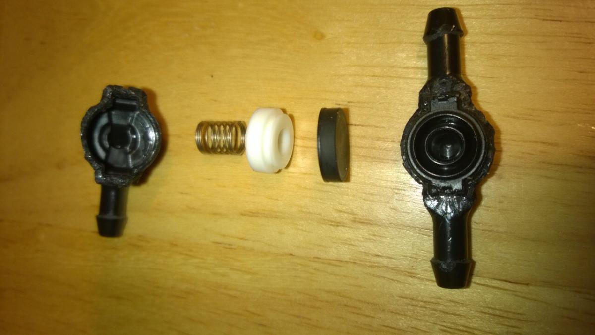

Some lovely pics of it dissected would be great. Its only mechanical. Can only be diaphragms etc

Okdokey, here ya go this is what's inside the thing. It's a spring that pushes against a plastic piston that has a rubber cup on it that blocks the inlet pipe when the pump is off. Pressure from the pump lifts the piston against the spring allowing flow to both left and right jet pipes. It was clean as a whistle inside, so I think the rubber cup was not seated right on the piston or something, which meant it wasn't opening right.

It does seem that way. When you opened it was it in a violent way or controlled? Was the black rubber still connected to the piston? If not, does it push back on as a tight fit? Is there evidence of it being machined or glued on?
David
Opened in a controlled manner, though need quite a bit of force and did have to be done in a way that meant it couldn't be reassembled.
The rubber cup has a lip on the inside which holds it to the piston. It was quite tight in the housing when I took it apart, making me think it had dislodged from the piston and was being forced against the inside of the housing, meaning it couldn't move enough to allow screen wash to pass into the drivers side pipe. I had to prise the two parts out of the housing with a sharp blade. No sign of glue, just the rubber lip on the back holding them together. The piston has a pin hole to allow fluid through, it was clear too though.
Maybe the rubber started to break down and swelled up a bit. Maybe its caused by the composition of the screen wash
