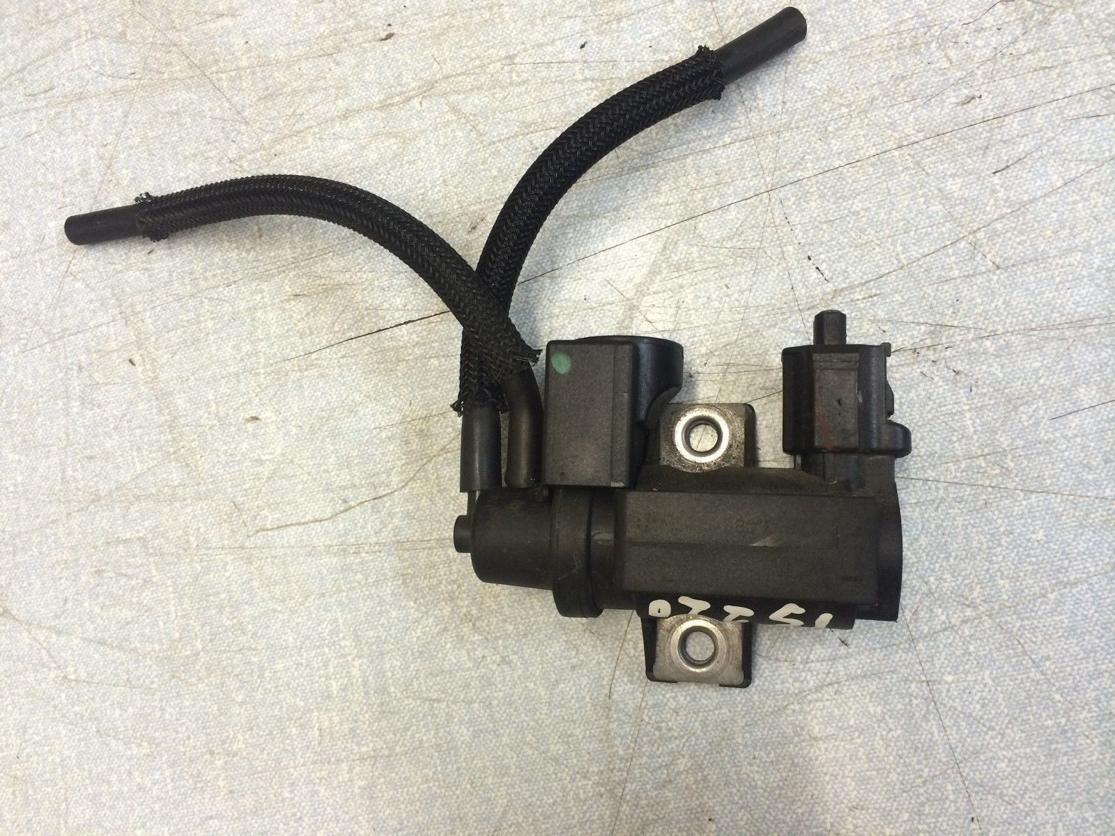

I'm trying to figure out where it's going. I'm getting 17PSI max at the moment and I was under the impression stock was 20PSI, I seem to remember getting that number once upon a time. I'm trying to diagnose it. I've had a remap done and I'm trying to get the turbo to work as I expect.
What @Aggo has labelled up is the turbo pressure sensor as seen in the picture. His arrows sit between it and the VNT actuator, there is no wastegate as this little unit cuts the vacuum which drops the actuator and closes up the vanes diverting the exhaust gas away from the turbine. the right hand pipe that goes off to the left (as fitted to the car, reverse of the image) goes to the left side of the block, I can only assume eventually to the inlet manifold. I don't know whether or not it will work but I'll give it a go, I think it should go before this controller.
If either of you can get me some numbers on your 2.0 D4D engines for boost I'd be very grateful as I don't really know what boost I'm aiming for.
So, for number I have a boost gauge fitted to mine permanently. I have been getting under full acceleration spikes of 22-24 psi (more in cold weather it seems) when cruising at 70~ it's about 6/7 psi.
With regards to fitting a bleeder valve. For our cars I was under the impression that it should be on the cars boost sensor (in my case after my boost guage, before the cars boost sensor) this would allow you to bleed some of the pressure off that the sensor is seeing. What also is a factor is making sure it's a one way valve, or else you'll get a leak when not in boost which will screw things up.
Please correct any of this if I'm wrong...
