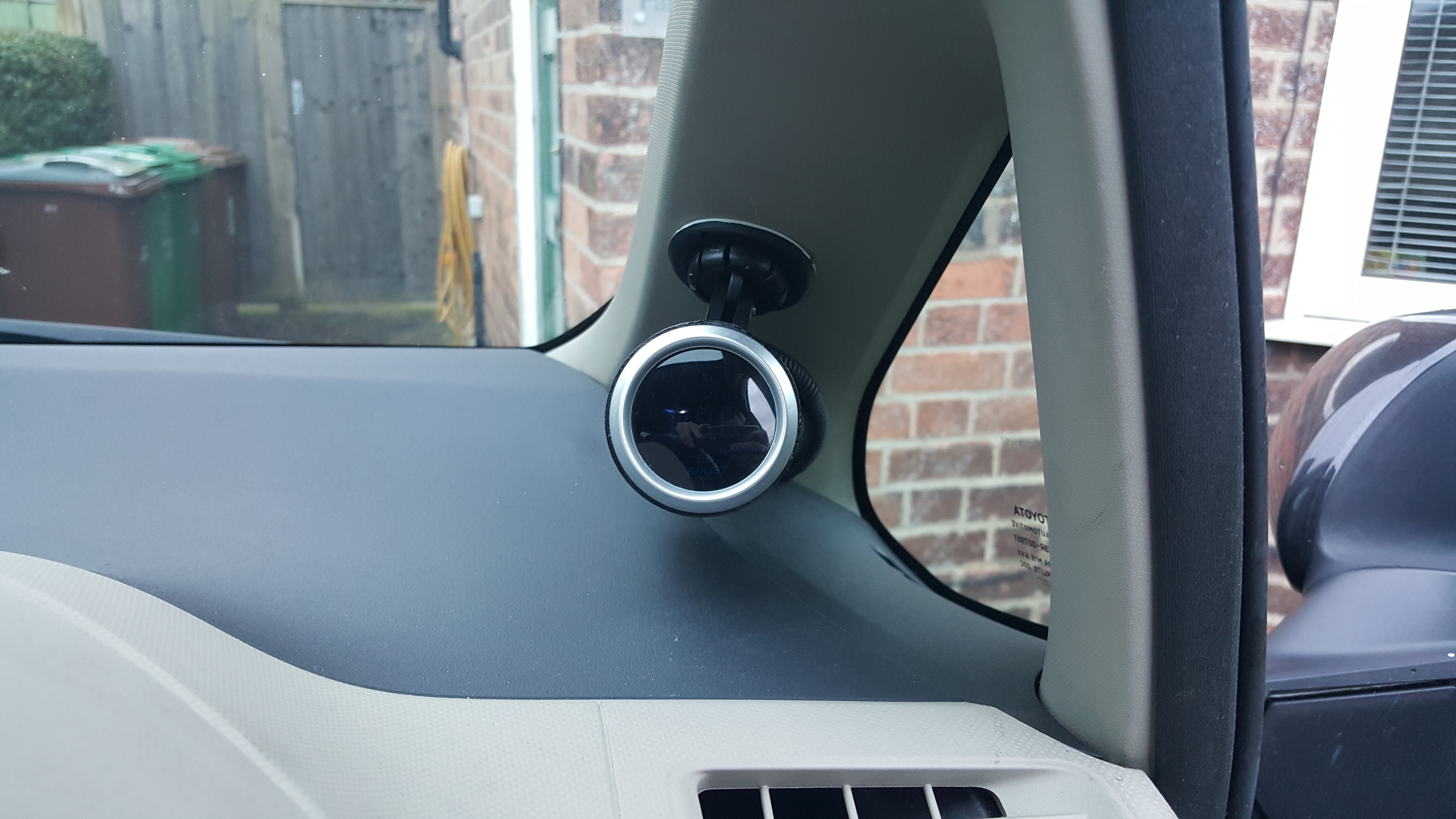

Nice one, That's the only place I could think of too. Not super keen on cutting holes as everything I've done so far is reversible should I come to sell the car.
1 minute ago, Aggo said:
No holes on mine :)
What witchcraft is this?!
Just now, Aggo said:
3m vhb we use it for sign making
where do your cables go?
Edit: I see the tube now!
It's really clean
I like it, the parts are going in my basket right now.
You need it for tuning boost
Gauge was already on the way, I ordered it on prime 7 minutes before the cut off for next day delivery. Not enough time to think about mounting it.... guess it'll be duct taped to the steering column for a couple of days...

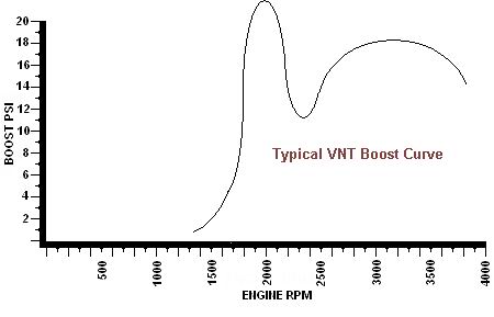

I have a boost problem :c Needle hits 20+ then bounces down to around 14 repeatedly which explains why the ECU is sampling around 17 as it must be taking some sort of average. I did try a suction test on the actuator which seemed to be fine and couldn't find any leaks previously. I'll have to revisit those things I think.
Any other suggestions would be fantastic.
Sounds to me like a boost or vacuum leak in the lines. Have you checked all the maf and map pressure lines, along with the vacuum line that come of the vacuum pump? (i believe our cars use a pump instead of off of inlet vacuum)
It's so very inconsistent. Just went out for a spin at lunch boost kicks in at 1600 up to 2000 hesitates and then absolutely wellies it at about 2300 and read 188hp at 3500 on Torque in 3rd, sometimes it feels a bit numb. This is driving me a little batty, OBD never reads more than 18PSI contrary to the analogue gauge it's tapped right next to. Not sure if it's a leak, actuator rod, MAP sensor, divine intervention.
It exhibits behavior like the graph below which is expected of a VNT but up in 5th or 6th when the flat spot is on/off/on/off/on/off as you climb the rev range much slower than the lower gears it leaves expectation.
Someone come fix it for me :baby:
