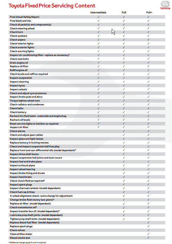

My 2.0d4d o6 Estate is due a service this spring and i'm psyching myself up to carry this out by me myself and I ,so my question is to the lads in the know here ?what would you deem as a full service on this car eg parts and practical work etc...I'm all ears..

Well the car was bought in June of last year and the the seller informed at that point that the car had a full service in March of 2013 ,and a quick look in the Service book does confirm that.
As far as working with tools is concerned i am pretty OK in that department.
Oh the car had done 38 odd thou when i got her and now its sitting on 43 odd thou ,so as you can see i don't seem to be doing the miles these days,but in the main the car was bought to transport my fishing gear around the Uk and France when i go that is..

Oil and oil filter, fuel filter, air filter, pollen filter. Personally I'd check the pollen and air filters before I bought them tho in case they're clean.

If its been stamped with fullservice history the bits would have been replaced.
eg some times it asks you to "inspect" rather than " replace" depending on mileage of the car.
I would suggest you look in the service book and check to see if the last service was a major or minor / interm
Then flip afew pages back and it will give you the full list of things to do.
You may have to replace yourcoolant / brake fluid of its a major service. :)
This may help, just click on the picture to enlarge it :-)
Pete.
