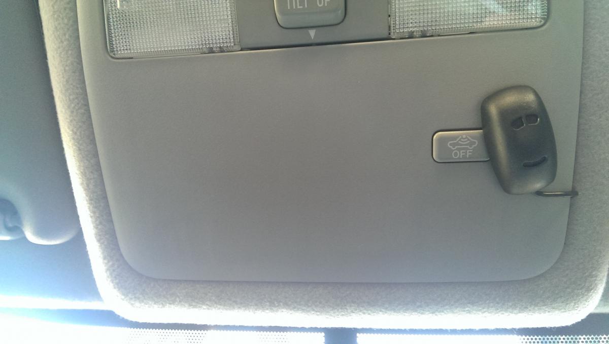

Located on the panel beneath the sunroof switch and main "door open" lights. Assume it relates to alarm/immobiliser but if pressed it just makes the security light next to the clock flash more often with no other obvious function/change. No mention at all in the manual!

Presumably you have an alarm on the car. That switch will turn off the ultrasonic detectors on the inside of the car - intended for when you lock the car but leave, for example, a dog inside, and this will prevent the dog from setting the alarm off.
Thanks, i honestly don't know if it has an alarm....it has a security light next to the clock which flashes when the car is locked, however i can find no mention in the manual of anything other than an immobiliser which this light is apparently linked to. I guess the glass breakage detection thing toyota mention is an alarm? It is definately a toyota switch and panel so 100% sure there is nothing aftermarket.

I would imagine the glass breakage protection is provided by the ultrasonic detectors - hence having the switch inside to turn them off for when you leave a pet (or the better half?) in the locked car.
