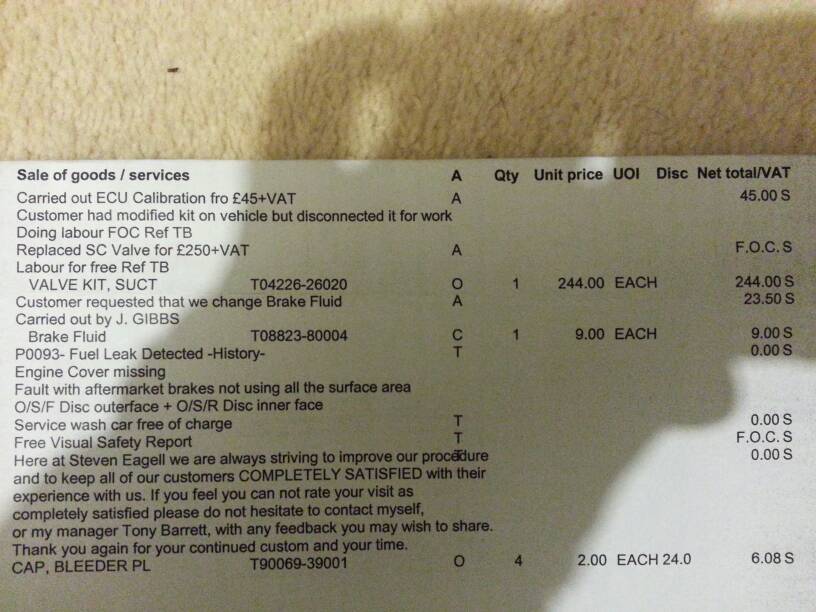

Good grief that's not right.... I just had mine done and only got charged £45+vat for labour of the ecu update...
May be a little cheaper than some others on the forum, probably because I had other work done at the same time.
I believe the correct cost is £99 labour charge.

Wow, where is your dealer, coz the one in warrington and liverpool both gave me similar quotes...:( I guess the valve price is the usual price as other makes seem to charge the similar values.
But the labour just doesn't feel right.

Yep it'll be your scv. I'm just amazed that you're getting these prices for an ecu update....

Well the liverpool dealership did not mention any ecu update, and the one in warrington said that this was not need as they were not aware of any software update, and kept trying to get me to book for diagnosis also.
Yes my dealership said the same, and tried to get me to do diagnostics that would run into the hundreds..... I just politely told them all I wanted done was a new valve, I also gave them the new part number and Toyota service bulletin number.
But they knew there was an ecu update with this valve.... So I didn't have to fight them on the update, just fight then NOT to do any unnecessary diagnostics..

When I called I spoke to Tony the service manager..... He was real nice and explained that if it didn't work, I would have no comeback. But I knew it would work.
Call back and ask to speak to Tony and explain that they've just done mine, Mr Appleton's last month, with exactly the same symptoms.....
The worst that would happen is they would charge you full price for an hours labour..... £99..........
