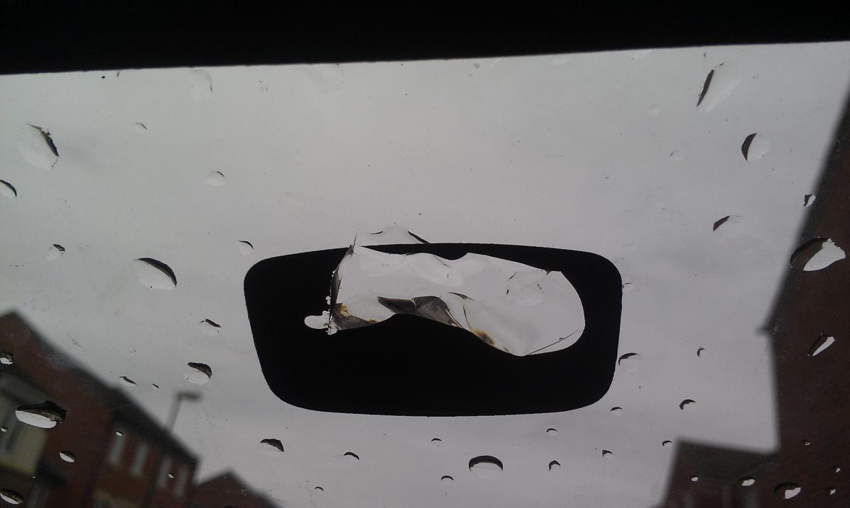

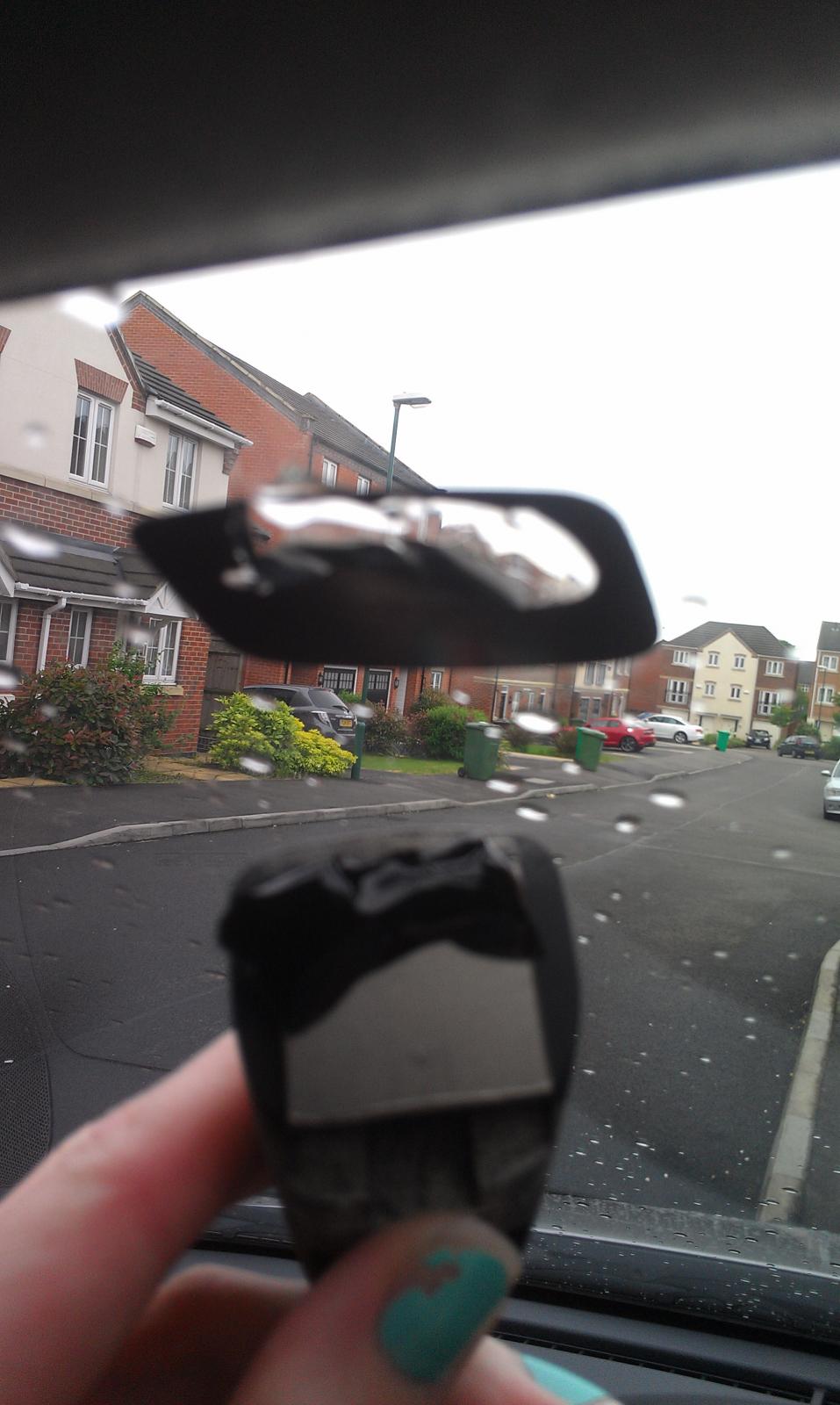

Thanks for the quick reply. It seems to be windscreen glass.
I've taken a couple of pics (excuse the chipped nail varnish)
post-141039-0-16877100-1401203886_thumb.
post-141039-0-47420300-1401203875_thumb.
Ive contacted Autoglass who have given me an appointment for tomorrow. Its going to be a replacement, they said any interior windscreen damage requires a replacement rather than a repair
Makes me wonder whether the windscreen had already been damaged externally, and the knock on the mirror was the last resort. As regards the mirror, the ball should push back into the socket - perhaps cooling the ball down with some ice or cold water or some lubrication may make it easier to get the two parts back together. Failing that, you could see whether the Autoglass technician can do it.

The autoglass technician fitted a new windscreen but even he couldn't put the mirror back together so looks like I will be having to buy a new one. Thank you Frostyballs for the advice there, much appreciated.
I suspect there may have been some previous damage that wasn't visible before as I only got the car recently so cant prove it but I'm sure I'm not that strong. Even so, doesn't look like I will be needing any self defence classes with an elbow like mine :)
Not impressed i've already had to put a windscreen claim in when i've had the car just under a month, but at least i'm fully comp so I didn't have to fork out the full £327 I was quoted!
