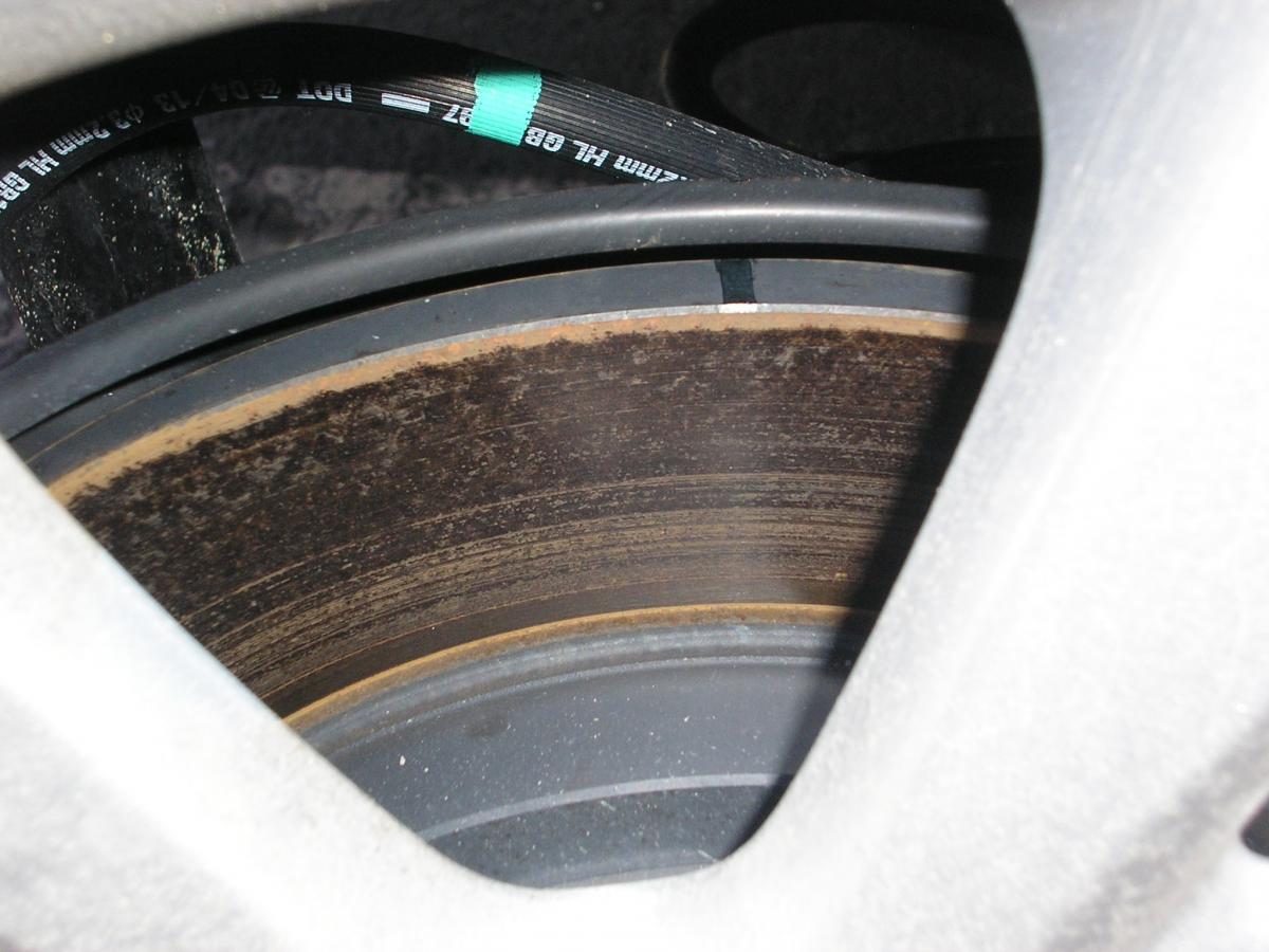

I've driven 72 miles, and it's back in the workshop for four new brake discs, new brake pads, and a full caliper overhaul x 4. And the list goes on.

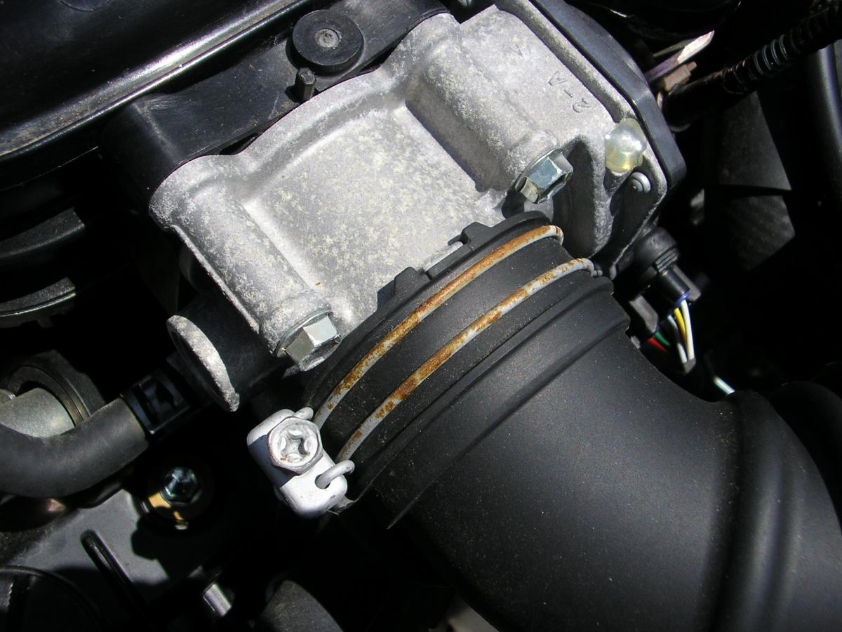

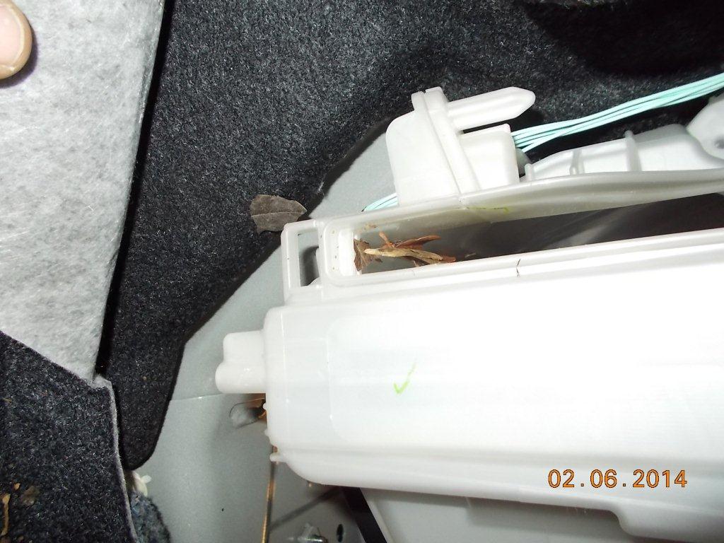

I have been in touch with Toyota UK and the dealership principle.

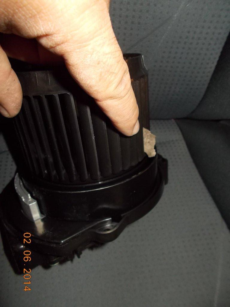

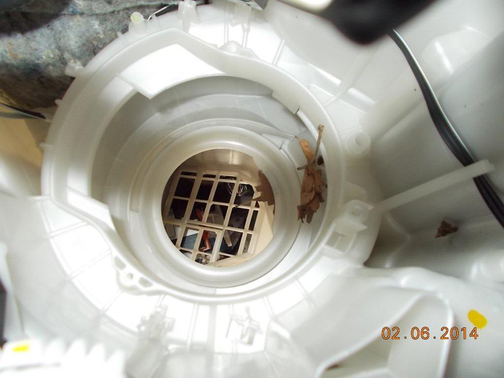

The reason for the exceptionally loud and vibrating fan blower was because there were numerous leaves inside the blower housing and a Sycamore seed (Propeller) trapped between the vanes of the blower itself. The Sales manager called me on the Monday morning to tell me that they had found leaves, twigs etc. inside the blower casing, and he also sent me some photos that they had took to prove it.
But then when I looked at the photos I was even more peeved when I saw the photo of the Sycamore seed in the blower fan.... because they placed it on the front seat to take the photo without even putting a seat cover on the seat!

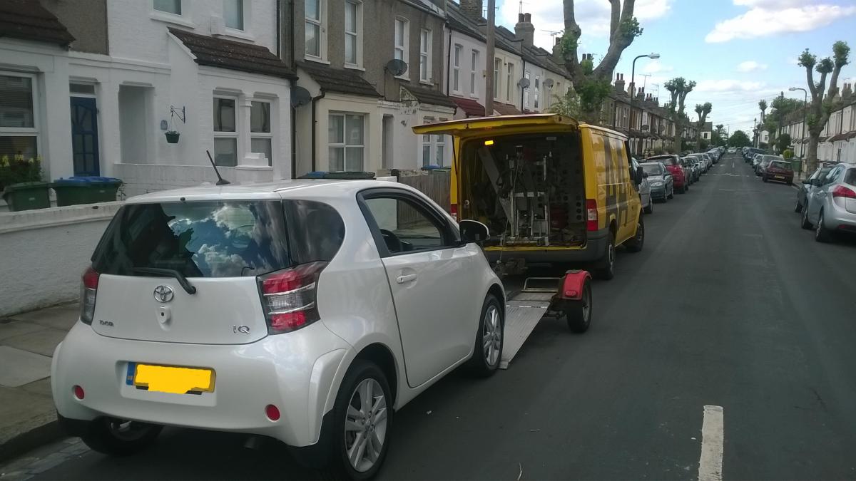

I took the car home and called the dealership to come and get the car, but to collect it with a low-loader as it was not fit to drive.
It was when the AA came to get the car and I was taking photos that I noticed a twig that was caught between the gear selectors on the top of the gearbox, which explains why I was having trouble with the gearbox, and there was also the remants of more leaves etc.
The car is now back at the dealership and Toyota UK are fully involved.

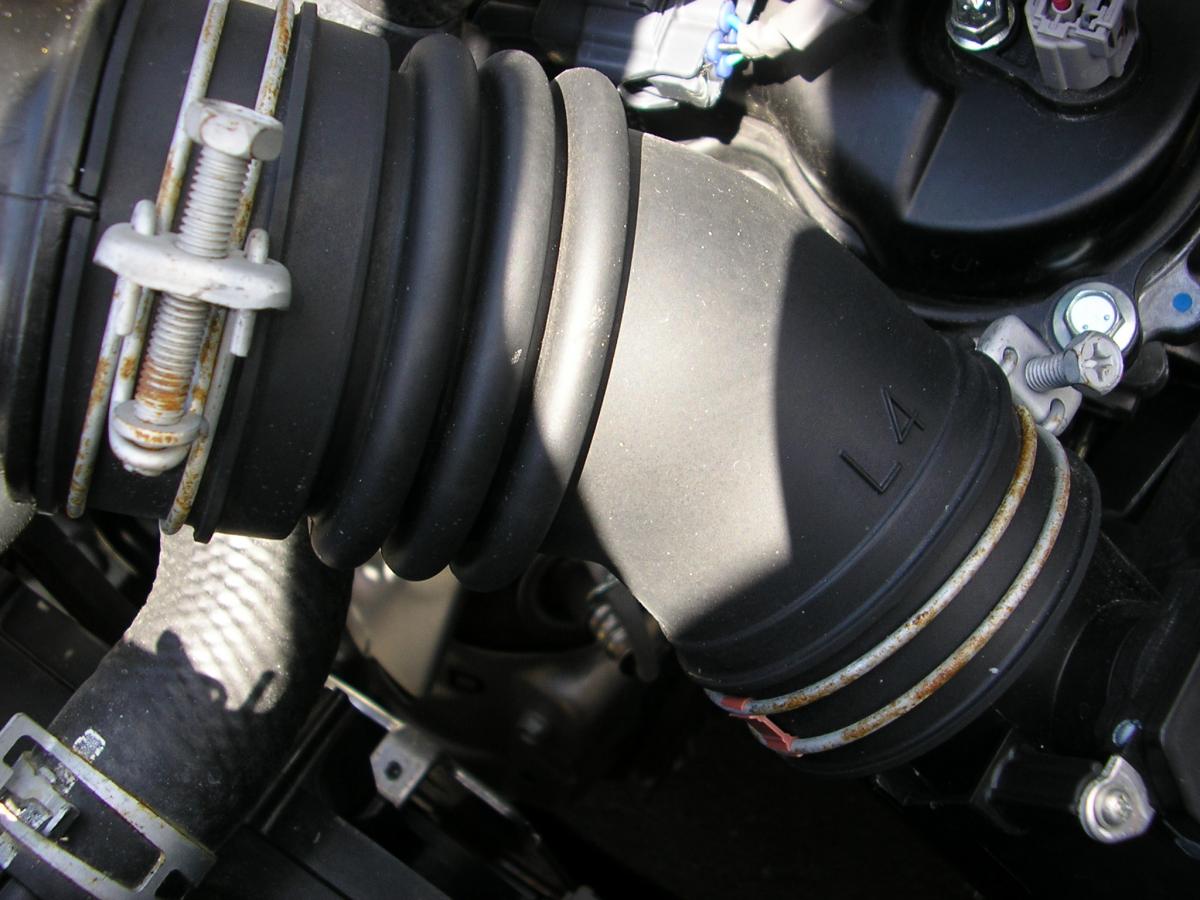

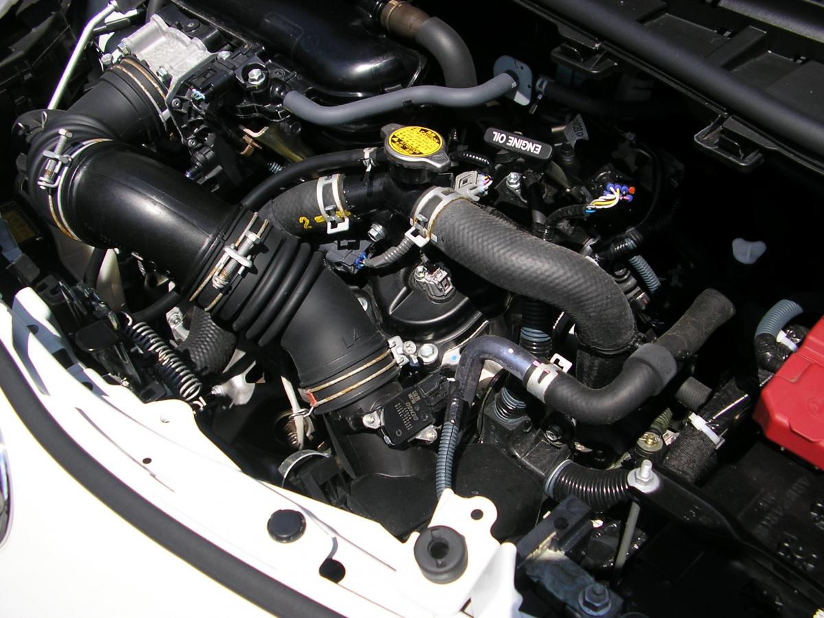

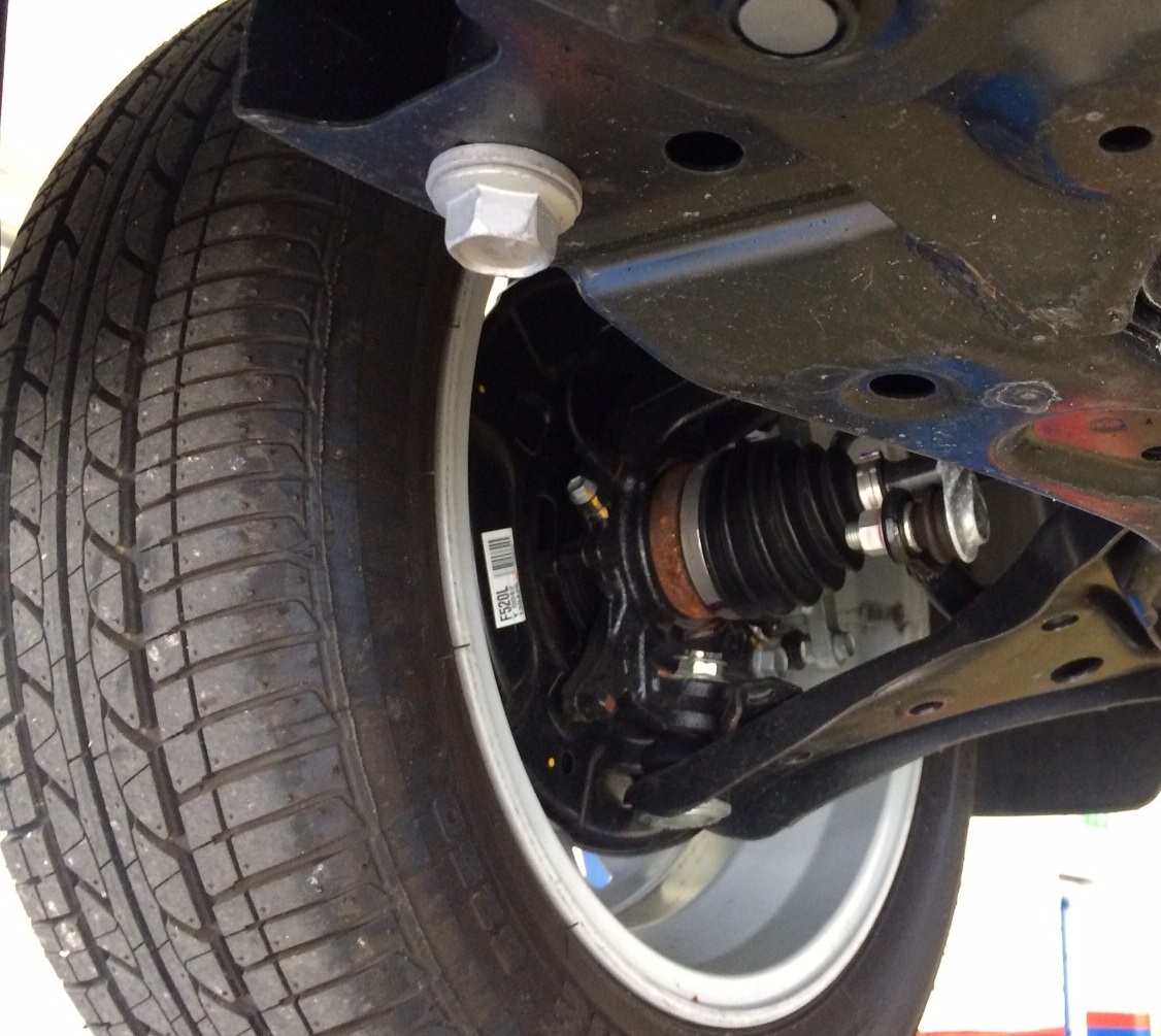

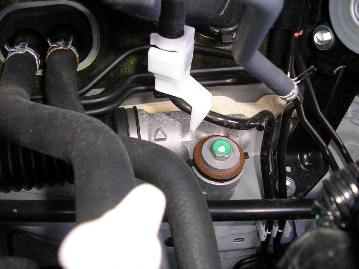

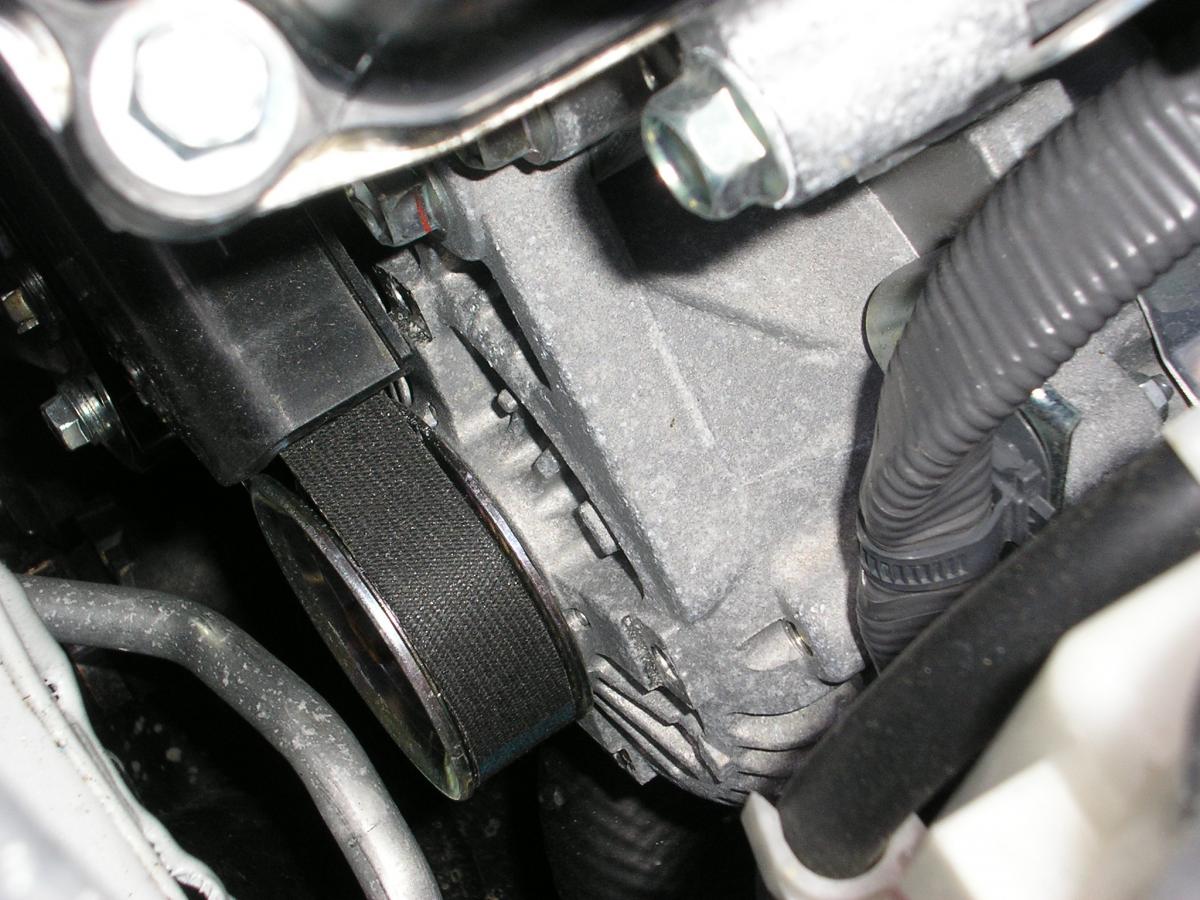

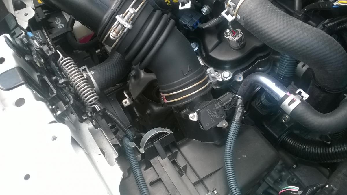

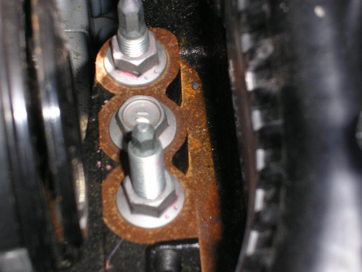

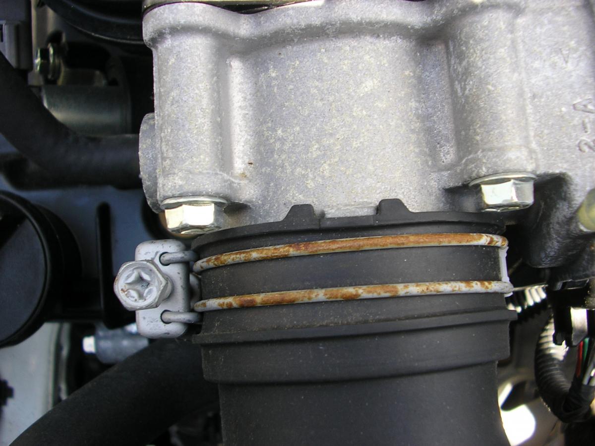

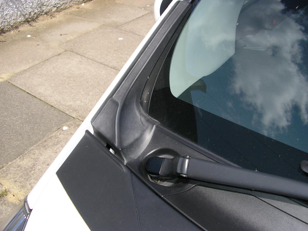

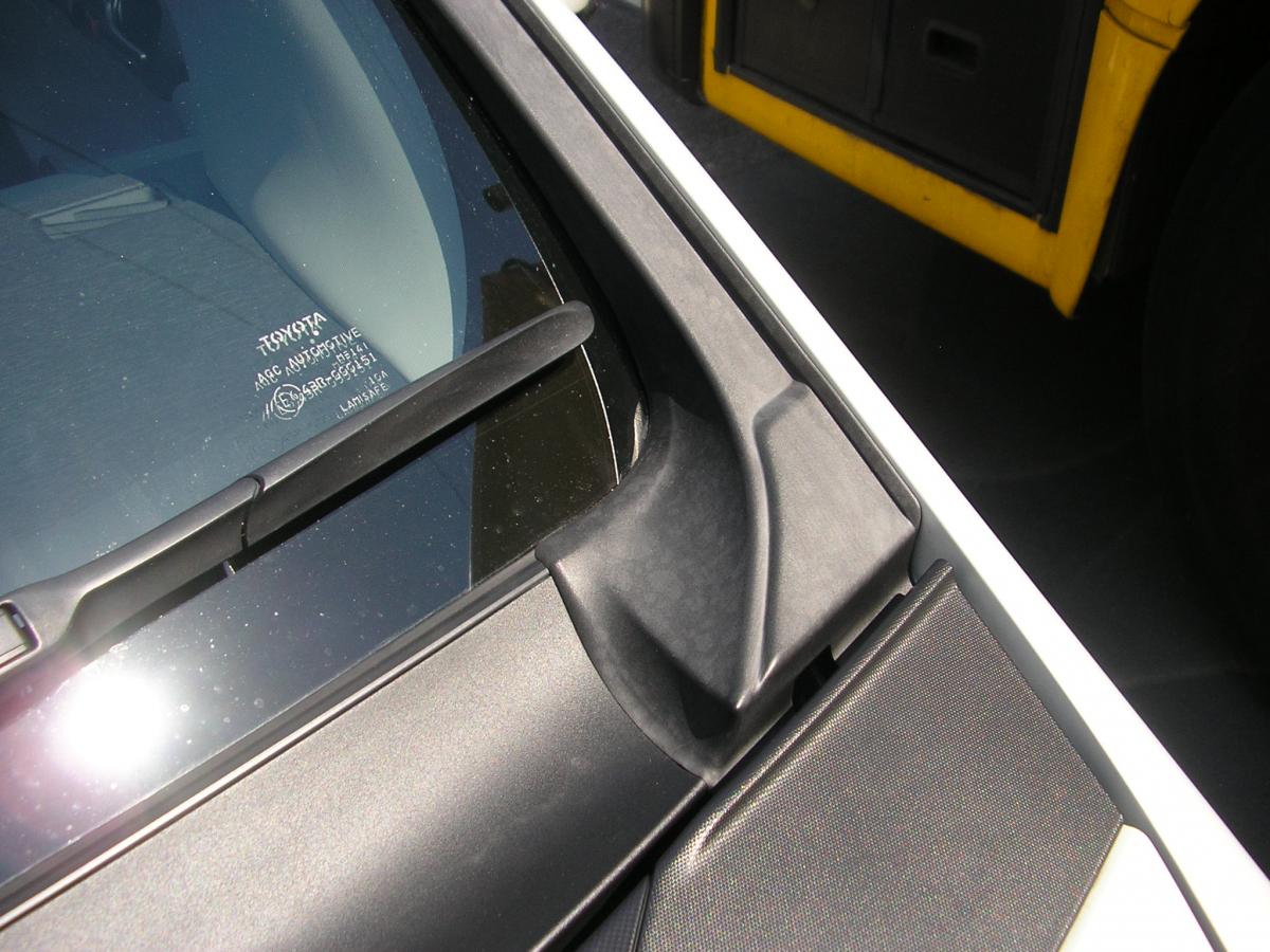

Here are some of the photo's.

Looking at the photo's, the standard Toyota pre inspection should have picked up 99% if not all of these issues, and then they should have been corrected in advance of you taking ownership of the car. It looks like this was not done by the dealer ?
So many of these issues are just visual so they can be easily seen.
My IQ is 4 years old and I have just a very little rust on "some" of the areas as shown in your pictures, Rusting in your pictures is quite heavy in some areas, however on a new car it should be ZERO in my view.
