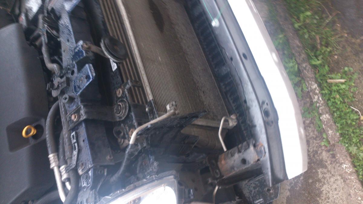

After topping it up a few times, I got fed up, and we decided to probe further. What we found was a nasty radiator leak as well as noticing the headlights, and slam panel had a date of 2012 on them! There was also a bend on the condenser, but nothing too major.

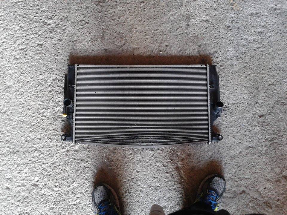

A week or two later, I bought the new radiator, which was a complete pain to fit (Thanks to my mate for fitting it!), but the old one had ballooned like mad - a current or previous HG symptom (image attached).
I've read these D4Ds are known for suspect head gaskets, so I'll be calling up Toyota to see if any warranty work has been done - no other symptoms just now.

Sounds like the car has had some accident repair work done - hence the 2012 labels. Suppose it is possible some of the damage to the radiator and condenser could have been done at the same time.
For panels to have 2012 on them I would suggest it has had a bump! Get your dealer to run a service history check on it and see if that reveals anything, failing that an HPI check

In the mean time just monitor the coolant level. I would not worry about the head gasket problem yet. I would want to know what else has happened to the car, and compensation for the replacement radiator. I would also want a replacement condenser so it all looks good. If I inspected your car, the condenser is still a give away as well as the slam panel and headlights.
