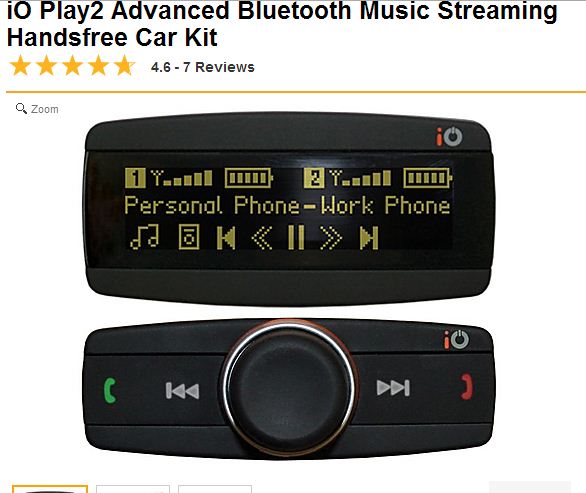

Hi,
I was looking at one of these and wondering if anyone had got one and what sort of feedback there is for it?
post-124112-0-24986000-1403535424_thumb.
Also I would be interested if anyone has any feedback on fitting it, and whether it went relatively simply or not?
I'm concerned as I have a 2006 Avensis T4 D4D with the SatNav and the steering wheel controls.
Do I lose the functionality of the steering wheel controls if I fit this?
Thanks,
D.
Looks expensive. There are loads of cheaper options out there. It really depends on what you want the bluetooth functionality for. I thought I'd use it for music as well as calls. I've since reverted back to a wired Sony mp3 player. It's much easier to select tracks whilst driving. I don't make calls whilst driving and only receive them. Consequently the Kinivo btc450 bluetooth set works well for me. I would think the functionality of the steering wheel controls may be reduced to volume only.

I agree with Gary. The iO Play2 is too expensive compared to what is available. I have a Novero bluetooth system that cost £60 a couple of years ago. It is similar to the iO Player (and Parrot) and the way it is connected to the audio unit is via cable adaptors. I had use couple to connect the head unit and from the car side. No wire is cut! You will need Toyota to ISO cable.
The installation will not affect the remote steering. Gary has mentioned the other companies like Connects2, which I have a very old version for my mp3. I installed an Xcarlink version into a car and it had the whole lot - MP3 and bluetooth. The head unit controls the whole lot via the steering controls. Just plug into the rear of the head unit. None of the systems I installed cost as much as the iO Player.
Search the forum for ideas, and check eBay and incar audio re-sellers to get a better deal.
