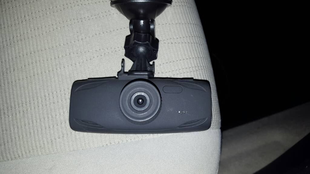

I have installed the DOD LS360W..... http://www.dod-tec.com/index.php/product/detail/72
But I did mask it all up and spray it with Matt black paint. Too much white text on the front, and too much shine.... Other than that it produces great video both night and day... It uses a Sony Exmor Sensor.....

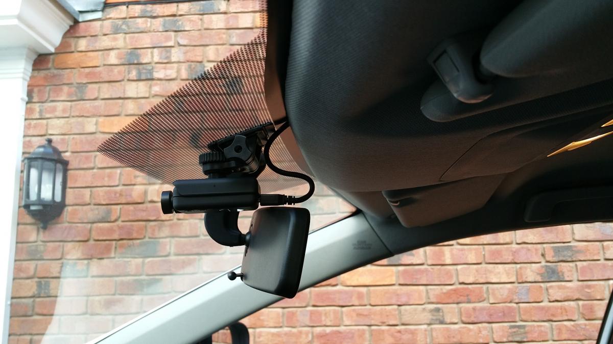

I mounted the front using a bike helmet mount, sticking it on the black dots behind the rear view mirror (that gave the camera the best view and kept it almost invisible to people outside the car - so I can leave it in when I park the car)
I ran a 5m power cable from the camera, tucking it under the roof liner to the passenger A pillar, tucked it behind that pillar, round the dash and down the left of the dash (where you can turn the airbag off). That way the cables barely visible and it was a simple job, needing no trim removal :) I finished off by popping the rest under the passenger floor mat and up to a cigarette lighter USB charger.

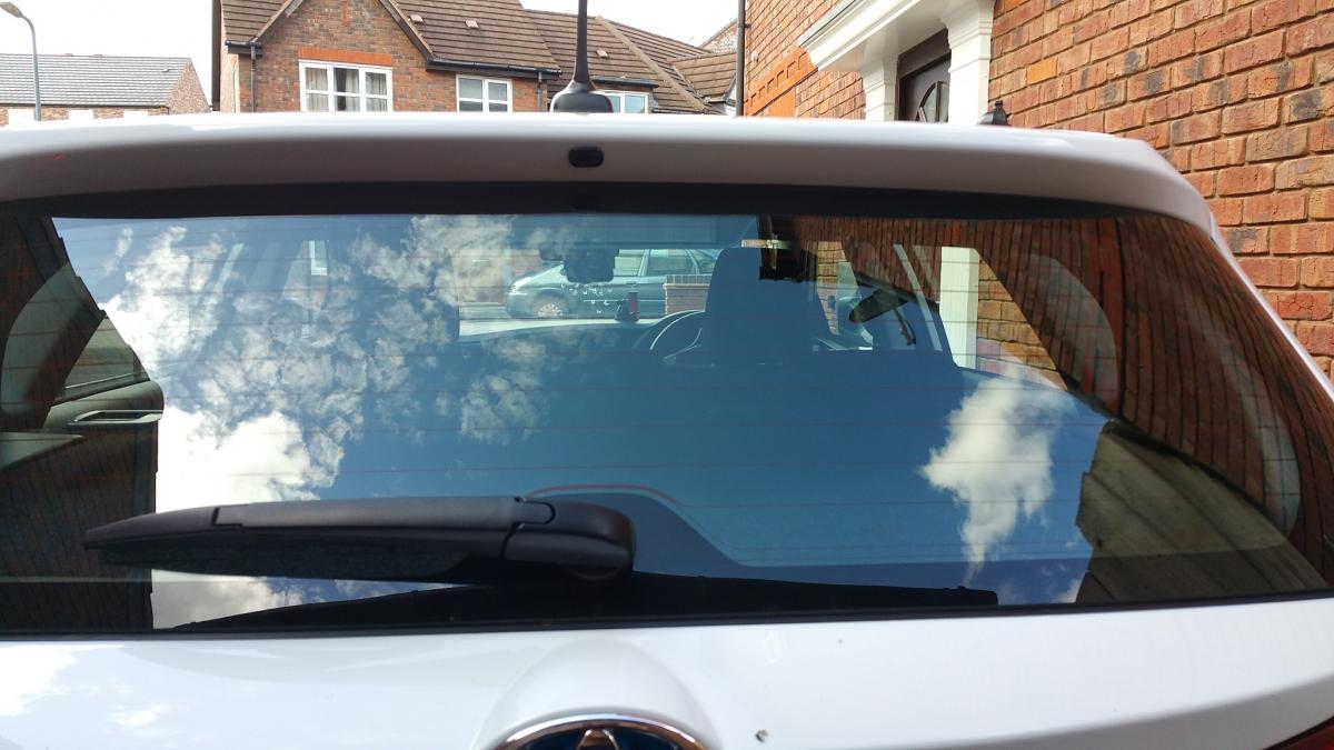

I mounted the rear camera on the plastic trim under the high rise brake light. For power I ran a mini USB car charger from the boot power socket, under the rear driver's side pillar trim and up to the roof lining where I left a few cm sticking out in the top centre to power the camera.

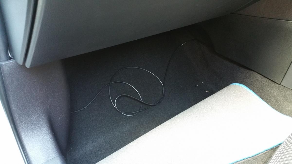

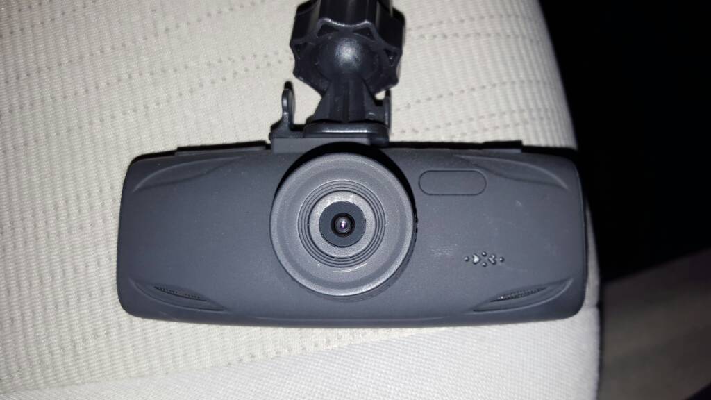

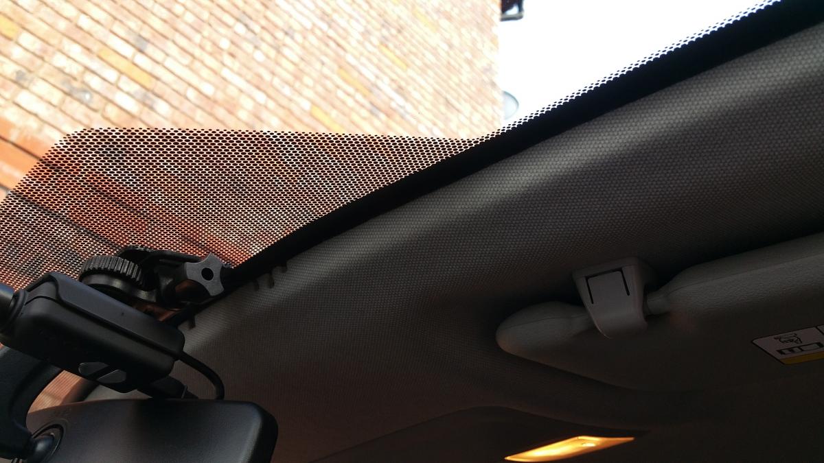

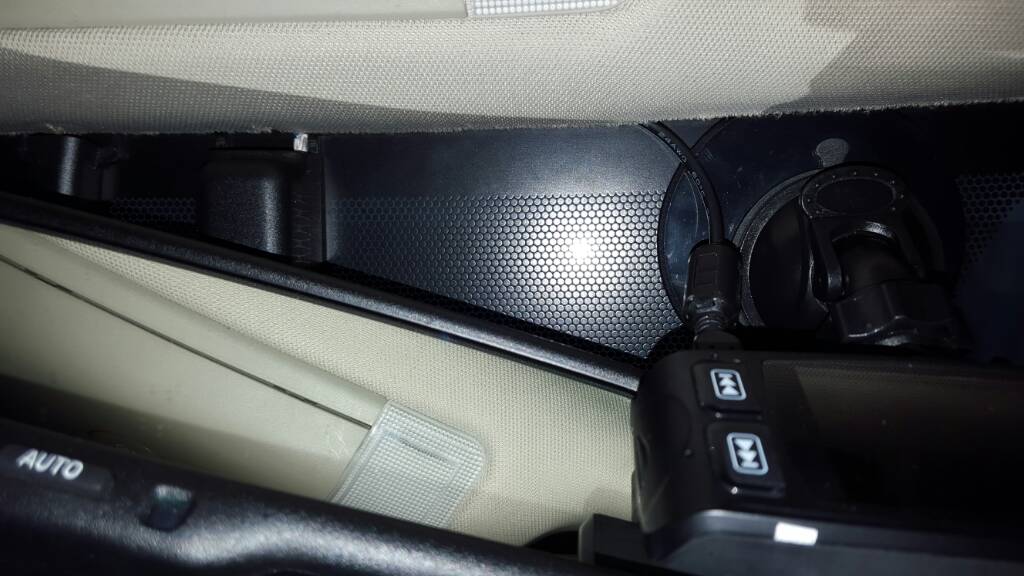

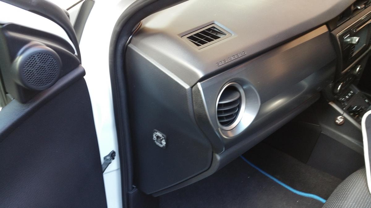

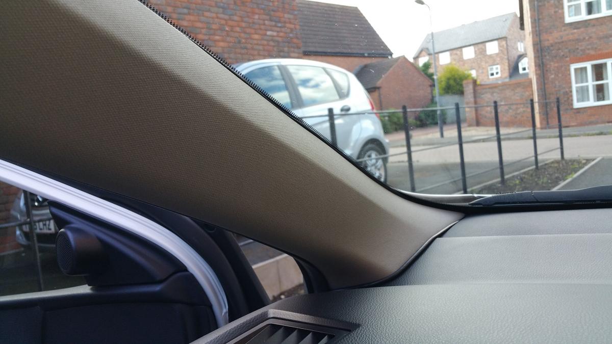

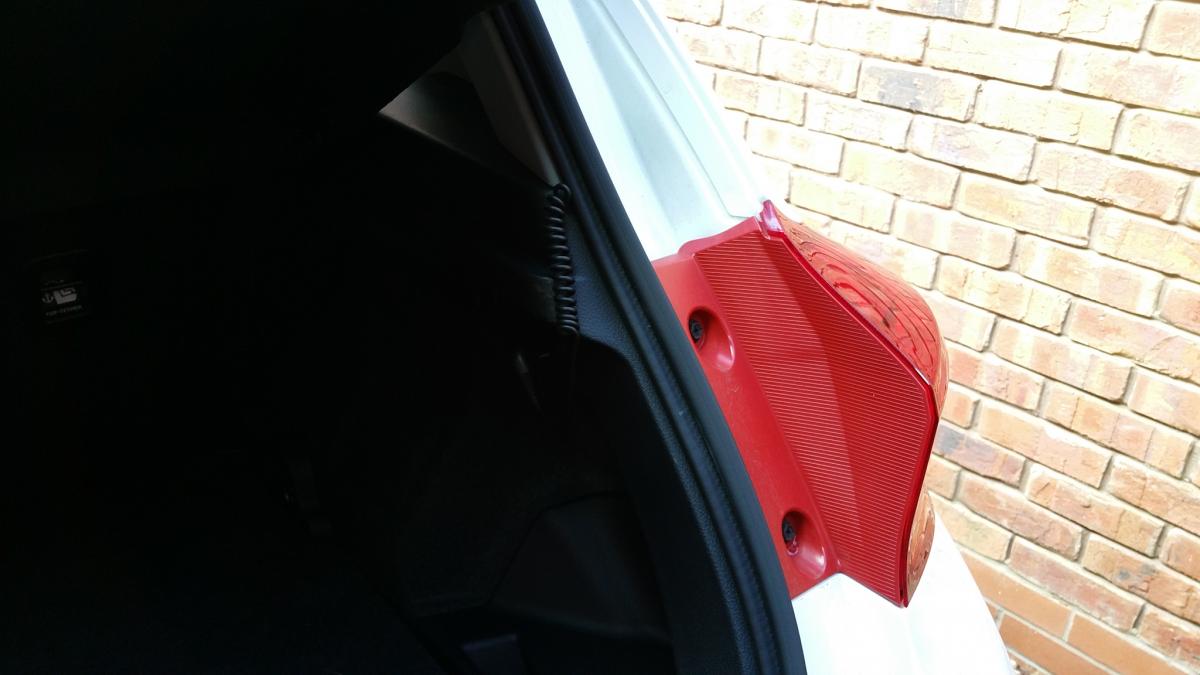

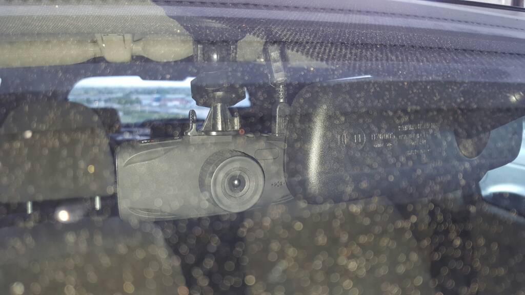

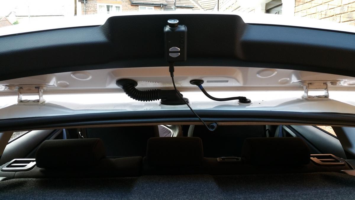

As promised here's some pics.
As you can see, very little cable is visible and it took very little effort to tuck the power cable behind the roof A pillar trim.
From the outside of the car the cameras are almost impossible to see. I tried to get a good photo of the outside view but got mostly reflection so gave up :)
As you can see, very little cable is visible and it took very little effort to tuck the power cable behind the roof and A pillar trim.
I lifted up the floor mat to show what I'd done with the cable in the dowel. I thought about tucking it under the glovebox, but found the pollen filter there and didn't want to cause problems with it so went for the easy option :)

This is awesome install! Few points/questions, not to judge you and maybe there's a reason you didn't do so because you noticed it was impossible or not practical during the process. Just some of my thoughts to maybe learn something :)
Why didn't you route the wire to another side of the A-pillar? You could tuck the cable under the pillars top side and then all the way down close to the door. Now you routed it on the "wrong" side and then to the door side of A-pillar, this is what makes the cable visible there (3rd pic).
Why didn't you route the wire inside the panelling all the way to B-pillar but put it on the floor instead? You could've routed it to the cig lighter directly under the front seat.
Why did you attach the rear cam to the door, not just to the rear part of the roof? You would not need to leave the excess wire in that case.
Could we get some sample videos to see? :D
I routed it down the windscreen side of the A pillar because the top section wasn't pulling away enough for me to get the cable through to the door side (that would have been a preferable route as you rightly stated because no cable would have been visible).
I was worried about pulling too hard on the pillar cover as mine contains an airbag.
I figured a little bit of black cable going across a black dash was better than a face full of airbag, or damaging it....
As for the floor mat conceal, I'm not great at getting panels off without damage. Rather than going for the B pillar which meant using a panel that didn't pull easily, I ran it under the mat to the centre console. I then tucked it under the centre console towards the back of the front seat and routed it up to the charger about half way along, so it comes out just in front if the passenger seatbelt - that gave me the same result but with less dismantling.
I mounted the rear camera on the plastic under the high rise brake light because it gave the camera a better viewpoint and the supplied Velcro was unlikely to stick to the ceiling cloth as securely. Additionally, it would also have been harder to get the cable under the rear ceiling cloth as it was stuck tight.
The route I took was quick and easy in comparison :)

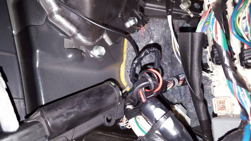

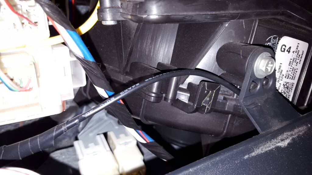

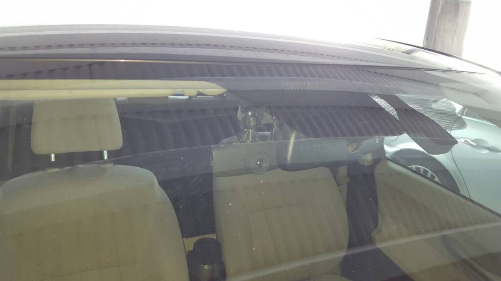

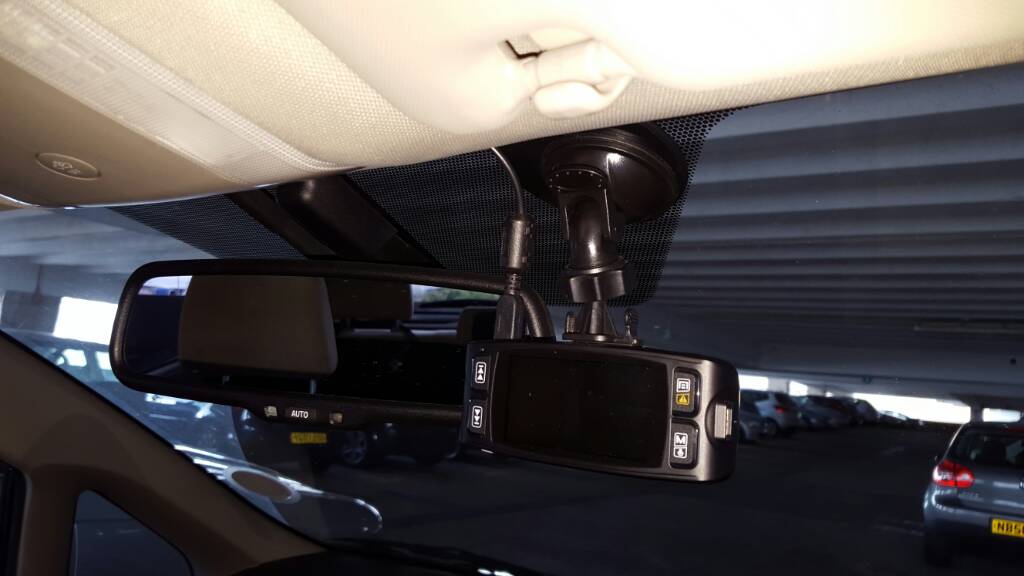

Sorry for the delay, I missed your question... Here are some pics:
I didn't paint the inside.. Didn't feel the need to...
And I run the cable to left along the roof lining down to the inside of passengers airbag panel.
Comes down and I zipped tied it to another loom... You can just make out the cigarette lighter plug at bottom of pic.
I unscrewed the metal spring loaded end of the socket that houses the fuse. Split the plastic plug and soldered in another wire... This you can see going to cigarette lighter wires. Where I spliced into them. . Sorry I don't have any pics of the soldering part.
The matt paint really kills the shine....
It's there if you go look for it.. But it does hide away fairly well...
