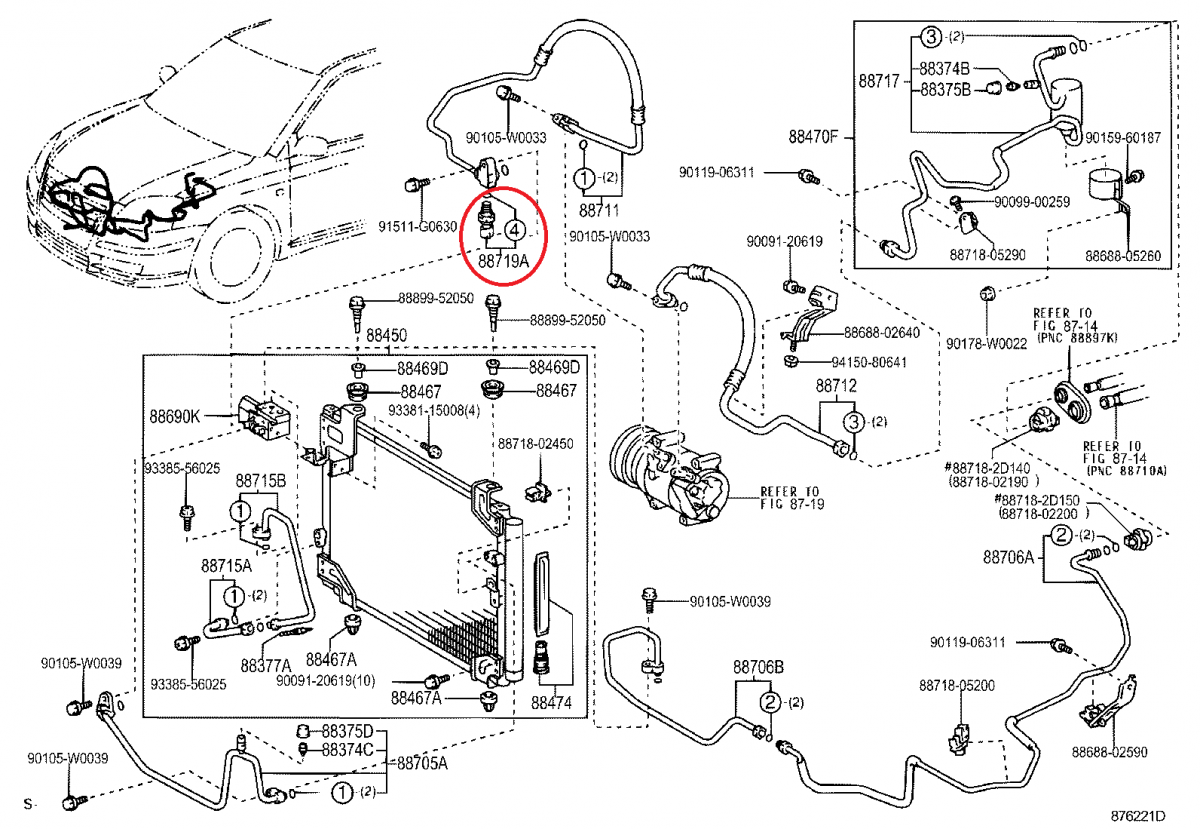

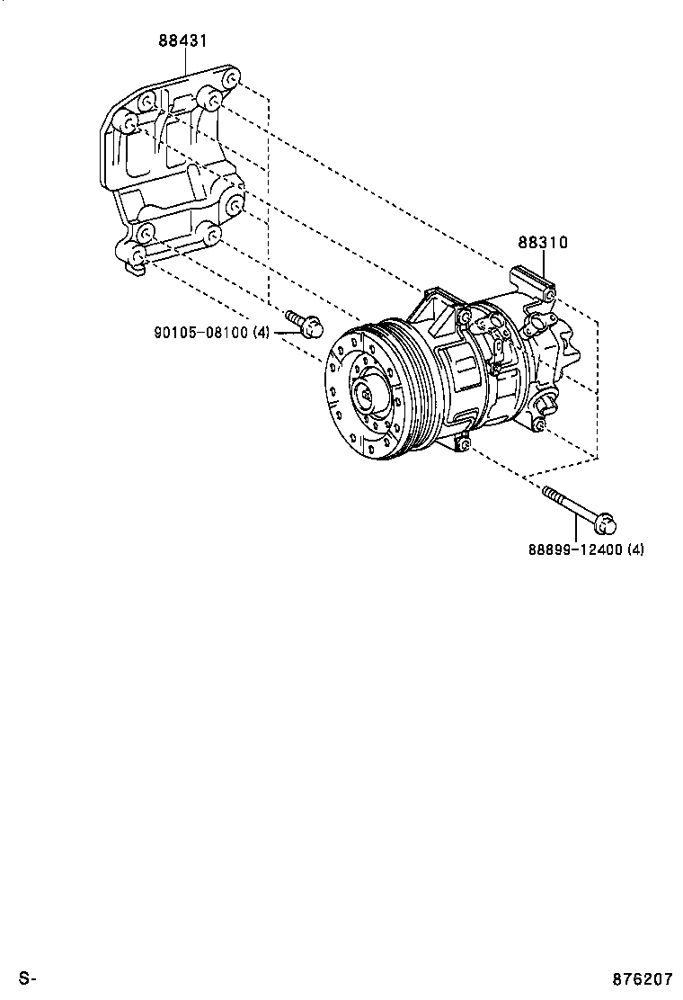

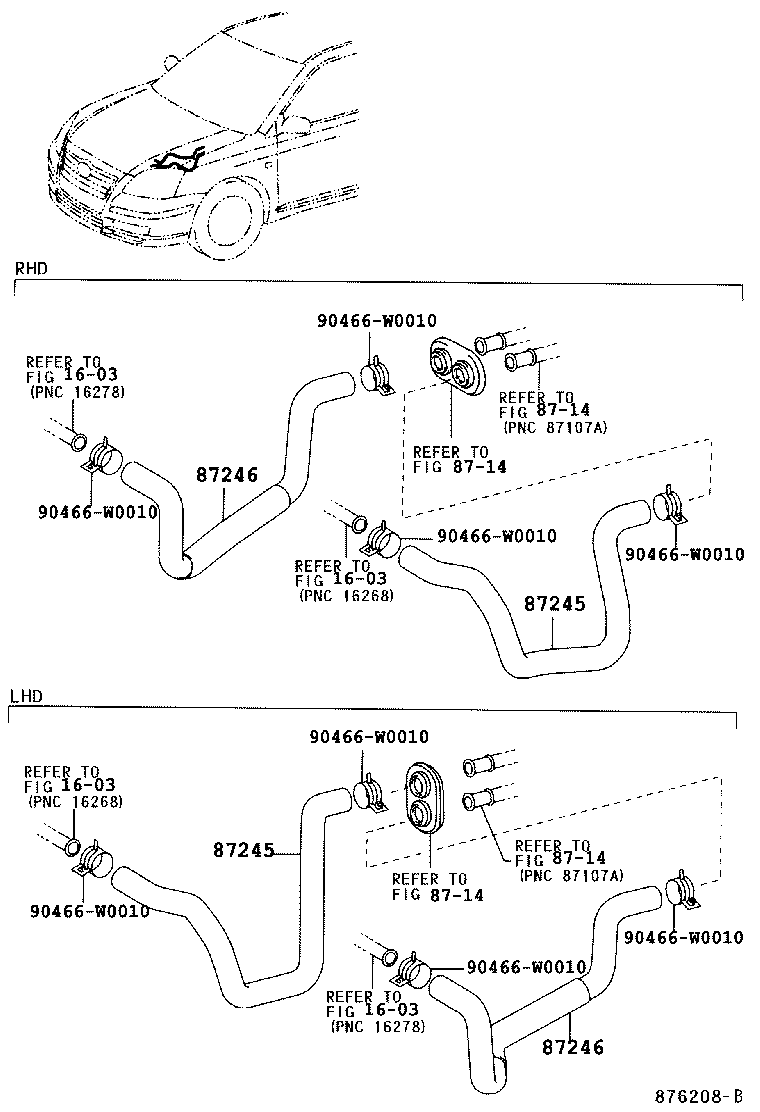

I cannot help directly but seen as you have no help yet(someone should come around) I will upload the workshop manual for the aircon later see if that's any help. as far as I know they are sealed units.
I have attached some diagrams if needed in the future just in case its not the compressor.
post-125194-0-87465100-1404470648_thumb.
post-125194-0-12373800-1404470657_thumb.
post-125194-0-40442500-1404470666_thumb.
