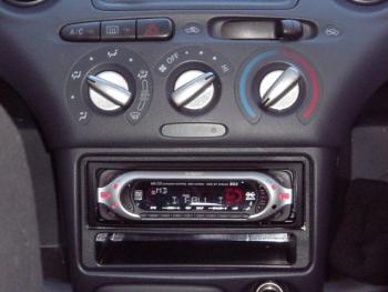

This is what iv got right now!
Looks better, sounds better and is more punchier! But looks stupid with two cdplayers!

off topic slightly, but did those silver dials come as standard (heater controls etc)?
The dials you see as far as i know were fitted when i bought it although the flash from the camera might have emphasised them a bit.

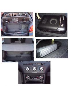

Hopefully if this works here are the pics.............nothing special but it sounds ok for now.
TS comes std with silver knobs
