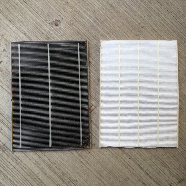

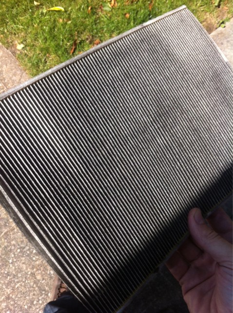

I've done it. I took all the crap out of it. I take it that it should be white?! post-100797-140775487923_thumb.jpg
Ah yes, that proves a very good point.
Will get on the ol bay of e and see what I can find one for.
TBH yours ain't that bad, you can still see white bits! :lol:
The proper Toyota filters have a static charge so they attract a lot more dirt; I change mine every 2 years and by the 2nd year it looks like iQ-Chris' one - almost totally black - but with bits of dead wasp/leaves/twigs etc. (How do they get in there!?)!!
