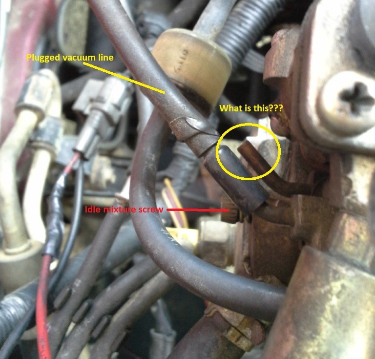

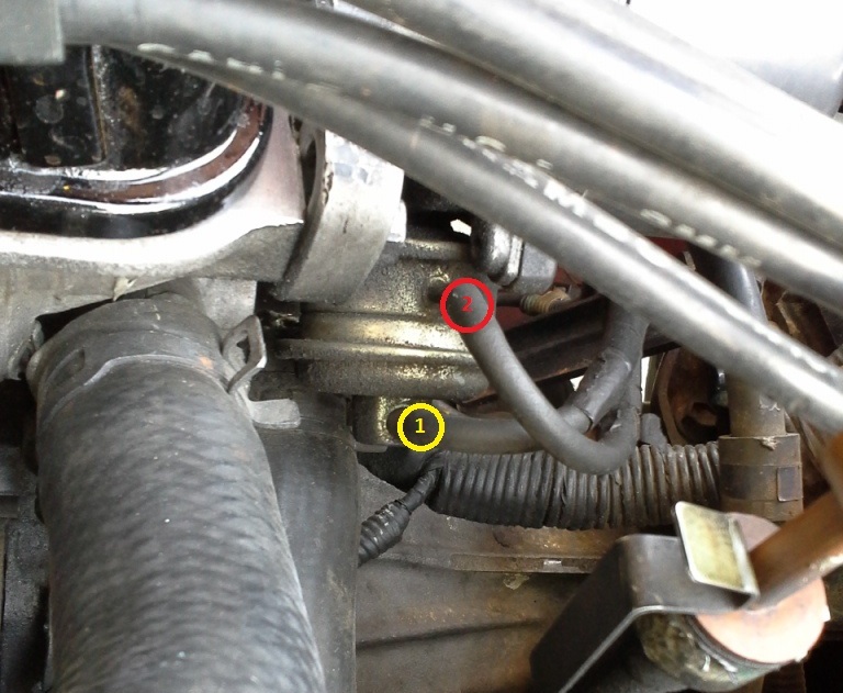

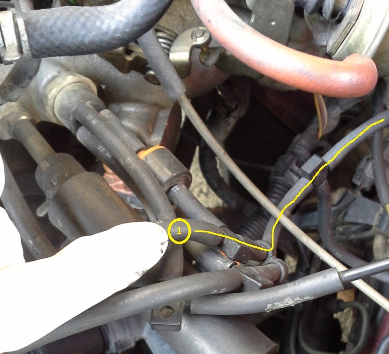

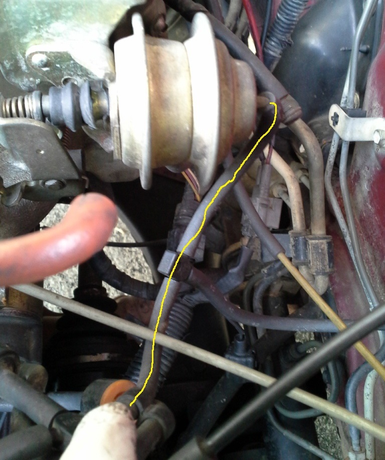

I have some questions regarding my corolla 93 model (2E engine) 1300cc 12Valve using Aisan carburetor. I am not sure if the connection of the vacuum advance and !Removed! hoses are correct (see attached pics).

My primary concern is the fuel consumption at the moment. I am suspecting that the vacuum hoses for the advance and !Removed! are wrong and also on the pic, there are 2 vacuum ports just on top of the idle mixture screw that 1 is plugged and the other is left unplugged. I tried to plugged the unplugged vacuum port and noticed that my fuel consumption became higher.

Good day did you  get you questions  answered? The plugged  line should be going  to the distributor  vacuum advance.
