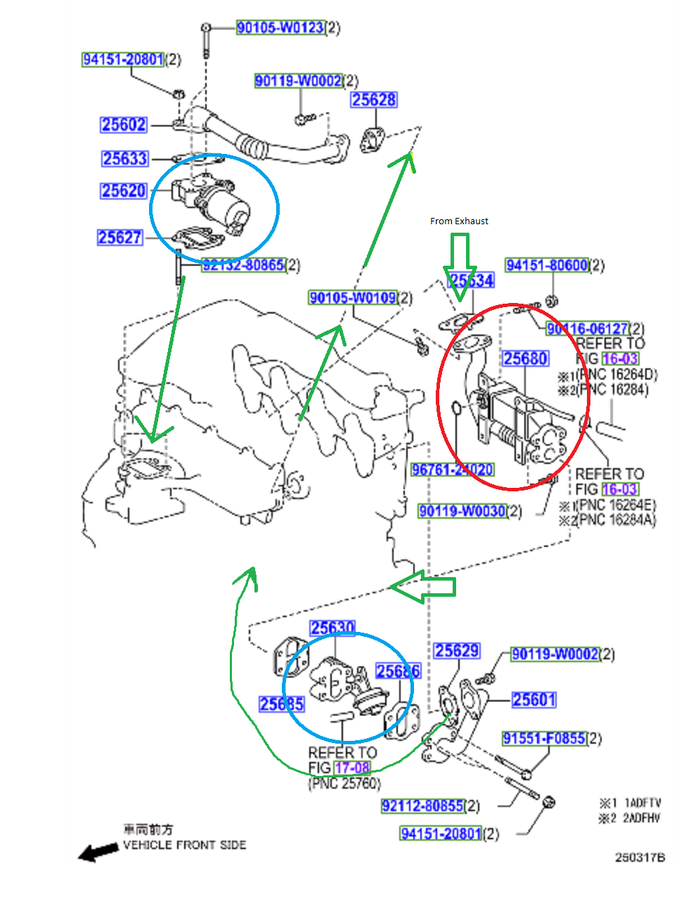

My auris 08 d4d 2.2sr has got the code po400, ive changed the egr valve n had it carbon cleaned but after about 30/40 miles engine management light came on,, what do I do?
I've driven diesel cars for the last 25 years and once they put the egr onto the engine everyone of my cars has had some sort of a problem with the egr, I've found that putting the car in for a service every year and asking that they clean the egr and the maf this has always helped and I've never been troubled with any codes coming up ,make sure you clean the plug as well as this can sometimes get dirty connections and cause codes to appear, I don't personally clean the egr but it's not difficult I'm disabled now and can't do work on the car but I do watch and ask questIons , plus it helps if you can't do it yourself to have a good mechanic, watch Scotty Kilmer on you tube and he shows how to clean and look after the egr plus he loves Toyota cars
P0400 is not specifically a faulty EGR its a code set when Exhaust gas flow is restricted and sets when the EGR system gets blocked, there is however more than just an EGR valve and if the one valve is clear there is another valve, pipes and a cooler any of which could be blocked.
See the pic attached Blue are EGR valves, Red is the EGR Cooler and green is the gas routeCapture.thumb.PNG.3519eb2f74a6656247b9f6e7a029db7c.PNG
