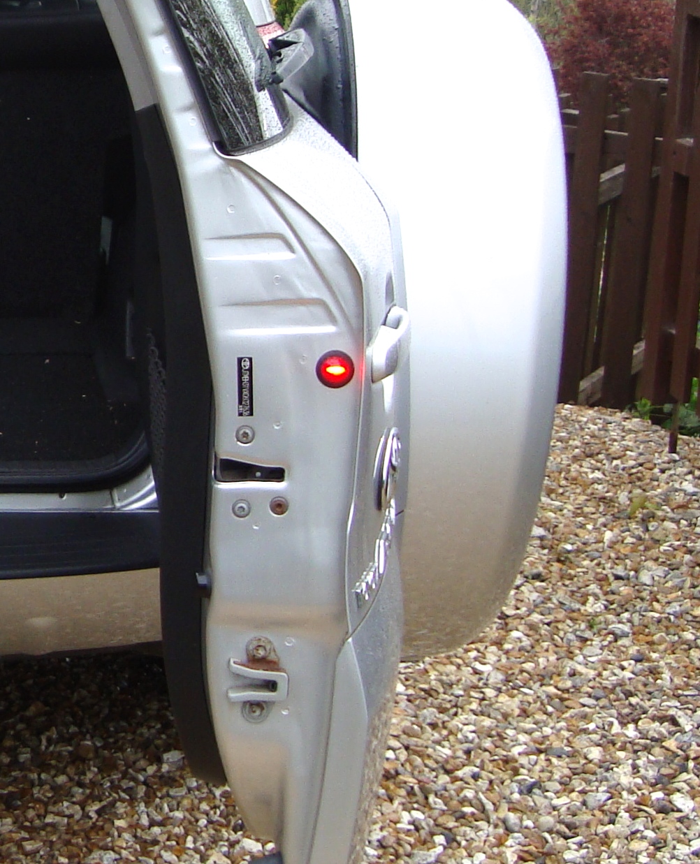

If that worries you, you could always get your soldering iron out and fit a rear light to the inside of the door. Never ceases to amaze me how manufacturers would rather allow legislation to make life awkward for customers rather than actually find ways ways to work around/with it.
I think that the nightmare scenario would be door open at night , cyclist crashes into it as they didn't see the obscured light, no win no fee lawyer takes on the case, insurance co refuses to pay out because of illegal mod .
I don't think that the conversion is a big deal and is very unlikely to get you into bother. Many have fitted a red light or reflective strip on the door edge. The picture shows a superbright red LED which is simply wired to the door switch - a very easy installation with no drilling on the 4.3 - a bit more difficult on the 4.2.
