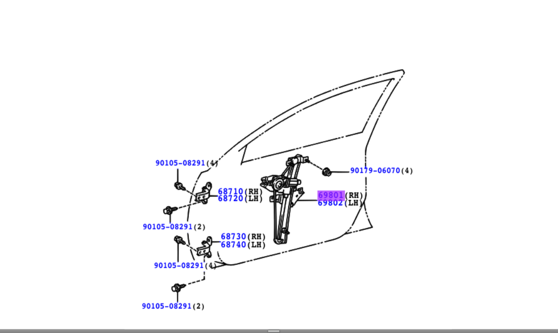

Part is a complete unit only I'm afraid, you will need part number 69810-05041.
post-45863-0-42743500-1410637705_thumb.p
Many thanks Lee. Bugger - a complete unit to replace a broken cable! Grateful for the info; the Thumbnail highlight is 69801 - so is 69810 a typo? and what's 05041, please?
Best,
D.
Best,
D.
69801 is what Toyota call a PNC ( Part name code ) experienced parts people memorise these PNC then when they need to locate a part on a catalogue they input the PNC and jump straight to it.
All Toyota part numbers are 10-12 digits long with numbers 11 & 12 being colour or trim variations. 69810 = RHF, RHD and 05041 is the specific part for a 1997-2003 mk1 Avensis. 69810-05041 is the whole part number
