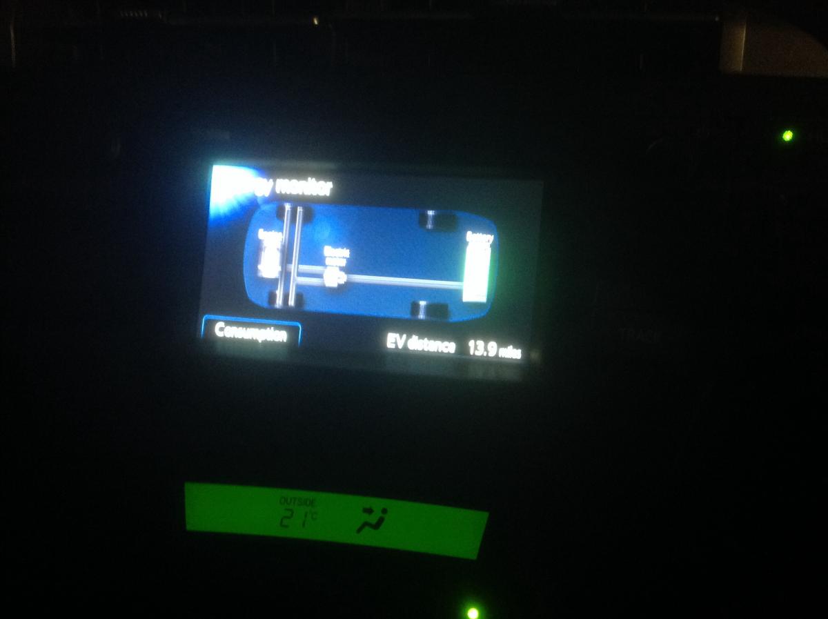

I am on my second Prius and have had a plug in for a year now getting any where from 9.5 miles in the winter to about 11.5 in the summer.this weekend I left door opened in garage for 3 days and drained the Battery (interior light on).today I jump started it which worked ok took it ride to charge Battery. I was surprised to see the range has gone up to 13.5 miles ! Strange because the traction Battery is separate from car battery? Anyone else heard of this?

You may possibly find its due to resetting the cars ECU's etc and it was based upon a default preset and not your previous driving history.
Jonathan thanks for reply but I never had any where near that when I first charged it from new..I'm sure it was about 11.4 miles
But from new it'll still have had some use stored within the cars computers during delivery etc, and I tend to find an 11.8 mile indicated range tends to be about 13.5 actual miles.
As timberwolf has said, it'll be interesting to see how accurate it is, and if it changes with a few days of use or not.
Had 2 miles on clock when pick it up new ..will check it in next few days to see if any change in true miles..

From posts over on one of the mainly US forums, 13.5 is definitely the default preset, and it has gone back to that because the 12 v was drained. The reason you may never have noticed it might be that you always started the car in the early weeks with the blower on - that will knock 10% off the estimated range.
