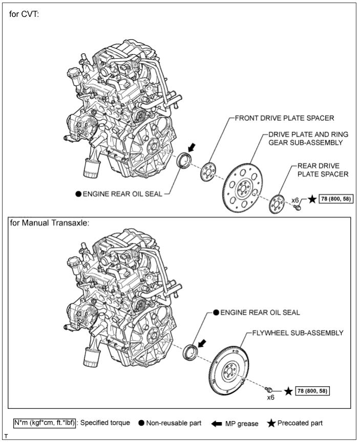

According to the manual I have here the 1.0 engines have a simple, solid flywheel for the manual models. CVT's come with a torque converter and flex plate.

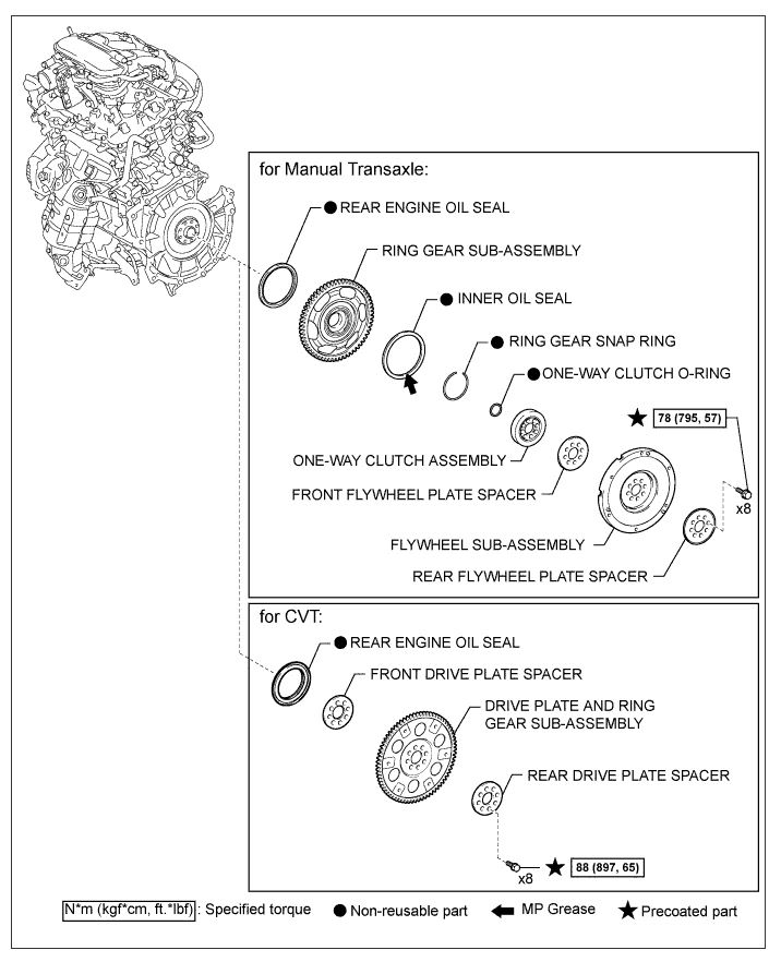

Odd thing is the 1.3 version are more complicated with a one way clutch assembly in them. Anyone have an idea what that is for?

post-116364-0-40356400-1412838912_thumb.
post-116364-0-33133400-1412839024_thumb.
According to google/youtube the one way clutch.provides drive in one rotational direction but not in the other. Stating, provides drive but no engine braking
David
That was my first thoughts but my engine certainly does provide engine braking.
Looking again at it I'm wondering if the one way bearing is on the starter ring only. Maybe for the stop start system the starter motor is constantly engaged to reduce the wear you get on the starter ring each time the starter gear engages on a conventional type starter.
Once the starter has started the car maybe the starter ring remains stationary on the one way bearing and the starter motor is always engaged ready to go again when needed.
Craig.
Craig.
You've answered your own question, the 1.33 has stop start with a constantly engaged starter motor.
