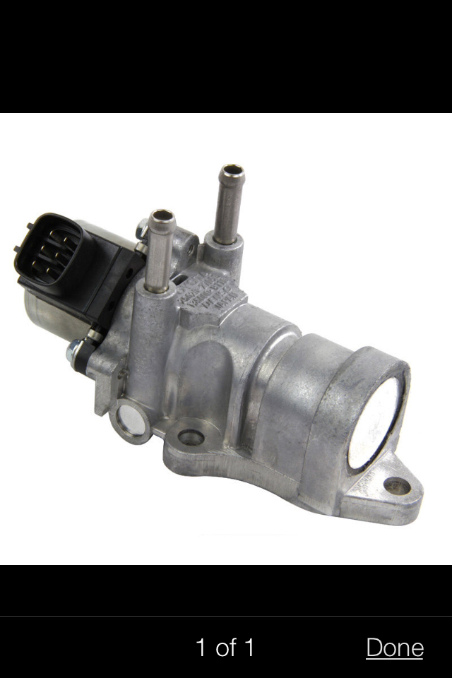

Have you checked the EGR valve. I had same prob., I put on a new one , no probs., since then.post-131343-141431217283_thumb.jpg
Sent from my iPhone using Toyota OC
Yeah, I've remover the EGR and cleaned it out completely. The solonoid wasn't sticking but there was a little carbon build up. I may end up blanking it altogether
The only other that comes to mind .i had limp mode prob , took to Mr T & they said its was an injector prob so I changed the no1 injector which was causing the problem. It was fine after that . That was at 100k, now the car has done 176k now . Just the EGR I mentioned earlier .

Does it happen before or after the thermostat opens, on my car it was after and it was the EGR valve . Before it will be the injector . In my opinion . Take to Mr T and let them check it , it cost about £40 but will know what causing your problem.
