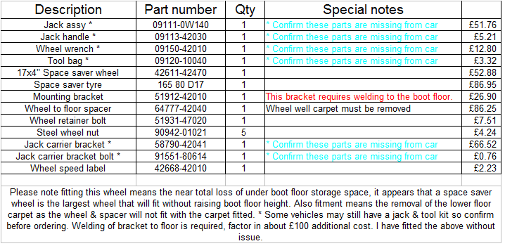

Unfortunately Toyota don't offer an official kit to fit a space saver wheel under the rear floor, they do offer a fill sized option but that sits inside the boot and straps to the floor.
I have through trial and error came up with a list of parts that can be fitted that allows a space saver wheel to fit in a new RAV 4.4 that was not factory fitted with a spare wheel
post-45863-0-77672700-1415819433_thumb.p
