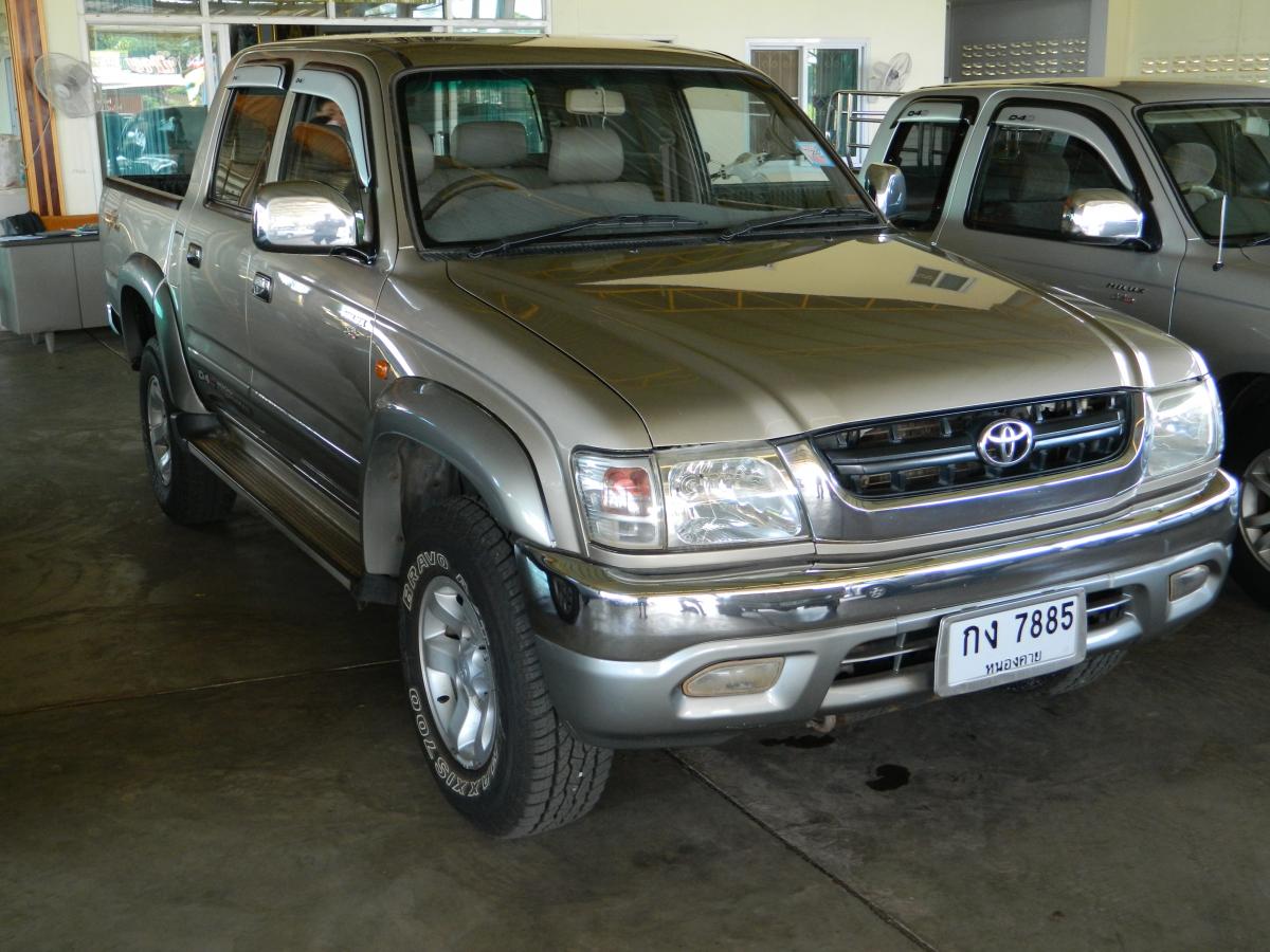

Can anyone shed some light on poor cold starting of a 2002 Toyota Hilux with the D4D engine. I live out here in Thailand and "cold" starts are around 24 degrees C.
I am not sure if the injectors could be leaking overnight as the engine seems to kick back as if it is hydraulicing. The engine feels like it is trying to jump out of the engine bay. I am no diesel expert so don't know to what temperatures the glow plugs will work and as I am sure new injectors will be expensive don't want to guess the problem. Warm starts are fine.

I was hoping to check the glow plugs myself but they are buried so I took the pickup to our local workshop. The guys dismantled the necessary parts to gain access to the glow plugs and removed them to check. All four worked but the tips were all heavily carboned up. The owner of the workshop said this is probably the reason. They cleaned the glow plugs and rebuilt everything. This morning my pickup started a treat.
The guys also found carbon build up in a cylindrical component, so much so it was blocked. It was made of steel and I am guessing it was to do with exhaust gas recirculation. Whatever it was has made a significant difference to performance, my Hilux is now very lively on the road. We have a small step up to our driveway, about 3 inches, yesterday the pickup lit up the rear wheels in an effort to climb this and it has never wheelspun like that before.
