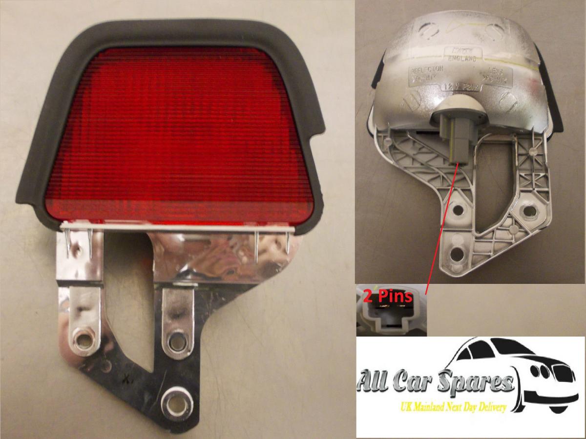

My dads 08 TR estate has a failed high level brake light. Was yours the estate, how did you get to the light can you advise please? Is it a sealed LED unit or are there bulbs that can be replaced?

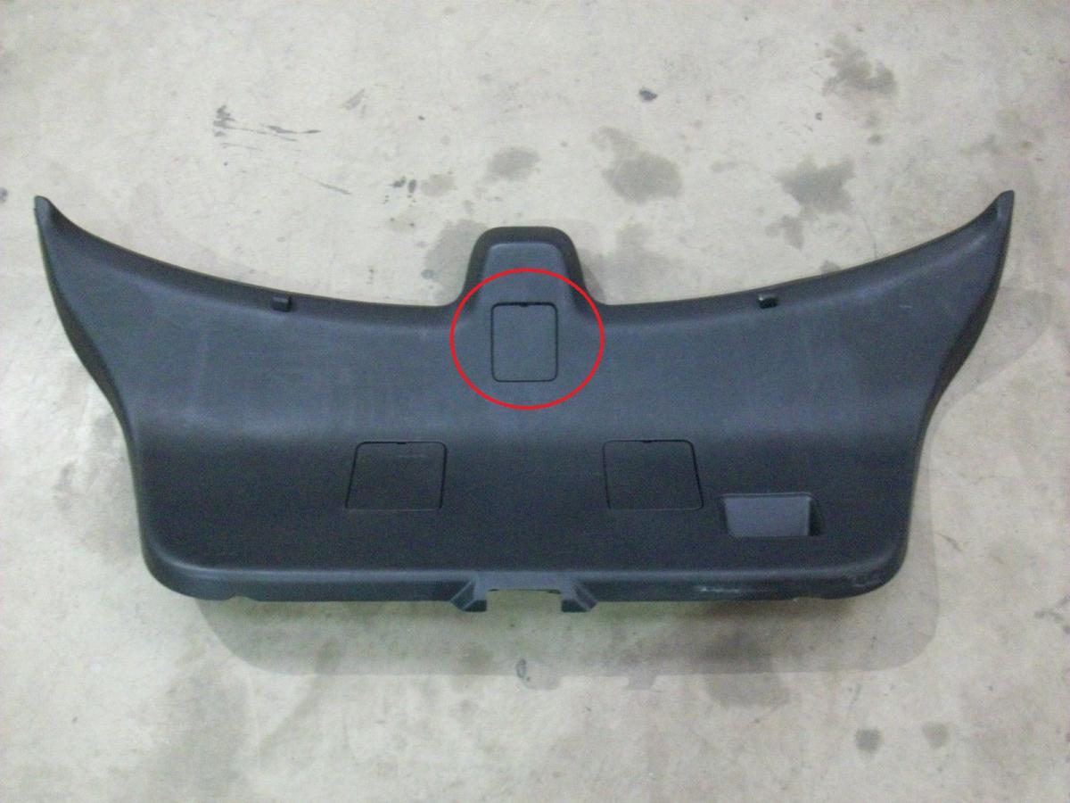

this might not help but hopefully it may be similar.
On my hatchback I open the tailgate and pop off the plastic access hole and twist the bulb holder and then I can access to change the bulb, pictures will give you a little understanding.
Same for the mk1 Avensis.
