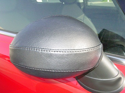

There was a earlier post about wind noise caused by the wing mirror.
I advise the poster to wrap clingfilm around the mirror and do a test.
If you get no noise you have found the cause.
If noise is still present you have ruled out the wing mirror.
