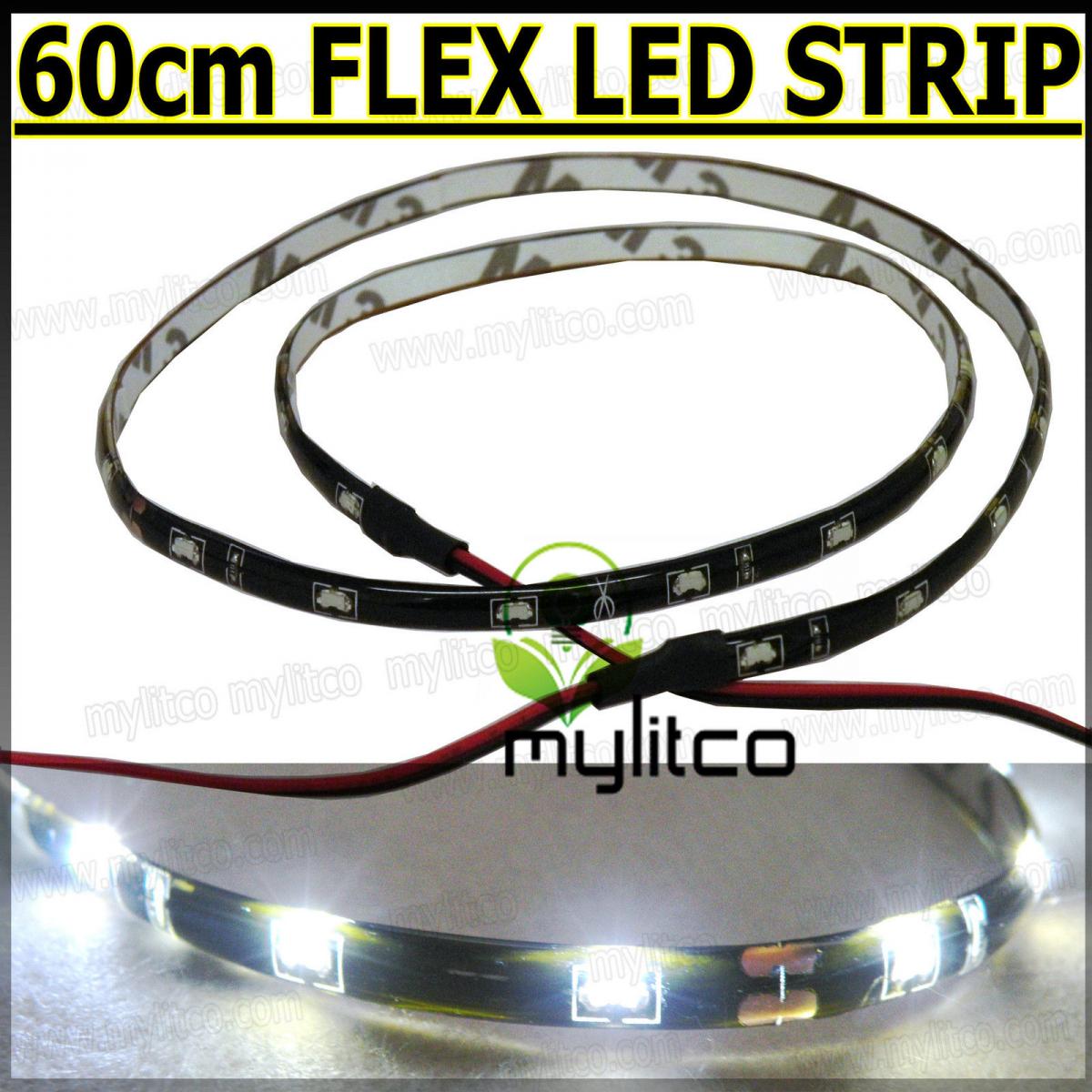

right am thinking of putting extra light inside like these led strip lights in the footwell but where do get the power from some where near the centre console like the cig light. and using scotch lock to cut in the wire. really want them come on with doors opening, any advice please.post-143429-0-05704700-1420657760_thumb.

or could i take a wire off the interior light or would blow the fuse. just want something cheap and easy to install am no electrician!
I have a small led torch velcro'd to the grab handle above the driver door , does it for me and lasts ages
there some interior lights for the footwell in a blue tint that plug in to the 12v adapter and have a on off switch. on eBay might go for one of them. only £5.00
As Craig says. You can use any 12v LED strip and connect to the position 14 in the Toyota installation guide. You can connect to the internal light via the roof lining on two particular connection points but you have to be careful
