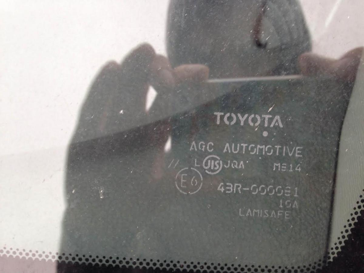

I need to replace my windshield, I was given a price inquiry but it seems to be quite low. They want 500EUR to do the whole thing. However, an acoustic glass costs here 450EUR, so I'm getting nervous if they want to rip me off with some very noname windshield. It's not really my car, so I do not know the details of the current damaged glass. Can you help me to find out if it is acoustic glass as well? What I know that it is heated and I have rain sensor as well.
This is the photo of the windshield code:
post-146074-0-14660600-1421967541_thumb.
OK, I don't think this is acoustic glass. Toyota obviously is the manufacturer of the car. AGC is the manufacturer of the glass and a quality one at that. The // indicates "Regular Multiple Layer Windshield", the JIS means it meets the Japanese Industrial Standards, and the E6 indicates the glass is approved for Belgium. The 43R is the regulation number and the 000081 is the approval number. M814 is the model number of the windshield, and finally, Lamisafe is the trademark name of the glass. I found all this by Googling various sites.
