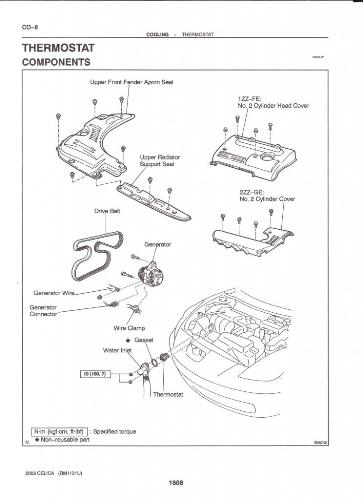

ps...thermostat "hides" behind alternator.
post-141750-0-68478700-1422442037_thumb.
