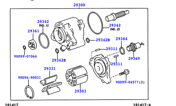

Are you fitting a new or used vacuum pump? If used it probably needs an over haul with new blades and seals

Hi, after some diagnosis it appears the vac pump has had it. Does anybody know where I can get one new or reconditioned so we know it's working that doesn't cost the earth?
Any help very much appreciated.
Or actually anyone who can recondition the one I have. Cheers
