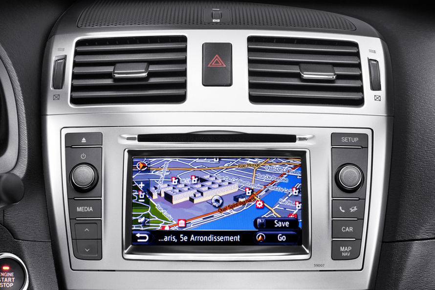

i am a diehard toyota fan and i have just bought a 2012 avensis luna. on the way home from the dealer and tried the satnav. got error msg. service not available.... called dealer and was told that even though its luna model with reversing camera ect not all luna models have satnav. he said he can fit it but will cost 1200 euro. i was wondering is there any other way around this as the hardware is there i just need the software.

good idea.. i just been out and tried to identify it. couldnt really find a model no. just that its a touch screen with the numbers 59006 printed on bottom right corner.
I Suspect you have Toyota touch installed, to add sat nav you do need some hardware by way of a sat nav kit (docs attached,) you will have the choice of "Go" or the more expensive "Go+" navigation

sounds good.. and yes i believe i do have the toyota touch system. can these nav kits be bought online and diy fitted or is it a dealer only thing. cheers for all the help also.
Luna is a RoI trim so we won't be too familiar with what it comes with. I think that as D.A. says that no. is a Touch non-Go unit. The extra hardware extension unit iirc for Go is ~£600 & then you need to add fitting & the gps aerial. http://www.ebay.co.uk/itm/Genuine-Toyota-Touch-And-Go-Sat-Nav-Unit-PZ490-00331-D0-/360844668906?pt=LH_DefaultDomain_3&hash=item540404afea
Think about spending £150 on a Garmin/Tomtom with "lifetime" free updates instead (Toyota map updates are ~£150).

your looking at the kit with the gps antenna different wiring looms and a module of some sort probably with the maps on it.
