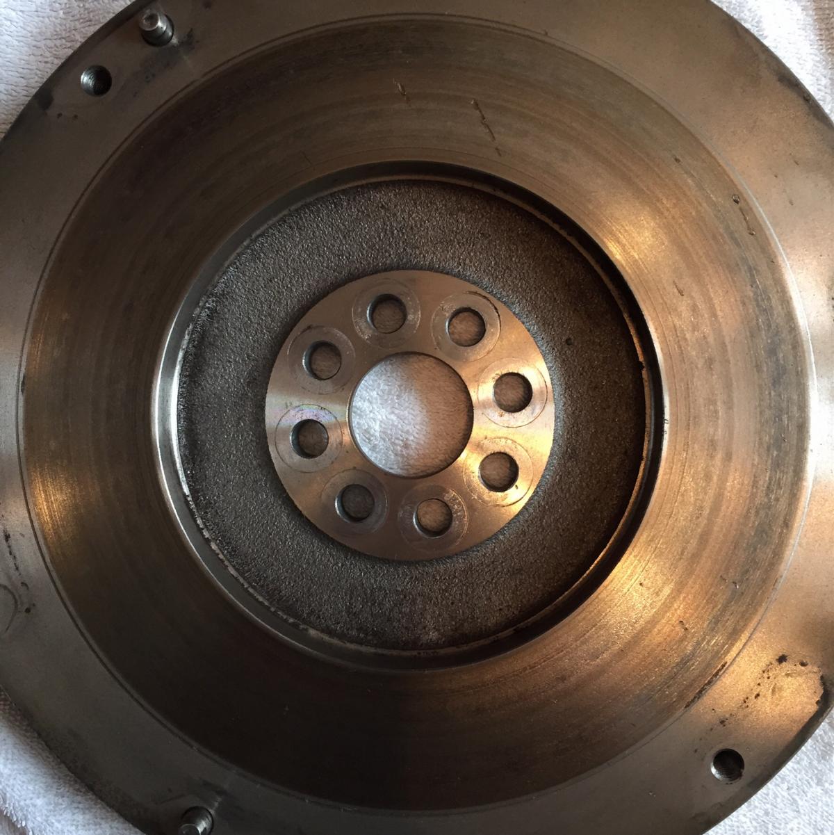

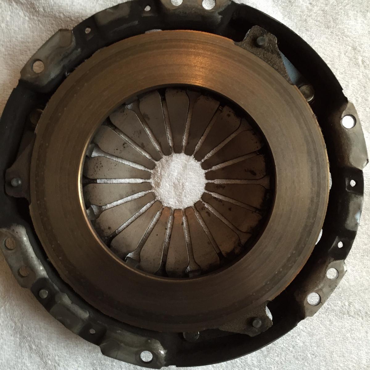

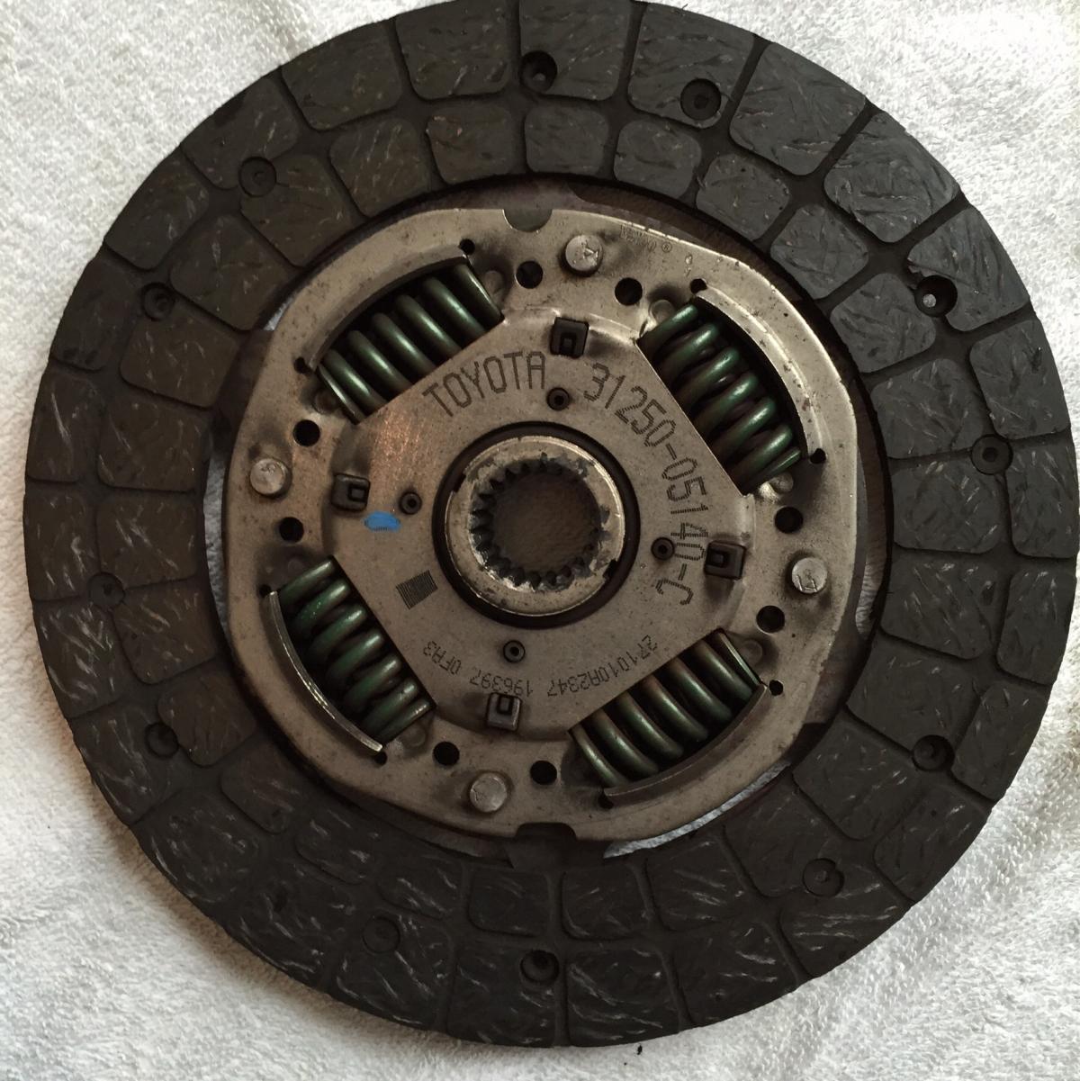

I am attaching pics of the flywheel and plates, the original machine marks are still visible, along with an odd band of high spots.

Hard to tell from pic but clutch still looks if it has a bit of meat left on it.
Is the other side worn to the rivets or worn down to the grooves?
Hard to see pics from phone just now
I see heat / slip damage to flywheel and pressure plate but if friction plate still has plenty of meat left on it then id say it isnt getting clamped enough and isnt slipping due to excess wear but rather a physical contact issue.

Friction plate not yet down to rivets yet, but getting near.
Slave was csc.
Wear patern looks odd to me, not even across the flywheel and pressure plate, but the hard spot lines are the same position on both.

No answer as to why the hard spots are in a narrow band on both flywheel and pressure plate, or why no wear on original machine marking on them.
