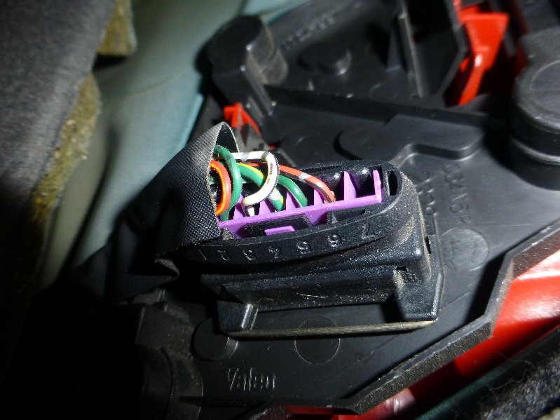

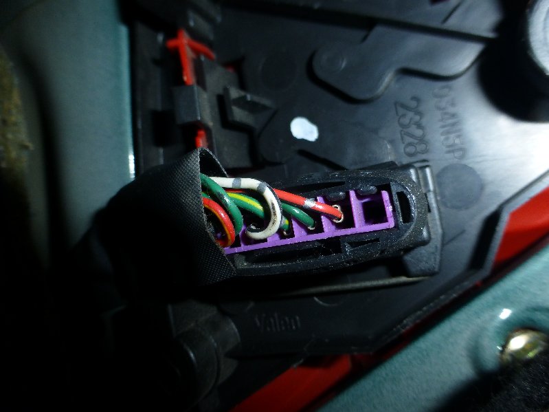

:blushing:Hi folks just wondering fitting the reverse sensors which wire do I connect to get the power feed from reverse light regards Meloned
ps I have looked on the site and it seems the red one on top but just want to double check
post-102607-0-57654800-1425822205_thumb.
Yes you are correct. Reverse is red/black and earth is white/black.
The Haynes manual has the wiring diagrams which is fairly accurate.
Thanks this is a 2007 t25 model this is correct for this model then as it does not have a Haynes manual for it regards Meloned .

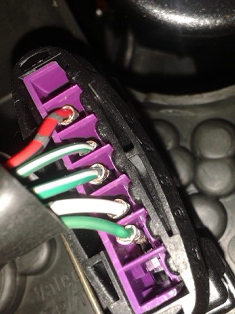

Thanks gazza. I've seen the flaps so will try that. Doesn't look like any other way to get the cables through near enough to the reverse light cluster. Here's a test for you, which I'm struggling with. From the diagram/photo above, is the earth cable the white one. I've got the same setup and tested with a voltmeter. I get readings on all the cables when testing and keeping the red from voltmeter to red on cluster and moving black from voltmeter to any of the other wires. Appreciate the help.
Yes the white wire (with black line) is earth. It's the same colour for all toyotas.
Confirming an earth isn't via the voltmeter option on a multimeter. It's done using the 'curcuit' option. Connect one probe to a bolt to the body Shell. The other probe to a wire suspected of being an earth. If you're right the needle swings or you get a tone. If you're wrong - no response. (for that light cluster, the bulbs would need to be removed)
