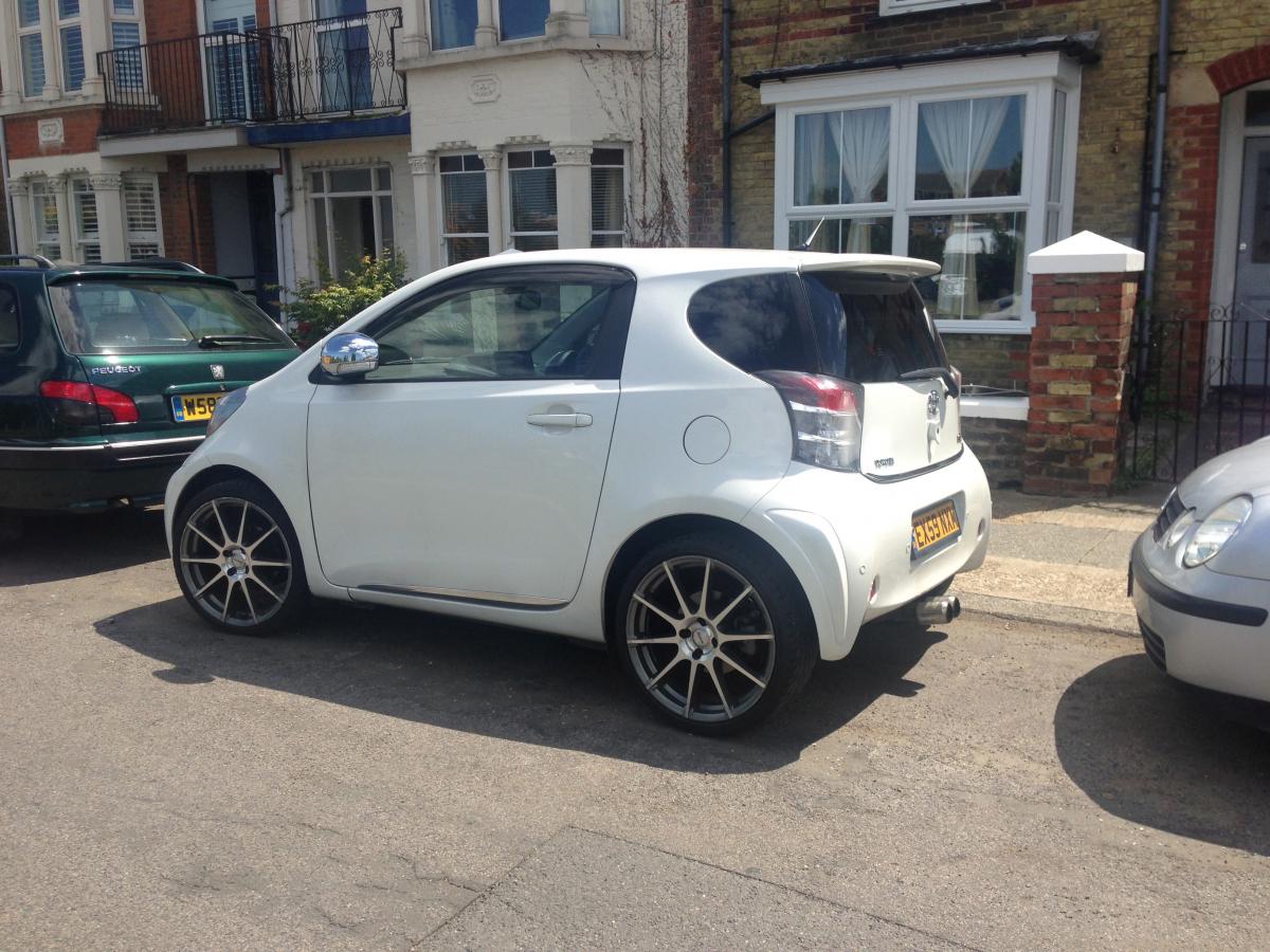

I have a white 59 plate lowered using Toyota's own kit. I have 18 X215x35 fitted for about 3yrs now. They dont foul as such but do stick out at the front about 15mm and are almost to the edge of the body at the rear in depth there is about 60/70mm gap in height to the body frint and rear
What looks fantastic is spoked type wheels i have 8 will post a pic soon
David
Hi David - they do indeed look great. Do you happen to know the ET or offset of your rims? Also - how close to the suspension components do they come? I'm looking at a slightly higher than usual offset (40) to try to minimise the amount they poke out. Risk is they foul the suspension.
Matt
No i dont know. The company that supplied them also built the custom exhaust ( you can see the double barrel down pipe in the pic. I looked on their site yesterday and chose 17 x 205 x40. Then chose the car iQ and it came back with an offset of 38. There are quite a few people on here that know lots about tyres. Far more than i do. They did say at the wheel company that they were the biggest i could have on there but i have seen a 19inch on one
David
