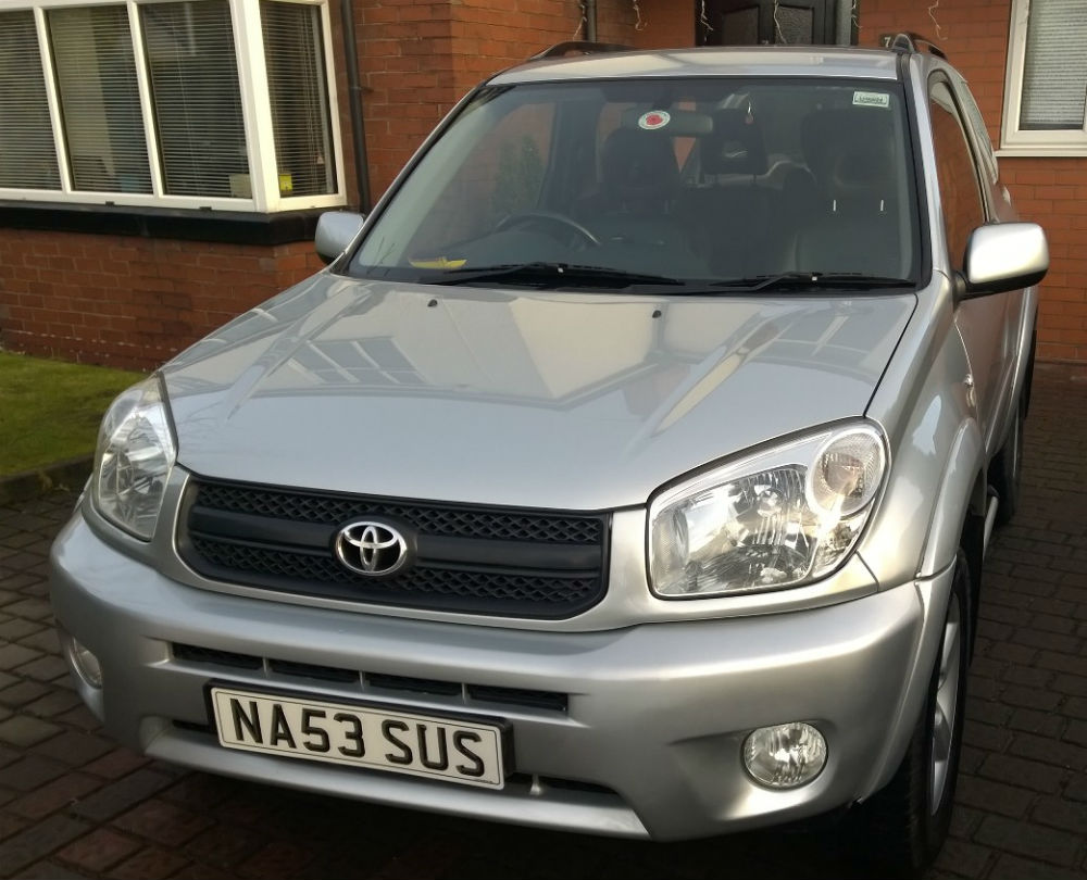

Welcome Graeme. Given your reg/model year, I suspect that it could be a late 4.1 or an early 4.2. It would help if you would go into your profile & fill in your car's details. MMeanwhile, does your car look like this?
post-49435-0-04869500-1426843222_thumb.j
If so, it's a 4.2.

I've updated my details as you requested and I can confirm it is a 4.2 as in the picture.
