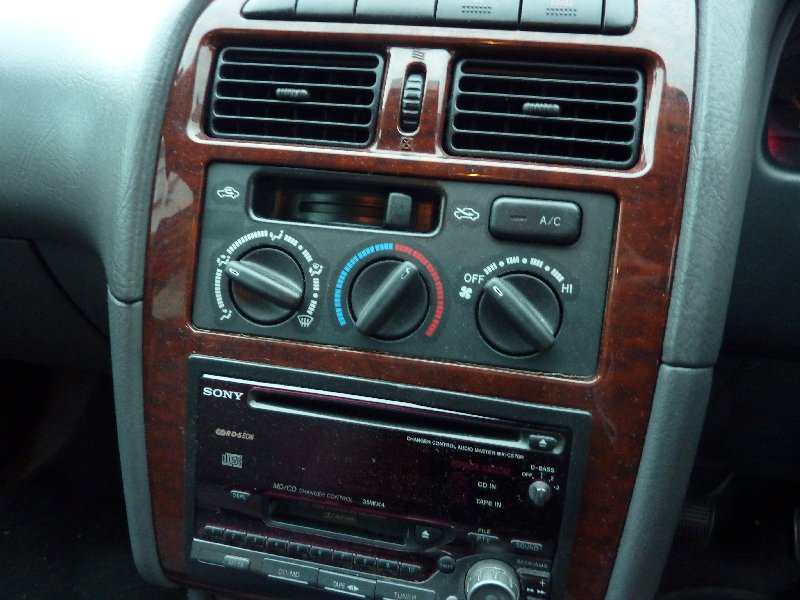

Now my problem is how to remove the (nice for it's day) Sony double din CD Radio Cassette player without damaging the dash or stereo!

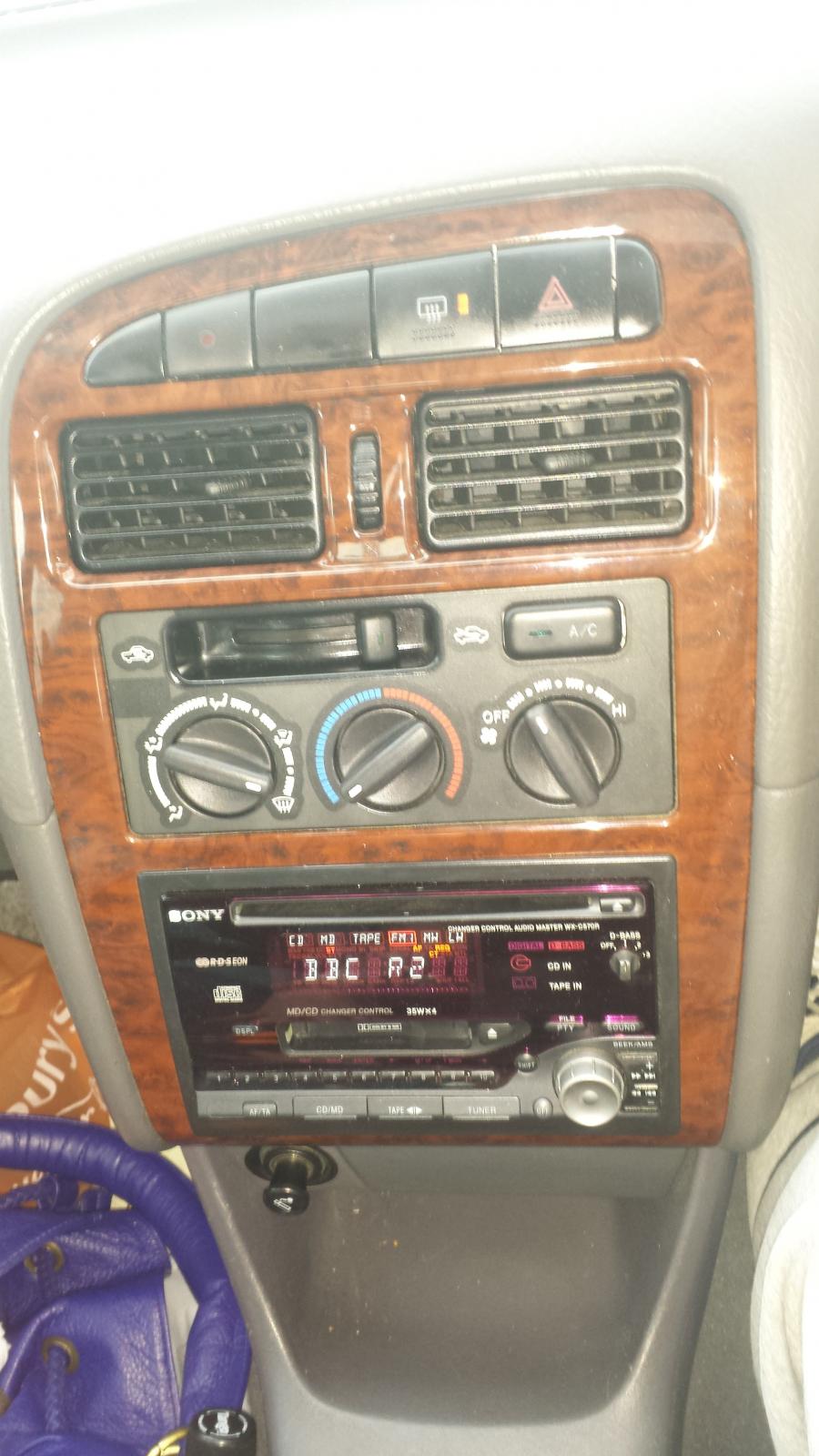

I have posted a picture of the dash in my Avensis so you guys will know which bits I need to remove.......

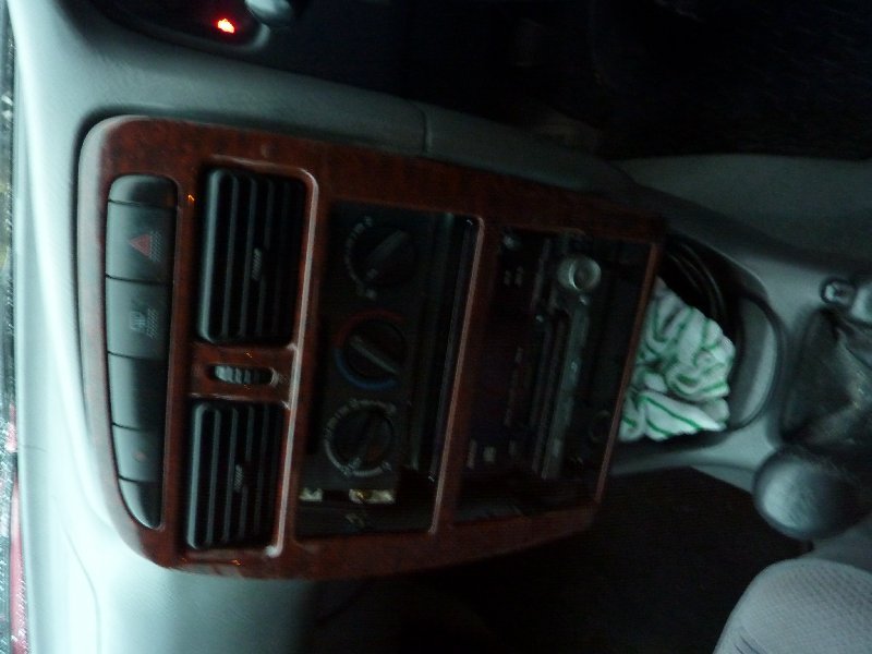

Those ones are just clipped in as I recall. Pull towards you at the bottom corners. Then gently ease it around the head unit and heater controls to the point where you can get your finger tips either side of the facia beneath the vents. Jiggling left/right will then free the upper clips near the switch assembly. The wiring behind the upper switches is long enough to allow you to rest the entire facia on the dash without the need to disconnect any of the loom.

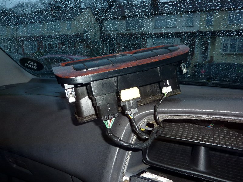

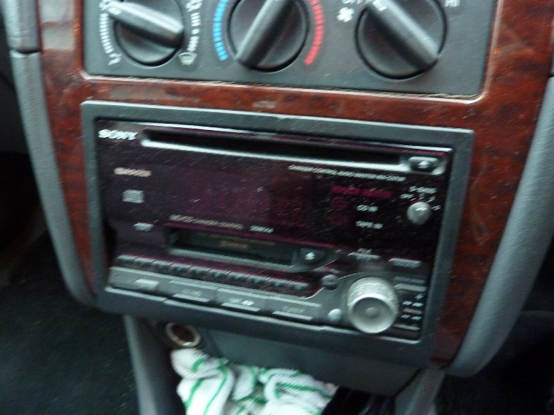

Now to remove the stereo, first remove the black surround of the Sony, then pull the false wood facia, from the bottom, just above the ash tray. Tilt up and pull the facia away. This will included the vents and the switches. Disconnect from behind the switches to completely remove the facia.

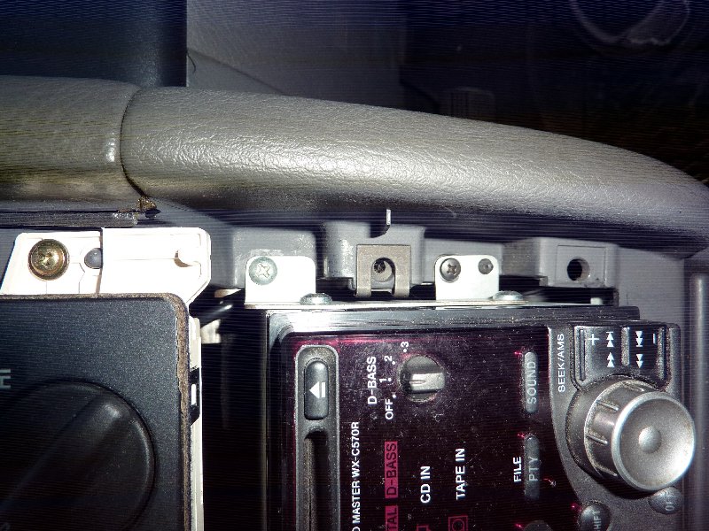

You need a Philips screwdriver to remove the Sony from the dashboard. Then unscrew the brackets from the stereo to be used on the new head unit.

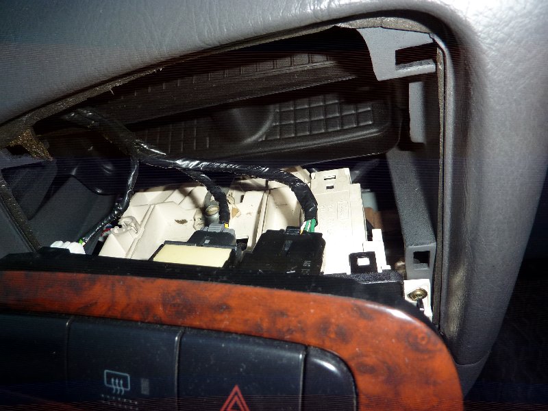

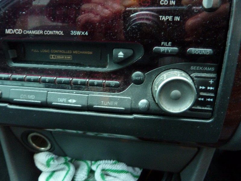

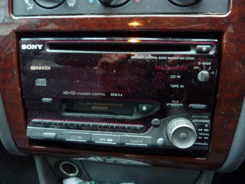

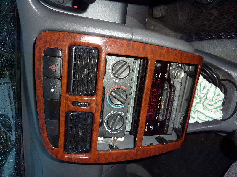

I quickly grabbed a camera and took photos.

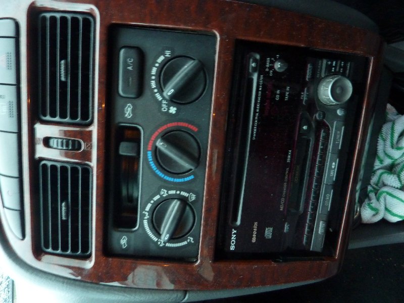

post-76861-0-12327800-1428085445_thumb.j Pull off the stereo surround post-76861-0-71189400-1428085466_thumb.j
post-76861-0-32207600-1428085476_thumb.j Pull the fake wood facia from the below the stereo post-76861-0-08692100-1428085487_thumb.j
post-76861-0-93128200-1428086339_thumb.j lift the facia awaypost-76861-0-81263900-1428086448_thumb.jpost-76861-0-52814400-1428086460_thumb.jpost-76861-0-18723900-1428085551_thumb.jThe switches can be disconnected post-76861-0-47081500-1428085567_thumb.j but I moved it to the top of the dashboard.

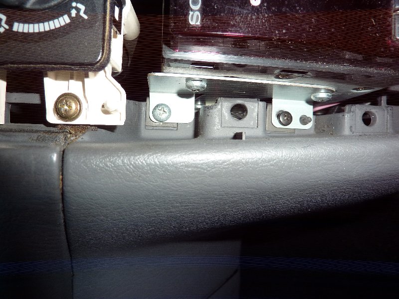

post-76861-0-11123900-1428086480_thumb.jpost-76861-0-09927200-1428086491_thumb.j There are 4 screws - 2 each side of the stereo brackets.
I think the brackets can be removed and transfered to the new stereo.
The universal cable you mentioned should work so plug and play.
Konrad
