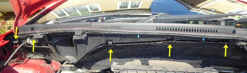

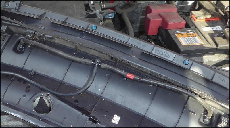

First, do not be side tracked by articles about how to access the Yaris washer motor or tank. Unless there are more than one non return valves then the one we need is under the top panel below the wipers......
Second I wish I'd marked the wipers' positions on the drive spindles because it would have made it easier to replace them. I had not done that so had to do it by trial and error and the soddin' things kept moving round when I turned on the ignition !
Next, here are where the clip are top remove the panel :
1797368959_Yarisscreenwasherrepairpanelremoval800WL10.thumb.jpg.f5ac6565934584f527c6d5066dc4d07d.jpg

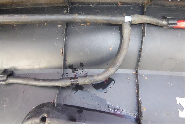

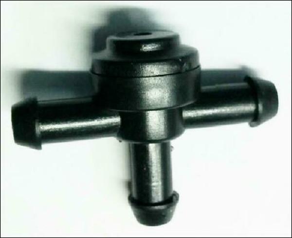

Next, the original Yaris one way valve is a combined valve and T piece :
1335259501_YarisscreenwasheroriginalcombinednonreturnvalveandTpiece2800WL10.thumb.jpg.79f37737ffb8c1c92a198aa4b9256305.jpg1025842659_ToyotaYariswashercombinedTpieceandnonreturnvalve600WL10.thumb.jpg.65f29612f86f4a38c1be44f69f955cc5.jpg
In order to save time (I'd hoped...) I had already been round Halfords and bought their one way valve but that will not do the job, at least not on its own, as the Yaris original type is a combined T piece / valve assby. On the day I did the job I phoned our local Toyota dealer to see if they had one one of the latter in stock and how much it was, they neglected to answer the phone (it'd probably have been really expensive anyway...) so I went back to Halfords (quite frustrating....) and bought a T piece, figuring I could then get the system to work. NOTE : the valve and T piece are 5mm types. :

Separate in line valve and T piece as used to replace the Yaris combined unit :
271560497_YarisscreenwasherrepairreplacementinlinevalveandseparateTpiece800WL10.thumb.jpg.aa3aa2e5faec51b6fb51130c8838a0ef.jpg
You may well have broken some of the clips when they were removed (or they were already broken). I had to replace the left hand clip assby (the unique round one that removes) with a nut and bolt, and I put a self tapper through to replace the middle three clips which had broken.

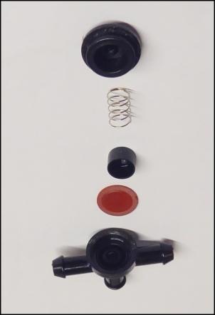

Was interested what was in one of those Yaris screenwash valves so stripped it down. Interestingly I could not find anything in it (like a foreign body) which would stop it working ! :
921994121_Yaris-combined-washer-T-piece-and-non-return-valve300W.thumb.jpg.9164d95064af021b6088b6f73fb8c43d.jpg
