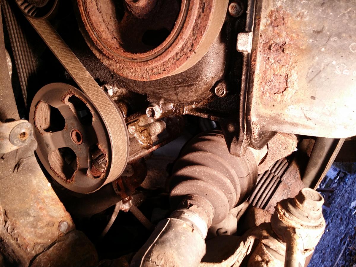

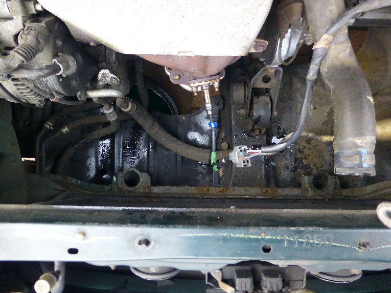

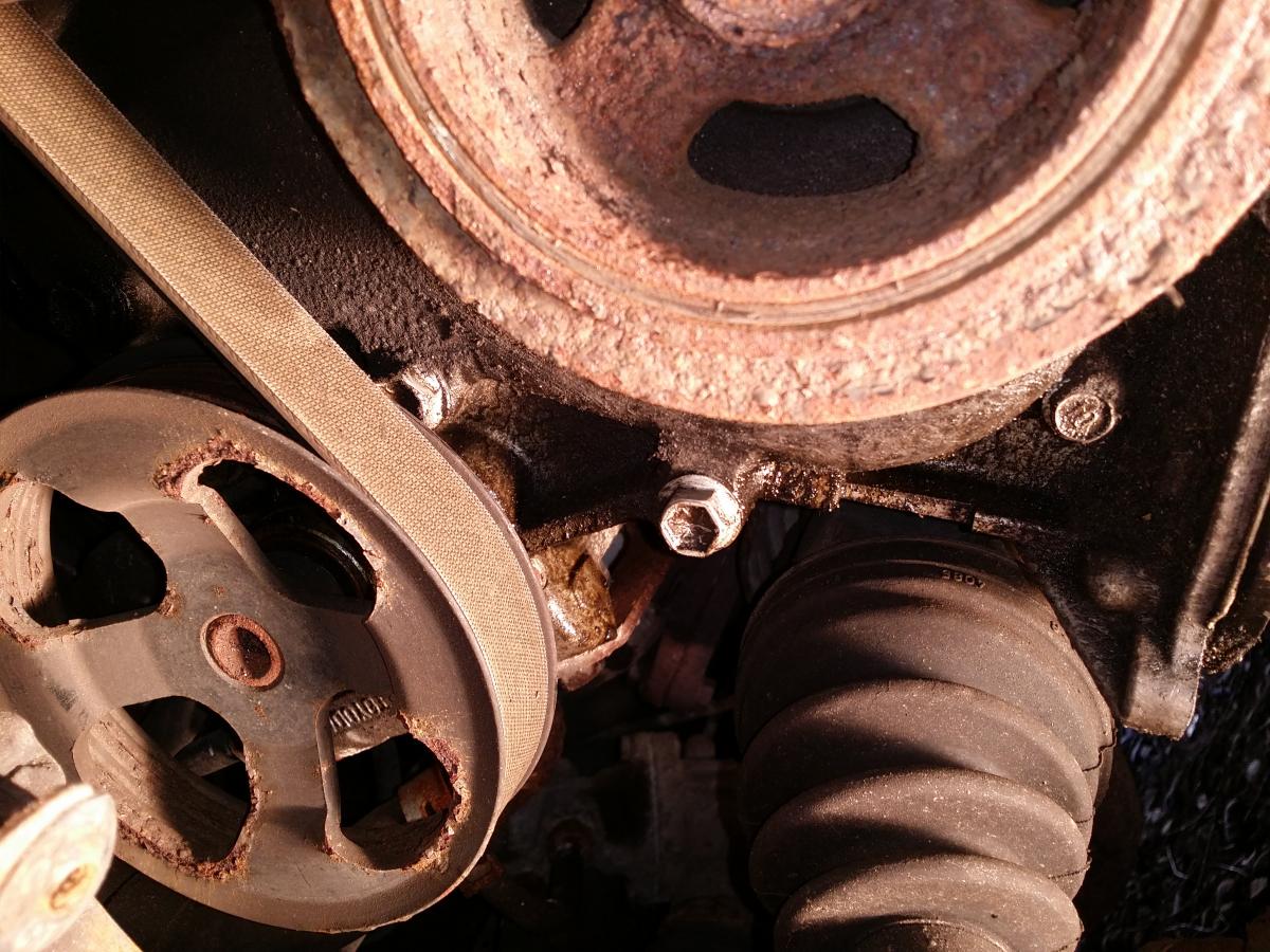

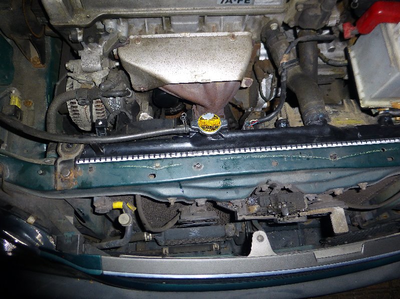

Going to add a few pics of the rad and also of where i found she's weeping oil which explains the minor loss of oil i've experienced and was putting down to being burnt,not matter how confident you are in what you believe the barrage of bad press concerning the vvti and it's oil problems has you doubting youself even when you know you're as sure as you can possibly be it' s not being burnt....... txtd the gf last night '....... found an oil leak aswell am delighted' :)

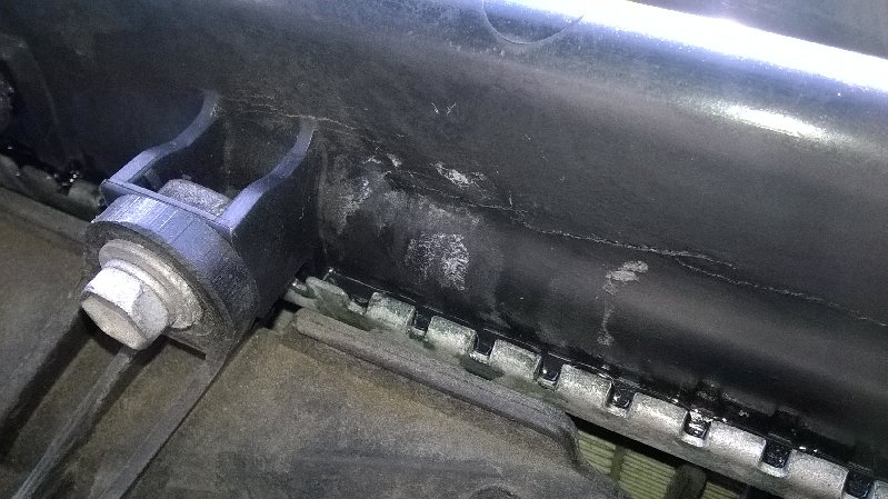

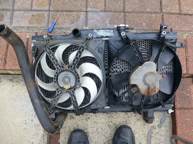

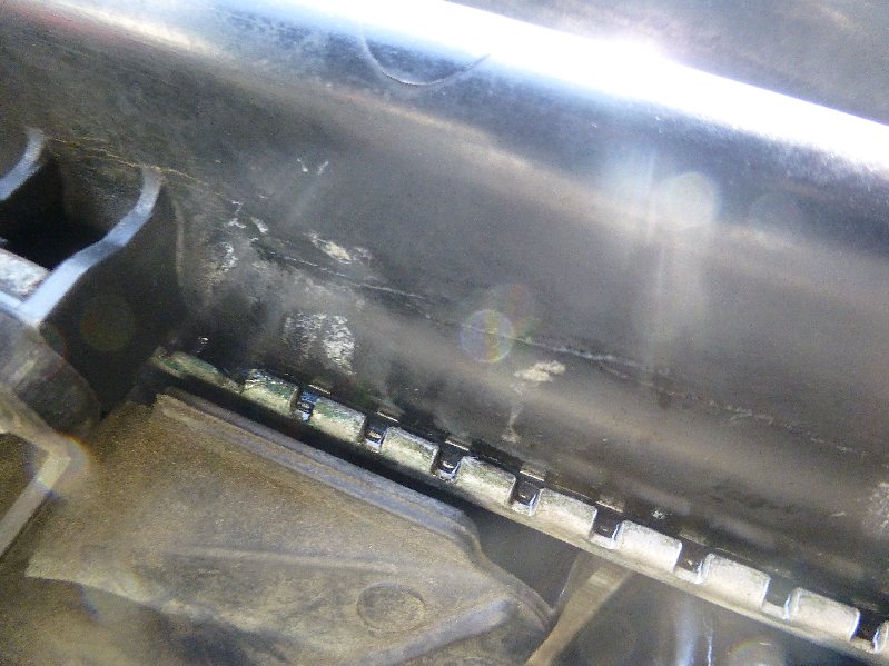

Hi FastBob,
It is interesting how hard leaks are hard to trace, then you find not one but two.
I had a coolant leak which at first had no obvious drips. In my case there was a hairline crack in the plastic part of the radiator.
post-76861-0-18499900-1428868642_thumb.jpost-76861-0-92015400-1428868650_thumb.j
Got mine from Euro car parts for just over £50. post-76861-0-69611700-1428868690_thumb.j
Got home and removed the old radiator and fans, after draining the system post-76861-0-80190300-1428868674_thumb.jpost-76861-0-64378400-1428868781_thumb.jpost-76861-0-23404300-1428868835_thumb.j
Then after swapping the fans re-installed the replacement fans post-76861-0-60522500-1428868889_thumb.j
An easy job if competent.

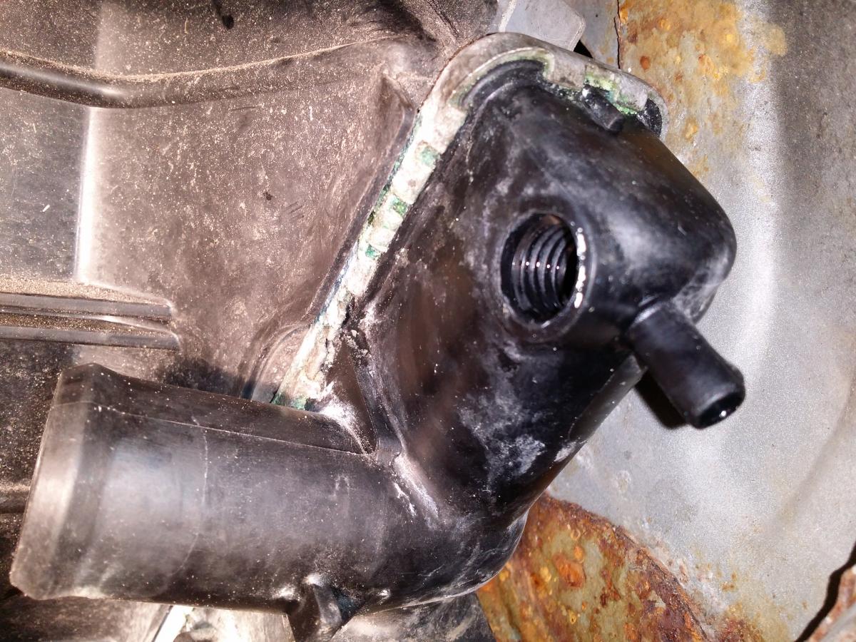

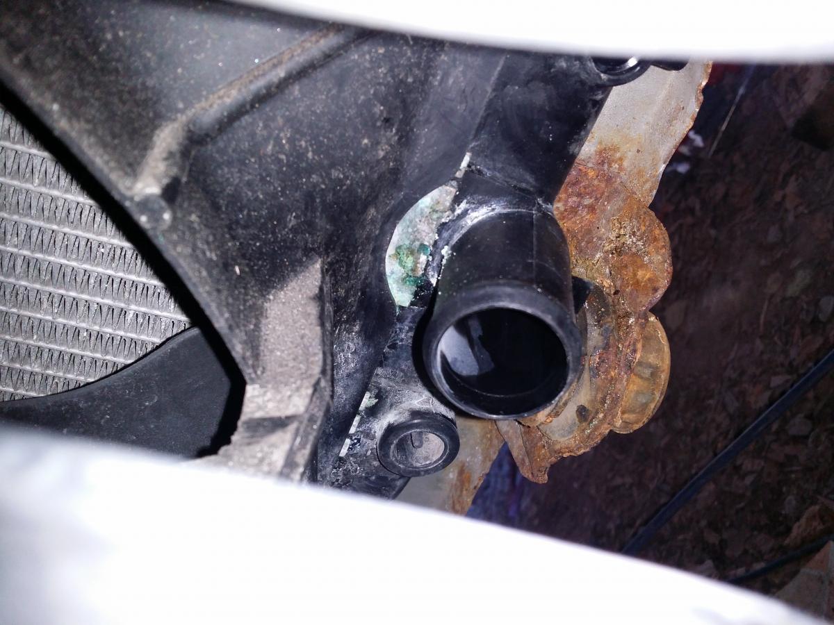

Hi Konrad thanks for the reply. I knew or thought I knew where the leak was coming from and I waa right mostly. I could see the small coolant stain appear within minutes of parking up always the front driver side maybe 6 to 8 inches deeper than below the bottom hose but the undertray caught it and fluid dripped from where further in towards the inner wing. It's impossibe to see the connection from the top and requires reemoval of the drivers side wheelarch liner and preferably wheel to reveal the bottom hose fit the radiator. Even then it's not easy to see properly from the wheelarch but did confirm it was that union that leaked.
The hose clip was rusty, the hose looked old and didn't seem to fit squarely like it should so in my mind it was 50% the hose, 40% the way the hose was fitted n the clip and 10% the radiator itself. Or at least that was how likely i felt each causr to be.
More than ever before I wish I had a pit or those hydraulic ramps like in kwikfit because the best access to these cars seems to be from below, mine is up on an axle stand and it makes it a nightmare to access even with all the trays and liners removed but the crystalline coolant around the lower finned part of the rad isn't visible at all until the hose is removed completely, the hose may still be a problem but I expect it's the rad that's leaking. I'm sure I've read they are prone to failure at that point. 0c09c91c901ee8ed9987f85215b5277b.jpg2f372594a03e8c294874e33b139cc5a9.jpg
The hose is old but ins't perished or split so i decided to reuse it after a thorough clean up, it's done the trick as there is no leak there with the engine running.
I just cannot get it to bleed out all the air and after topping it up at the rad, manipulating the hoses to purge the trapped air the running it with cap off it is still overflowing at the cap, when the levels just above the bottom of the filler with the engine running it rises till it overflows constantly doen the back of the rad n fans. I've worked air from all hoses including to the heaters which brings out air bubbles, the level drops an inch the slowly rises until overflowing again.
I've gone through this entire procedure many many times since last nightband clearly there's a problem, something is pushing the coolant level higher till it runs out.

A mild coolant leak from the botton hose and very slight oil usage were the only issues with a sweet and crisp motor, the oil it turns out is seeping very slowly from behind the timing chain cover which I had read is very often where the 1ZZs and 2ZZs missing oil is going to but obviously it's assumed to be being burnt according to a post I read by a Toyota mechanic in which he claims he's seen this often. I had hoped to find the signs of a leak there but didn't expect to be so easily condirmed, i'm exceptionally happy about it as if I halfed my oil usage over the same distance suggesting half my loss was used, half leaked it would mean my engine is burning 0.5 litres per 3.5-4,000 miles which is right back up with what I'd expect of all engines normally.

I've heard some criticism of that rad but most of the parts I:ve bought from there have done there job nicely and for well less than the OE equivalent so when the time comes I strongly suspect that's where I'll get mine.
They look like the twin fans i ripped off a 205 diesel van years ago and grafted to my 2.8 Capri after ditching the viscous coupling engine driven cooling fan.

As for the oil leak it's clearly from an area that's not under any real pressure from exhaust gases, vaccum or gears rotating. It's like the coolant leak it has it's origin deep behind the engine components maybe seeping from a source behind the chain cover and inner wing but. it's a nightmare to precisely place it when theres allsorts covering it up, an engine mounting restricting access from above.
As I said I'm happy it's just an oil leak. I'll have to dig out the post in question and repost if here because I believe there are enough vvti owners here who may be losing oil and assume it's being burnt because of all the bad press over this engines oil useage Am oretty sure the leak was from or close to the chain tensioner.
Yeah thess flimsy cover plates are prone to rattle loose or easily overtightened on refitting.There will no doubt be a specific Toyota sealant for it but usually a generic sealant will work as well as the OE as it doesn't have to cope with pressure negative or positive, specific chemicals just oil, no extreme temperature or bolt forces so a good aftermarket sealant will do if the OE Toyota sealant is more expensive

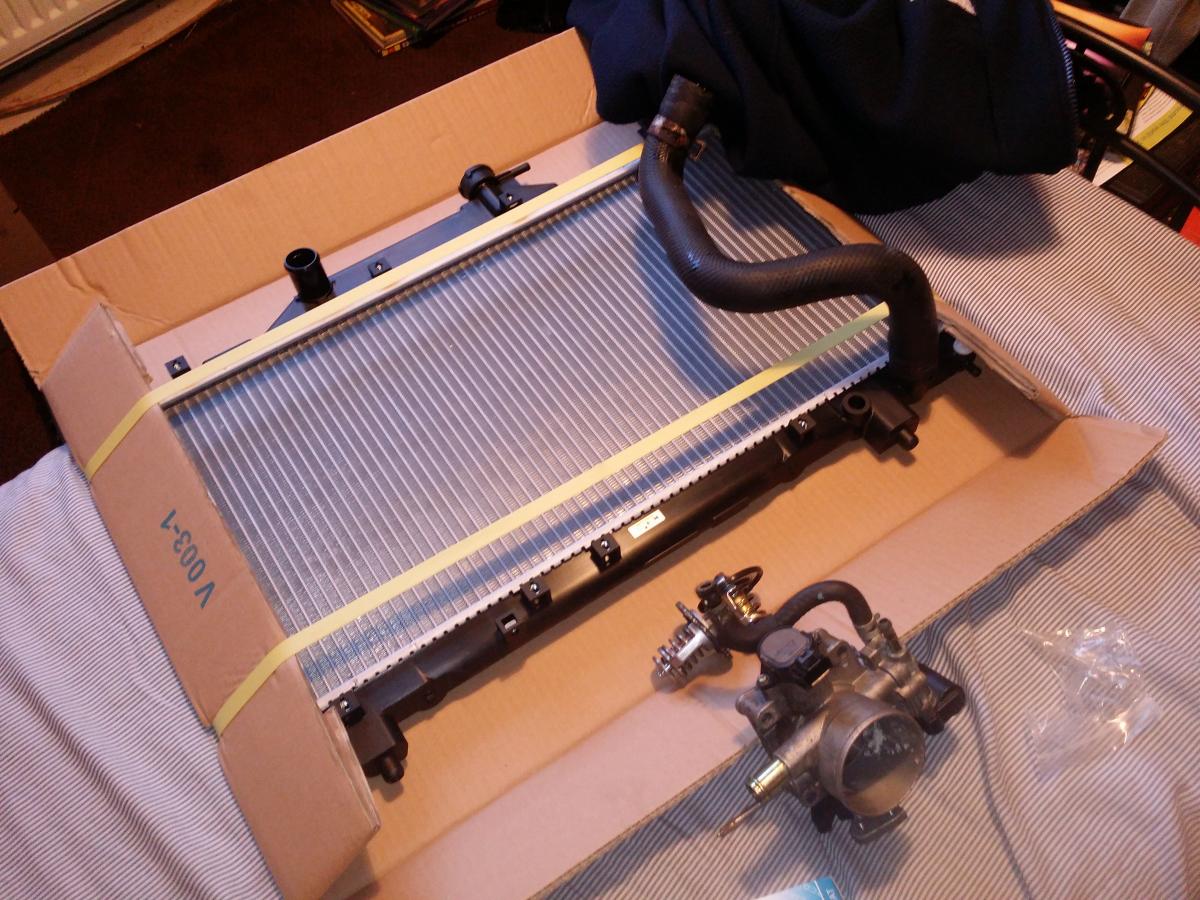

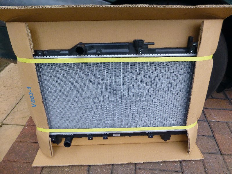

Well picked up new radiator and thermostat from Europarts today. £76 in all wasn't that bad I thought.

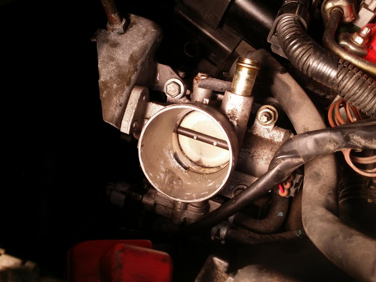

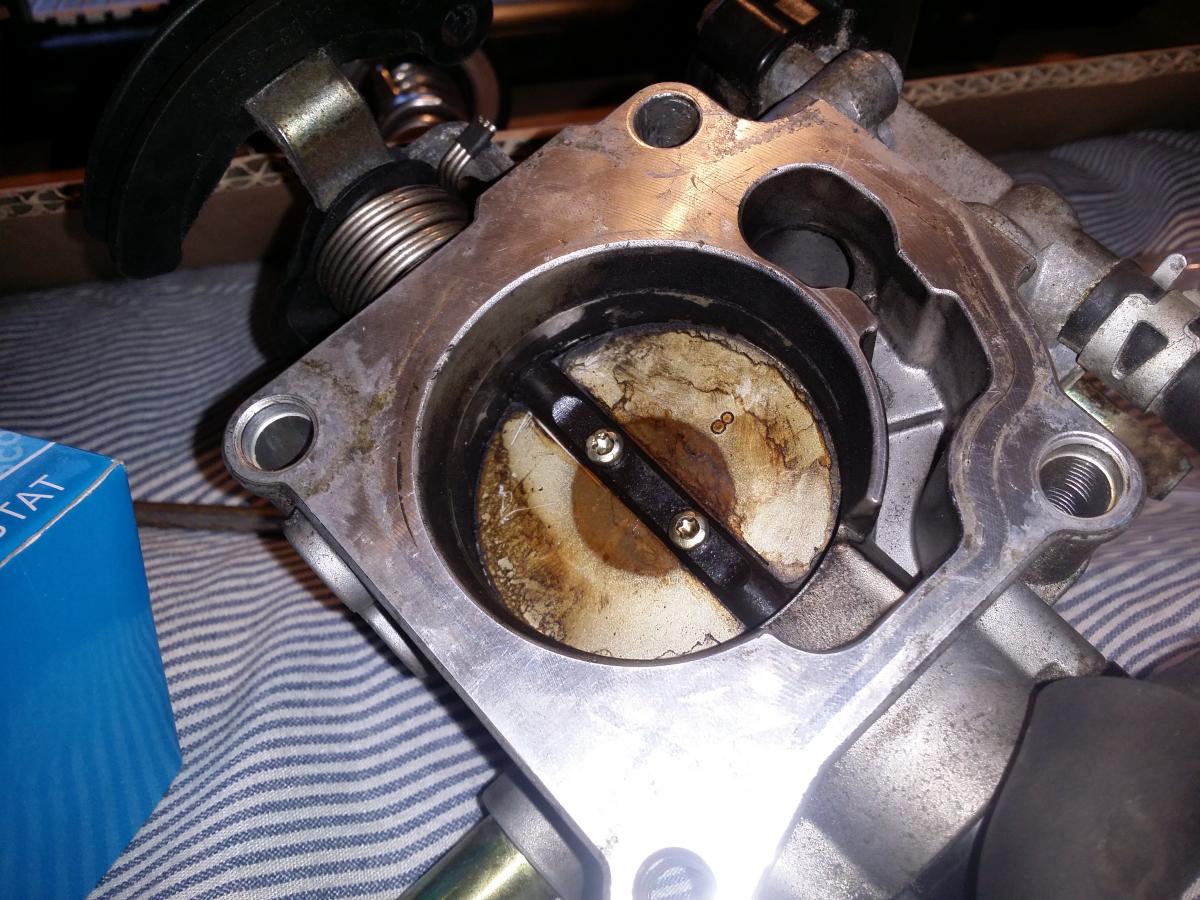

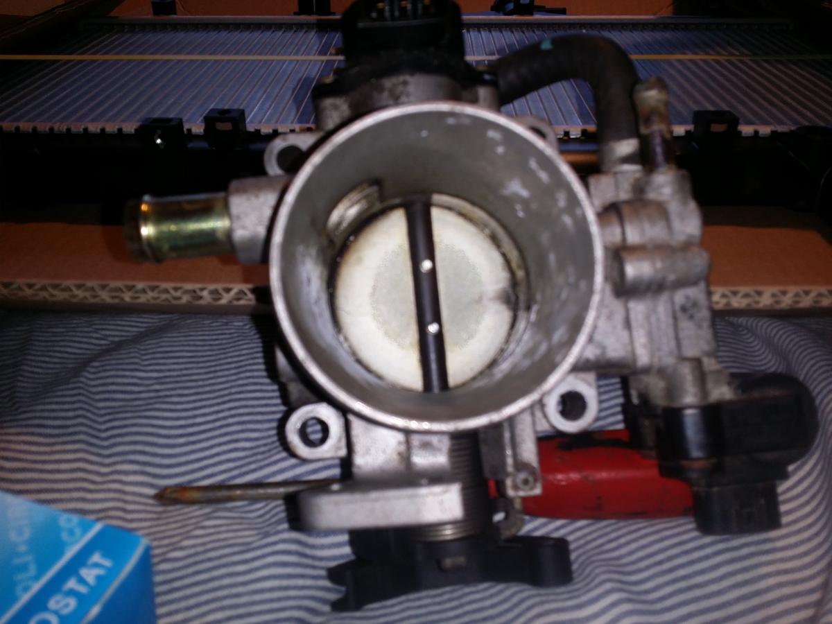

So yesterday when I got in I took out rad n contemplated removing altenator to get at thermostat housing. Chose to go in via the throttle body and inlet manifold way so off they all came lol.
There was an area of shinier oil in the plenum and back of the inlet valves all had a film of oil over them but crucially it was even across all 8.
The throttle body is the least appealing with both a thin build of oil on the engine side and what looks like alloy oxidisation the filter side of the butterfly.
Anyway 2 days off sonas much cleaning and degreasing all the areas of the motor that will beyond reach when the whole lot is assembled :)

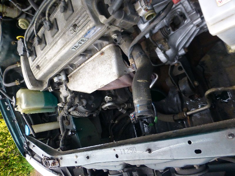

Finally got it put back together on saturday on my day off, no leaks, nor trapped air, job done although it took a fair amount of bleeding to get all the air out in the end :)
