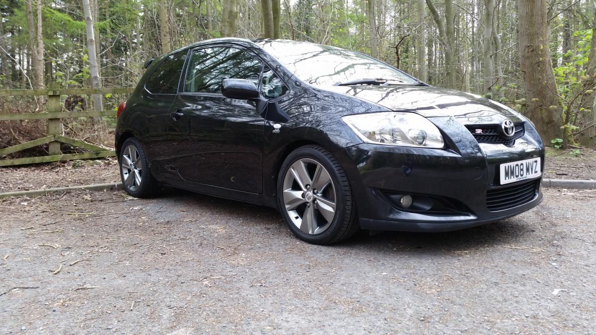

I've changed the alloys on my SR180, and fitted a grill Badge, but it is otherwise completely standard. I'd be interested to know what other OE parts are an easy swap over. I'm sure I've seen a post where someone fitted a new steering wheel and gear knob etc? Any other upgradeable parts?

Is your Badge on the correct side? I thought they are usually on the right side, if standing in front of the car. That's how my TRD Badge is fitted anyways.

I've made the Badge myself, so it can go wherever I fancy. And what I was after was suggestions of which parts will fit, i.e. from which models so I can start looking for some.
Yes I understand that it's a custom Badge. I was talking that I think when factory fitted those badges are usually on the other side.
