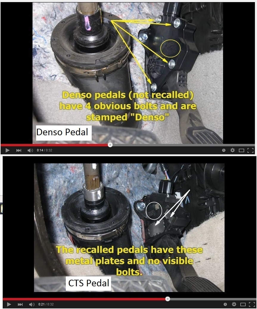

I don't know if the Avensis was subject to the accelerator pedal recall programme same as the Auris was.
If you have the CTS pedal fitted to yours get them to change it to the Denso pedal.. I did with my Auris.
post-140480-0-88325300-1430580429_thumb.
Thanks i will check that
