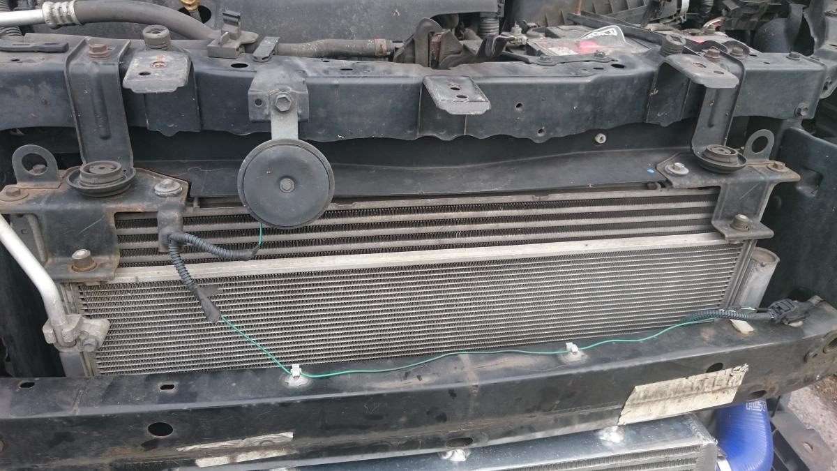

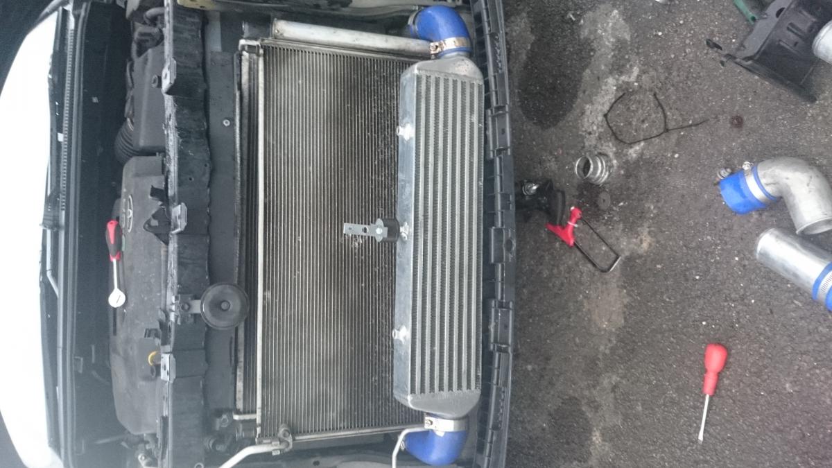

Here is how far I have got so far tonight, im just waiting for the drill to charge to bolt in the intercooler. The standard one sits between the air con radiator and radiator. Once removed all that looks to be required for plumbing it in will be 2 straight pipes probably around 30cm im just mounting it for now whilst I wait for the pipes to arrive. Will put more photos up when all back together again!

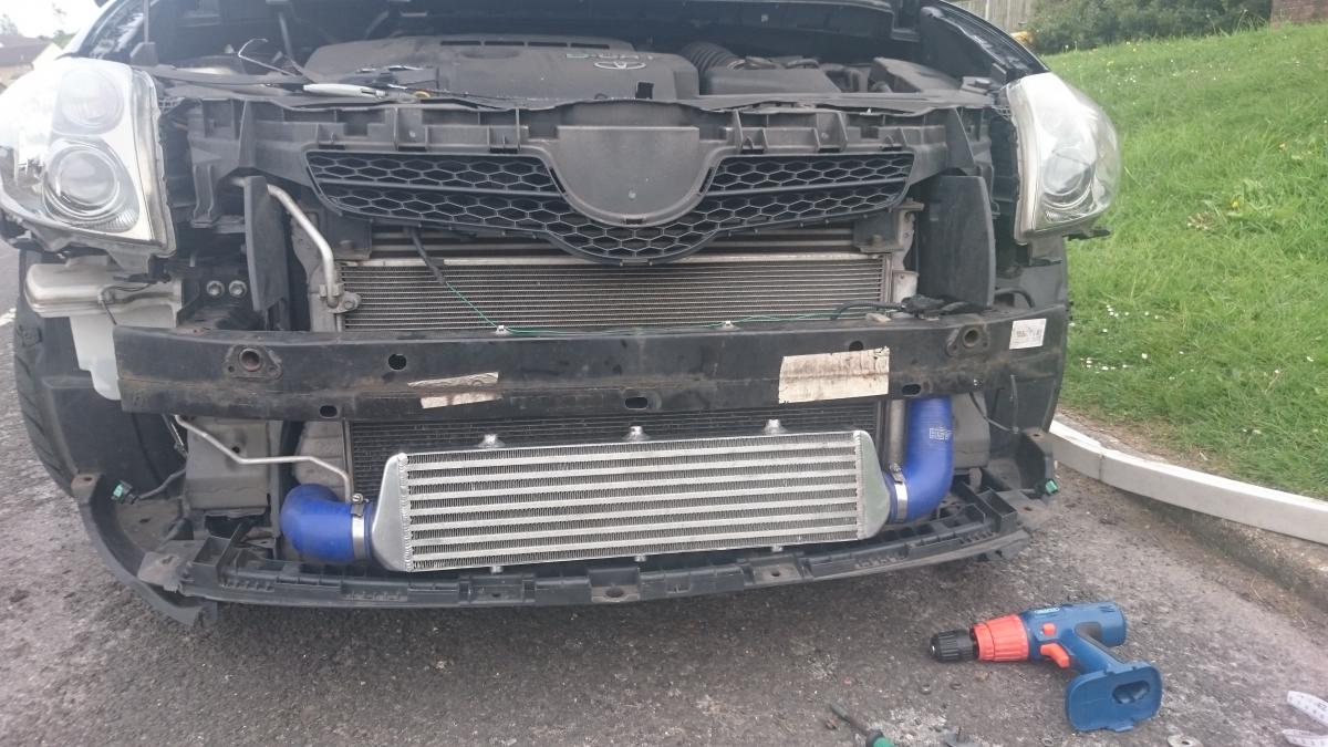

Put it back together now not sure if I like the way its sitting plus ive got to tidy up where I have cut the bumper but this is the way it is sitting now

Is it sitting slightly cock eyed
I think slightly yes, im not sure if I can live with it ***** eyed ha ill have to adjust it when im plumbing it in

I bought mine used off eBay 60 quid posted but these are the measurements lenth550mm height140mm width65mm length with pipes fitted around 89cm. Piping goes to the standard intercooler at around the same position as where they are needed for the front mount so all you'll need is a couple of straight pipes to connect up aswell as the 90 degree pipes that come off the intercooler. All being well my pipes should come today and ill plumb it all in ill keep you all posted how I get on

No original intercooler is mounted between radiator and air con radiator. The standard piping looks like standard black hosing, I have not removed standard intercooler yet as I am waiting for the pipework to come, I got a used pipe kit off a s14 thats 2.5 inch but I also have 2.5 to 2 inch reducer pipes I will let you know when I know more as I'm just really tackling it as I do it but don't really want to be taking it to bits without having the parts as it is a daily car

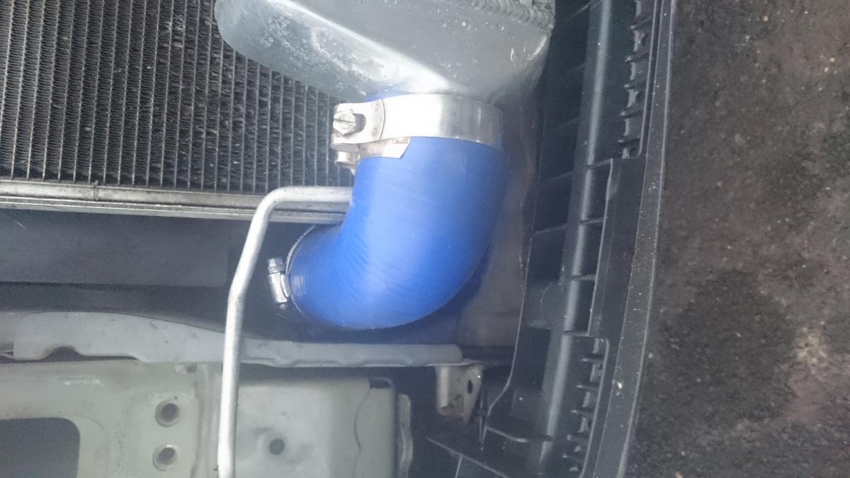

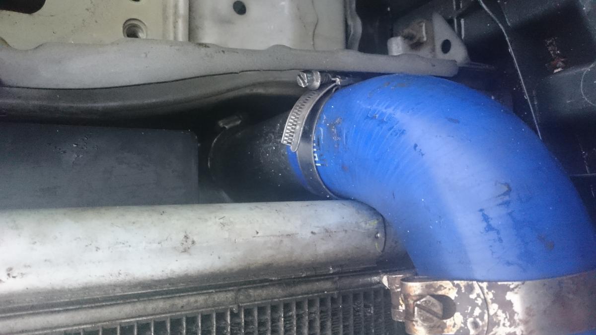

Plumbed it in today but as soon as the boost builds up it pops a pipe off, im going to order some pipes with a lip on to replace what ive got but here are the pics. I dont think it'd be possible to swap the air con and intercooler without a lot of ****** about

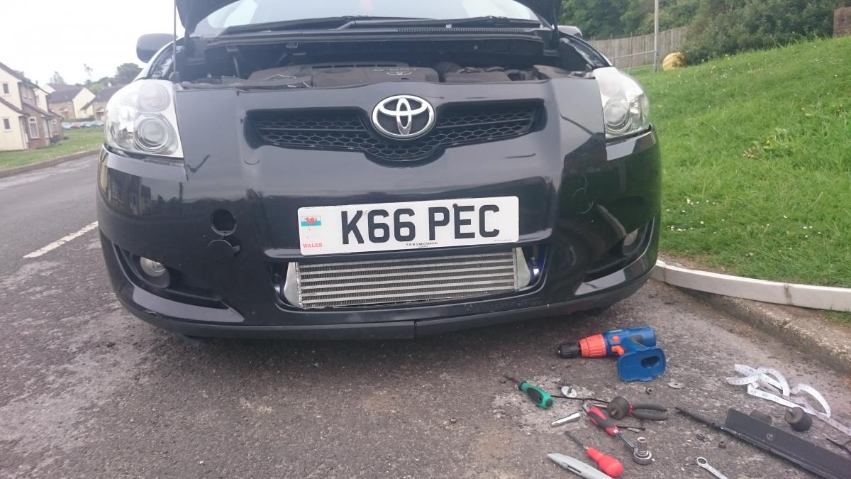

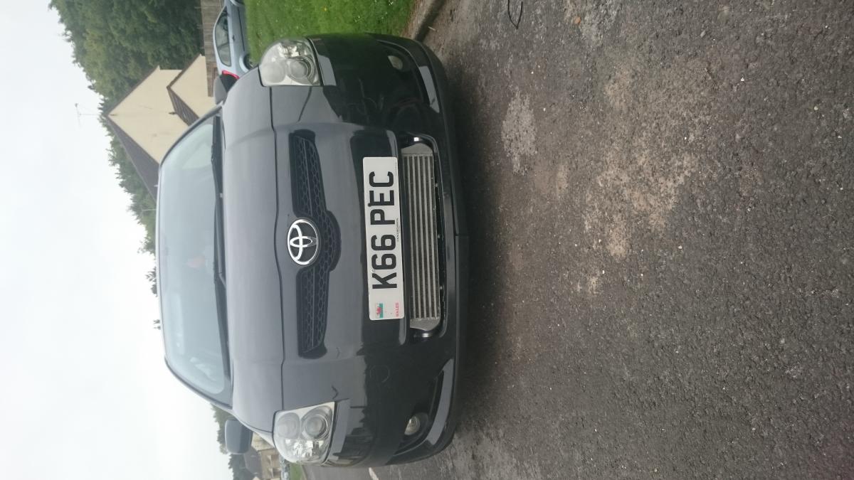

Finished this off now, the parts you need if you want to do it are:
Intercooler (measurements in this post)
2 x 90 degree pipes to go from the outlet of intercooler to feed back to the car)
2 x 30cm pipes 2 inch diameter (bevelled at end)
Nuts and bolts and some brackets
Car seems to spool quicker but I have only took it down the road and Back.

You've done a great job fitting all that lot but I just wonder about a couple of things. Do you get any wind buffet noise from the front after cutting the bumper and don't the metal outlets from the intercooler and joint pieces have any swaged lip on them to stop hoses from blowing off?
Hi Tom, Yeah they do thats what I meant when I said bevelled, couldnt think of the word! The car seems just as quiet as before. Just been out in it taking wife to work and it just pulls a lot nicer. Cheers
