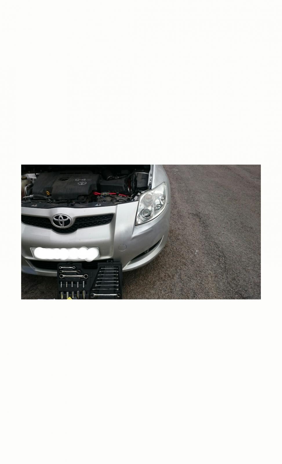

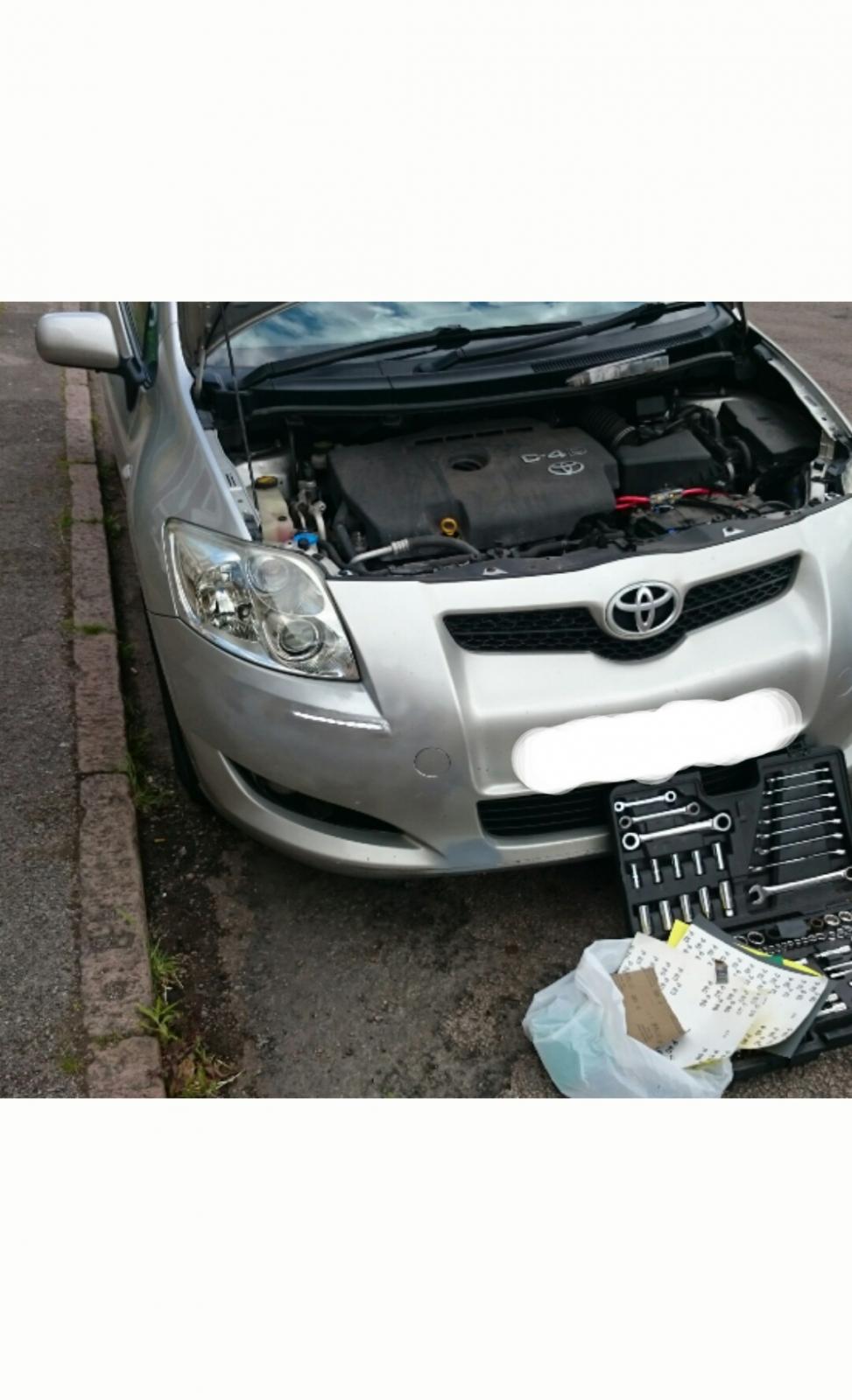

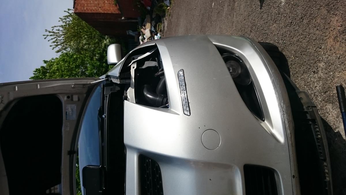

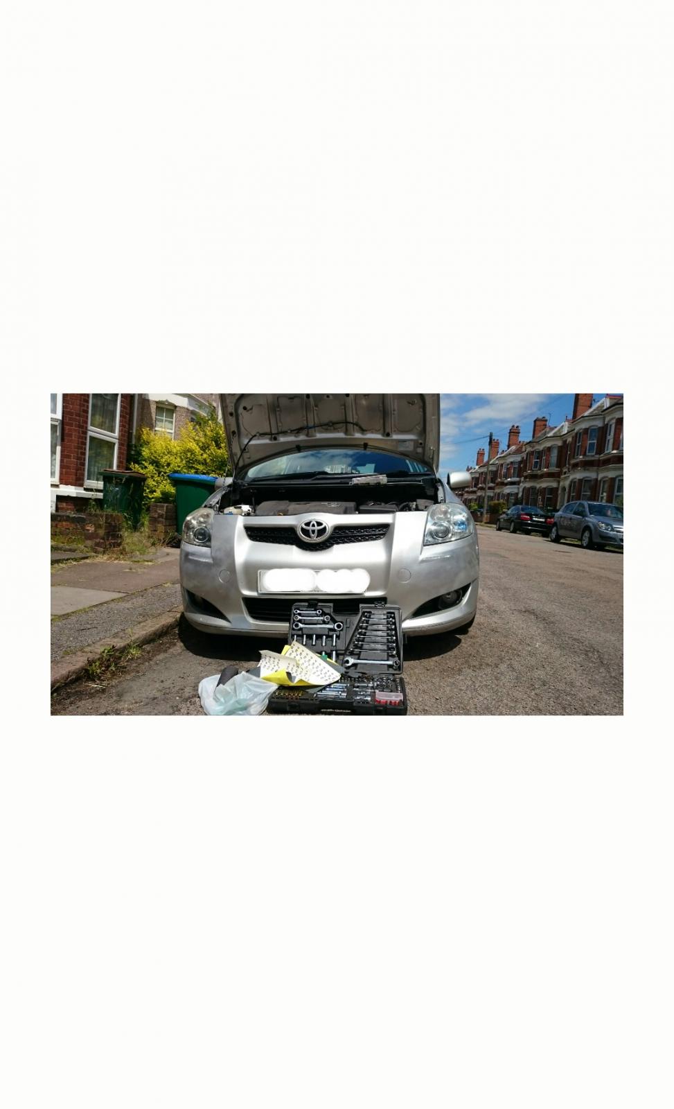

So boys and girls. What do we think?
post-130876-0-34072000-1431699723_thumb.
Looks smart I thought you had them in your lower grill
Looks very good I have to say the rear lights look the part and the drls dim down when you put the lights on .... Personally I would have maybe put them lover possibly closer to the fogs or very in between the normal lights and the fog lights
Thanks :D. The reason I put them where they are is because I wanted them to look stock, and it looked more natural if it followed the curve of the lights.
Right oh sayin that I would imagine u played about with them
Looks nice. So which ones did you use and how did you install them?
Yeah, I'd love to know which ones you used... I'd like to give it a ago...
The Drls are these from Halfords (I'm sure you could get them elsewhere)
http://www.halfords.com/webapp/wcs/stores/servlet/ProductMobileDisplay?catalogId=10151&langId=-1&categoryId=310505&productId=787859&storeId=10001
They perfectly match the curve of the first gen auris bumper. I used a rotary tool to cut out the holes for the lights, and they are attached to the front crash bar with a bolt. All that's left for me to do is use some bodybuilder to fill in the gaps and paint it. The fitting was a full days work.
That's great. Thanks.... Another project for this summer..
