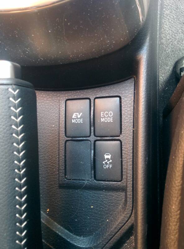

The button between the front seats just in front of the handbrake with the VSC symbol on it. (1 of a group of 4 on the Yaris - one being a dummy)
4 buttons near the hand brake on a Yaris HSD? Really? My 62 plate one has only two there. Ones the eco mode and I forget what the other one is but 4 there ain't.
He never said there were four, he did mention blank(s) being there also.
Colin your car looks mint I wanted to get a black one but my wife was more in love with the pearl white,it's lovely too
From memory [can't be bothered to go & look] ..... Eco Mode. EV Mode. Traction control. Blank. [64 plate]
Here's a photo...
Thanks! We love the black
I'm not sure in which revision the Yaris Hybrid acquired the VSC off button, but the original Yaris Hybrid I test drove when they first came out only had ECO & EV.
I don't recall seeing a VSC off button in the Auris Hybrids I've driven either, but my 2012 Prius certainly doesn't have one.
Only 2 buttons in our 62 plate hybrid yaris (and 2 blanks).
