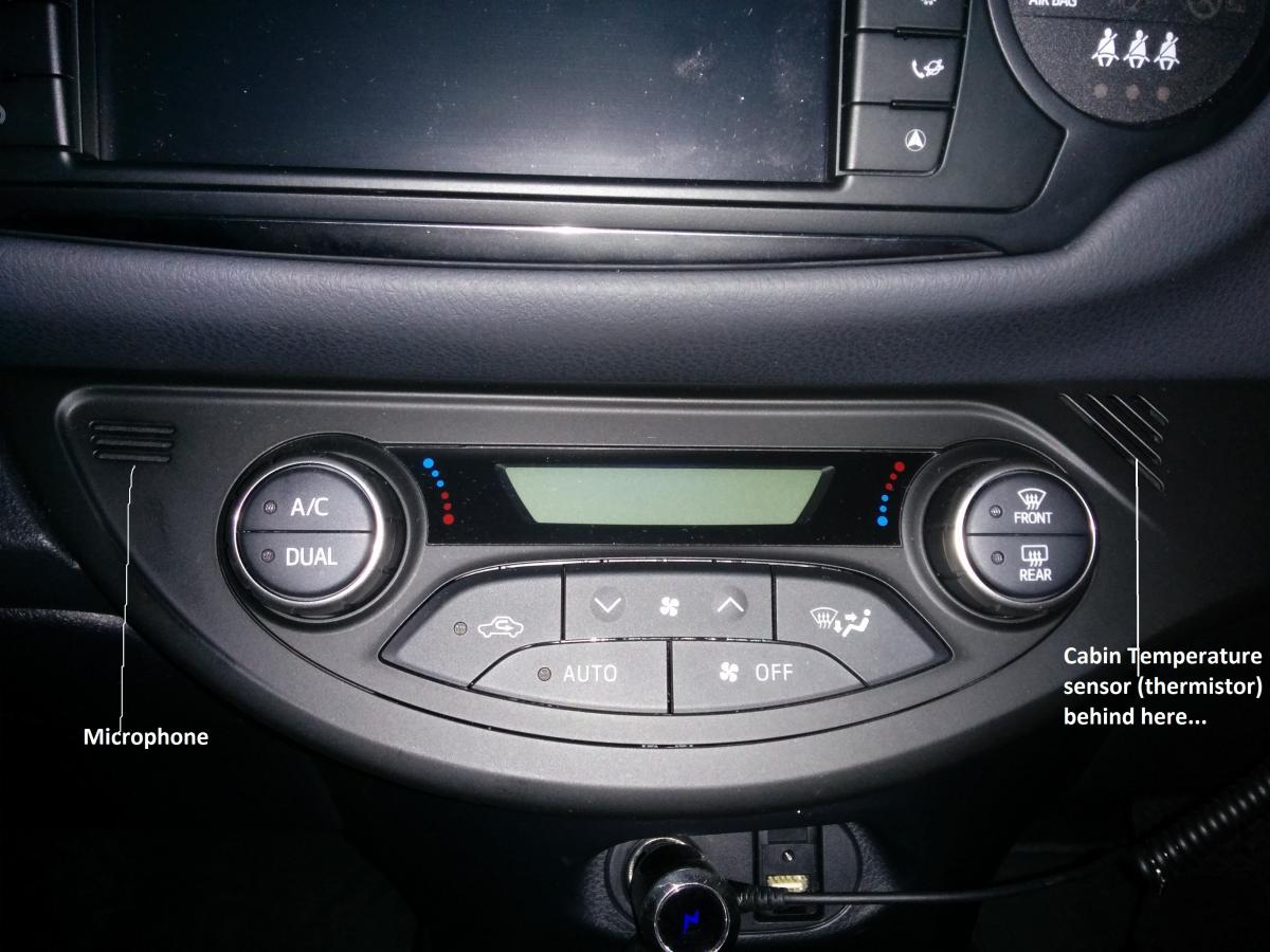

It states in the handbook that once you pair your phone with bluetooth, the Touch2 will recieve and make calls hands free.
I checked the compatibility of my phone and its listed so I have no problem on that front, what I am wondering is where have they located the mic that pics up your voice or do you have to buy one.
OK, FOUND IT NEXT TO AIR CON CONTROLS. :oops:
I thought it was in the ceiling??
No, it's a small triangular grill next to the air con controls
The mic in my Yaris is in the front roof lights.
Are you sure the grille next to the air con controls isnt for testing air temperature in the car? Just a thought.
Agreed, this is what its normally for, to monitor the cabin temp to know if it needs to be pumping out hot or cold air.

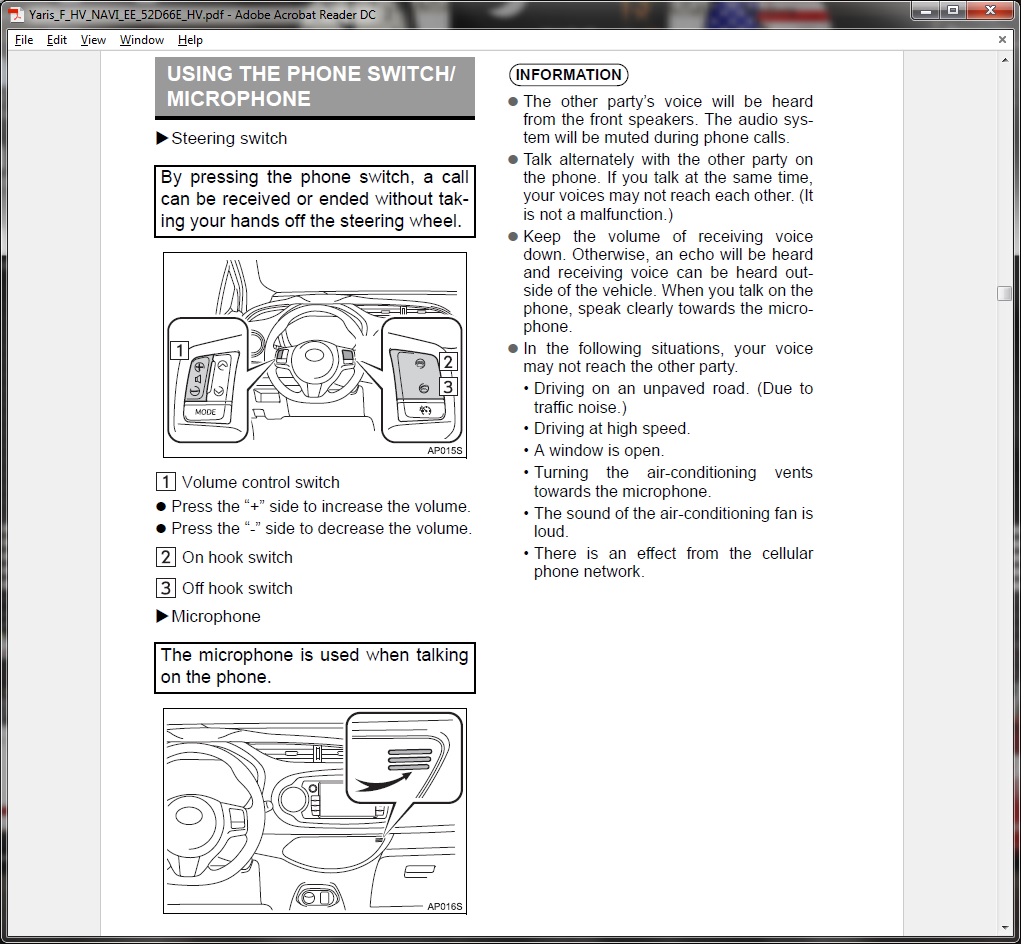

Then you all need to check page 64 of the Head Unit manual... ;)

No it's not... :)
Obviously that manual page is showing a left hand drive car and ours are the other way around as in this photo...
post-126463-0-77074600-1433547221_thumb.
The eagle eyed amongst you will have spotted that the mic is nearer to the front seat passenger than it is to the driver...

Indeed I did Ian. What I am also curious about though is where the second temperature sensor is on an Excel with Dual Zone Climate Control?
A lot of manufacturers use IR sensors to monitor dual climate control.
Well the primary one (behind that r/h grill) is definitely a thermistor as you can physically see it...
At the base of the windscreen? It is on our 2014 Yaris Trend and my PiP.
