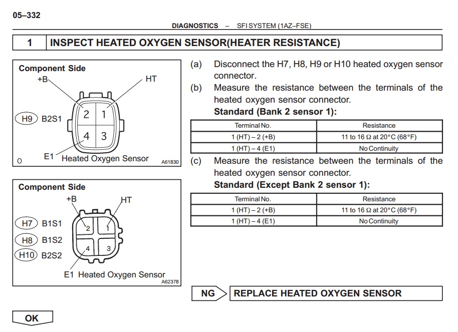

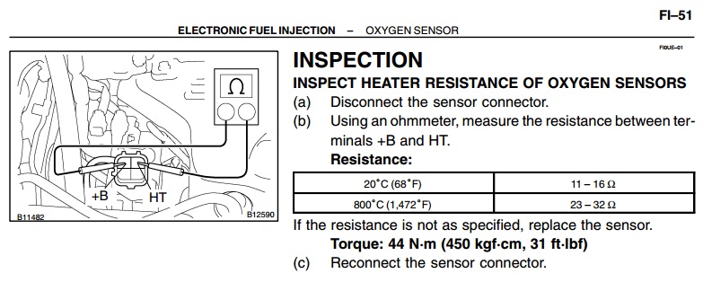

There is a way of check the sensors by measuring the resistance of the heated circuit of all four. I did this with my sensor last year. I got a good sensor from a scrapper and did a resistance check on that, the intermittent one on my car, and the old faulty one I replaced years before. Now if the 3 sensors show a different reading to the one good sensor, then change them. I would change the 4th too!

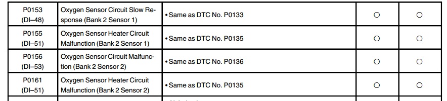

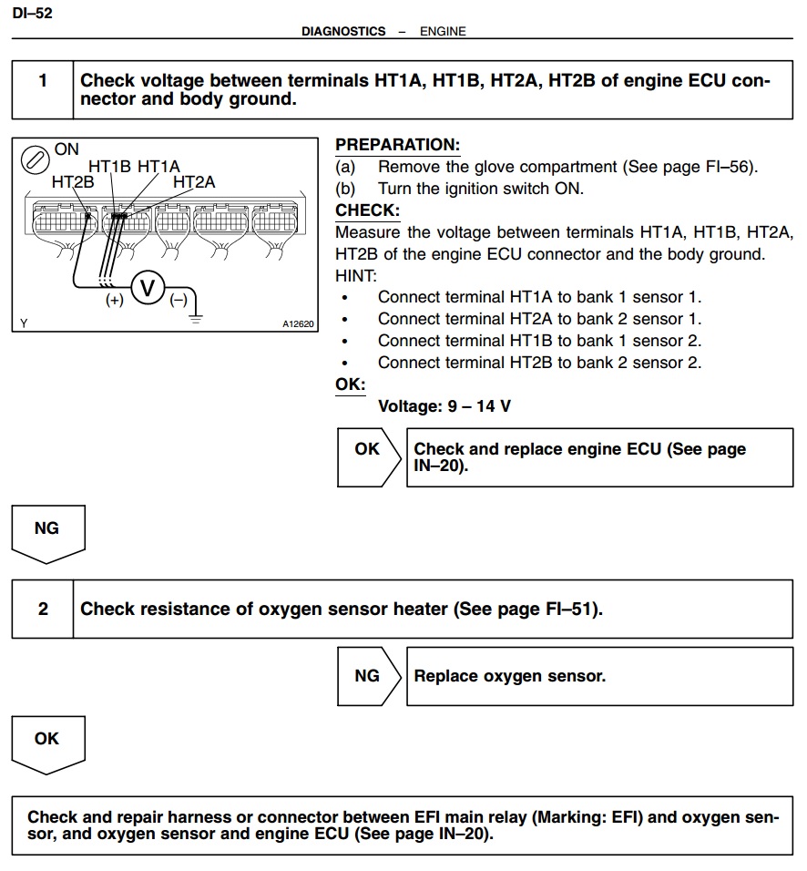

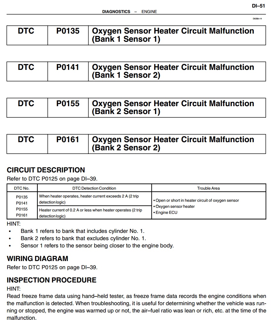

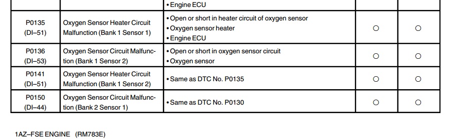

I have attached some relevant images from the manual for the 1AZ-FSE in the first generation Avensis (RM783E). According to this you should check the engine ECU first and the oxygen sensor heaters second. In the manual for the same engine in the second generation Avensis they have reversed the order, which makes much more sense as it is easier to check the sensor heater than checking the ECU. You will also see that they have switched "OK" and "NG" on step 1.
