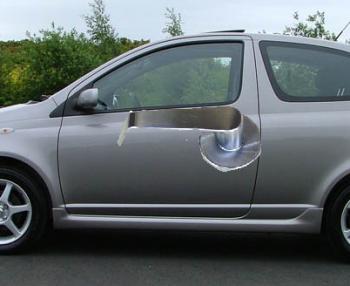

or you can put something as loveley as this:
(did it in 5 secs so dont tell me im a lousy "photoshopper")
looks fine to me ROFL
:D
sounds like a lot of trouble for a couple of handles ryan m8...
and even without handles you're still going to have the rear doors!....
I can see what you're getting at with the hidden handle effect ala alfa..
but surely the purpose of it is to make it look like the car doesn't have rear doors? :D
