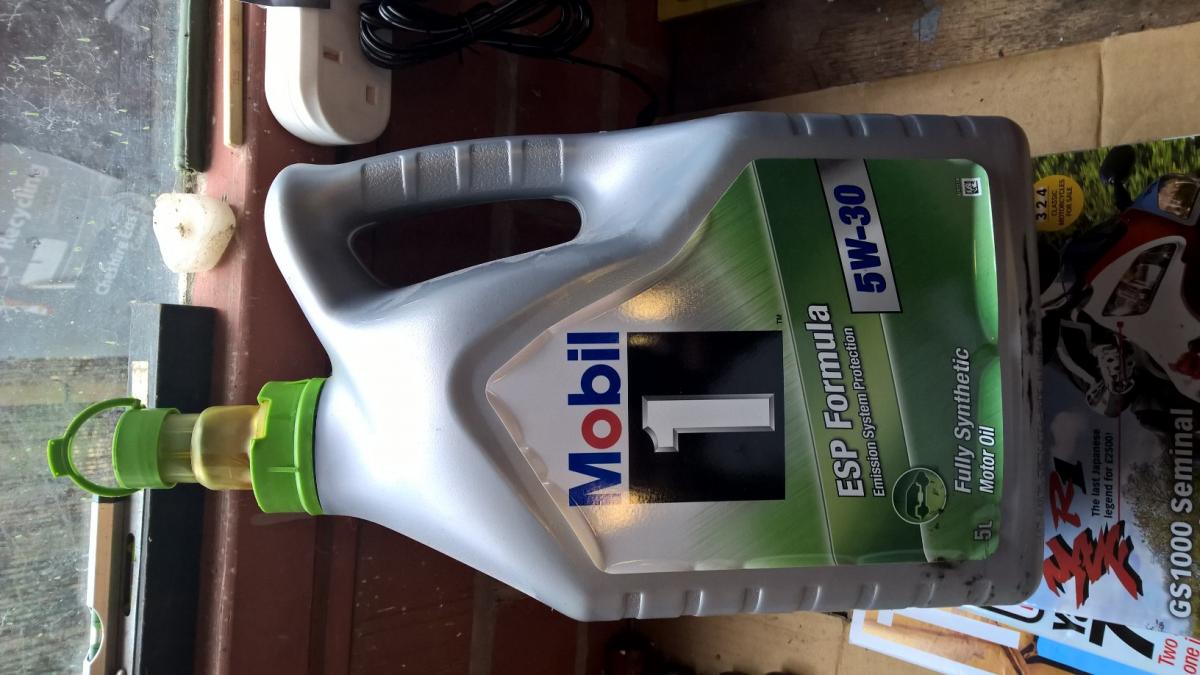

Here's a pic of the stuff I use.
post-49435-0-26798700-1437391413_thumb.j

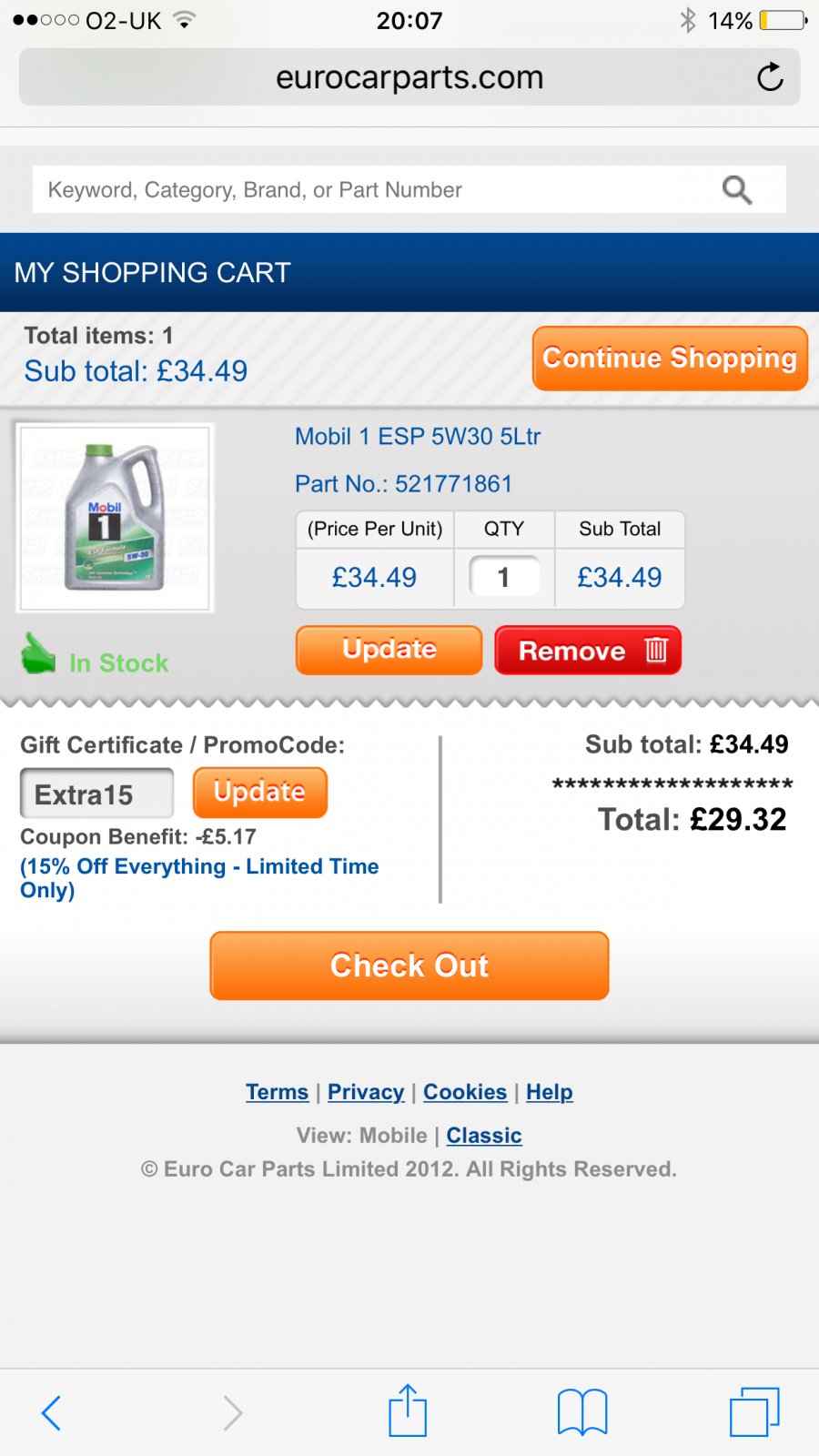

Actually just been advised if you use the code extra15 it works out to just over £29 😉 Ordered a couple of 5litre cans
post-115858-0-64424700-1437505741_thumb.
