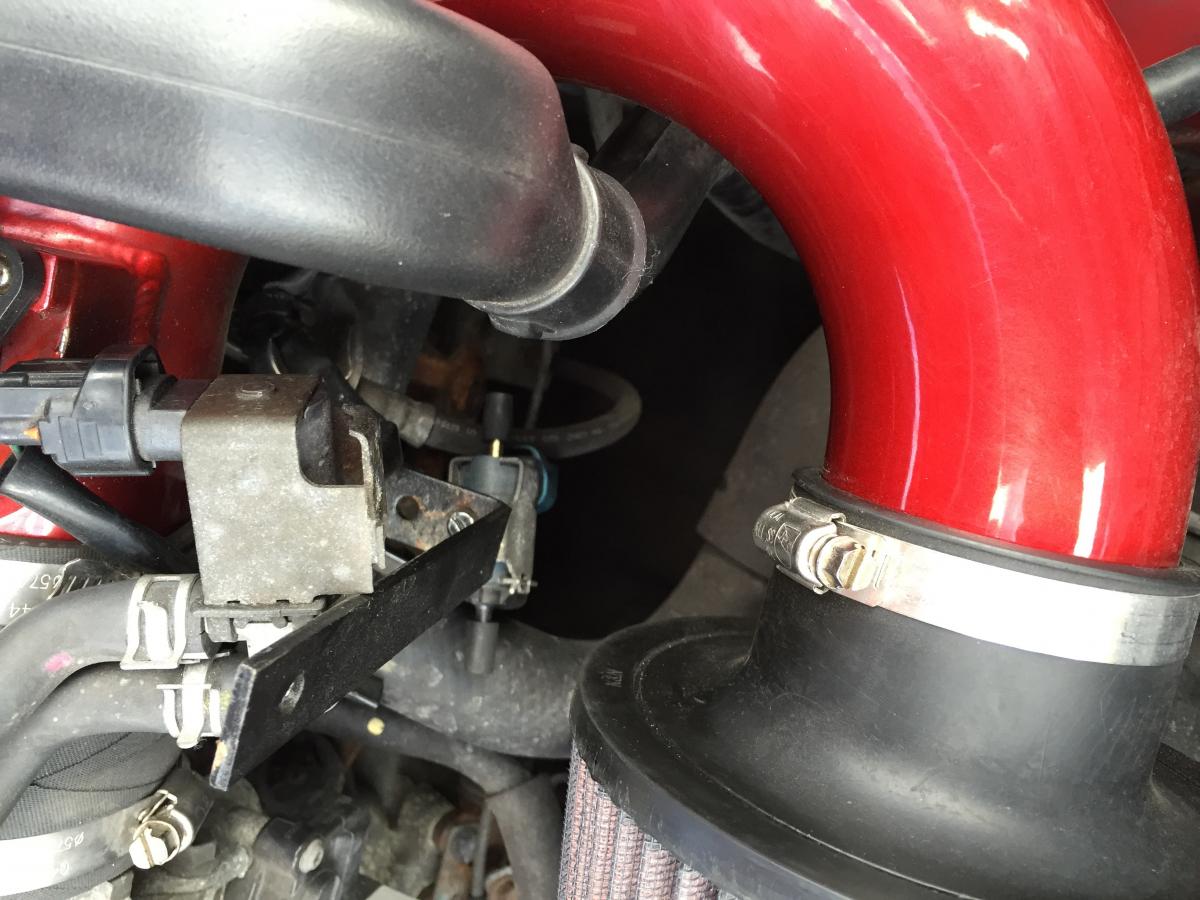

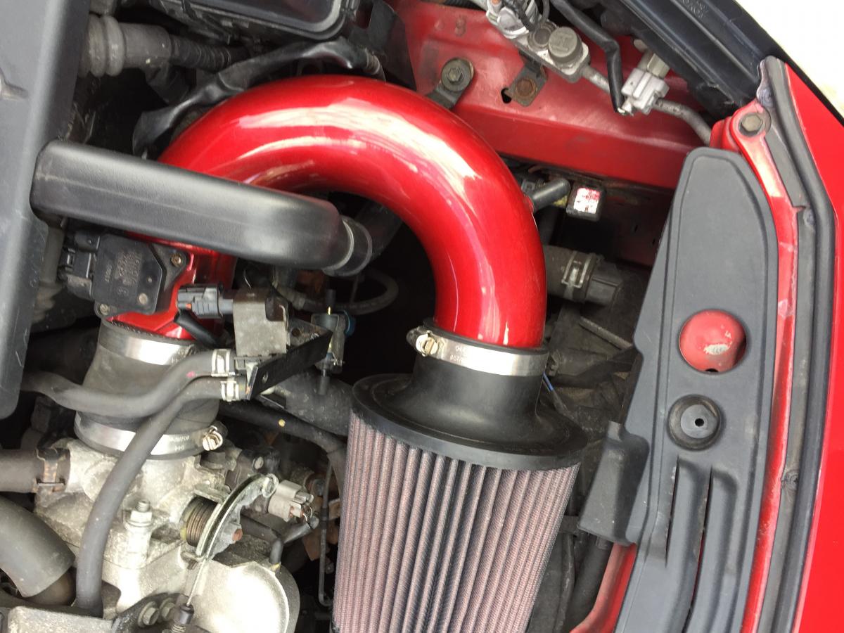

Here is a pic of the fitting I just want to know if anybody can offer any advice and if anybody has had the same problem after having one fitted and if so how did you get round the eml problem?

A few more pics if needed, there are two pipes you'll noticed that are blanked off

Looks like it's just a short-intake induction kit, no forced-induction mods like a turbo or supercharger.
Shouldn't cause a problem normally, but it's common for amateur installers to damage the MAF sensor when installing these things.

Most of the time it's usually a hole that hasn't been bunged up or a wire that hasn't been disconnected properly, It's been 6 years since I did mine, so when I changed to a Injen filter all my vacuum pipes were already disconnected and diverted, so can't fully remember, but I think the K&N instruction are faulty and a vacuum pipe needs to stay and they just blank it off, it's the one that goes from the inlet manifold around to the air injection system I think, but this doesn't always cause a CEL.
Here's a pic of my engine bay when the airbox was removed
All the pipes circled in red are what come off the standard airbox, these should be fully removed and the blue electrical clip undone (I believe with the K&N you actually get a bracket to stick this clip on out of the way, on the underside in your first picture in your first post by the black plastic pipe coming from the ecu cover)
Ignore the blue circle
The green circle is what K&N get you to remove and put a little rubber bung on the end of the inlet manifold, this is a vacuum pipe connecting to the air injection system for the exhaust emissions, I don't know what they give you for the air injection side as I have never fitted a K&N filter but sometimes this vacuum pipe not being fitted can cause a CEL, but only sometimes.
