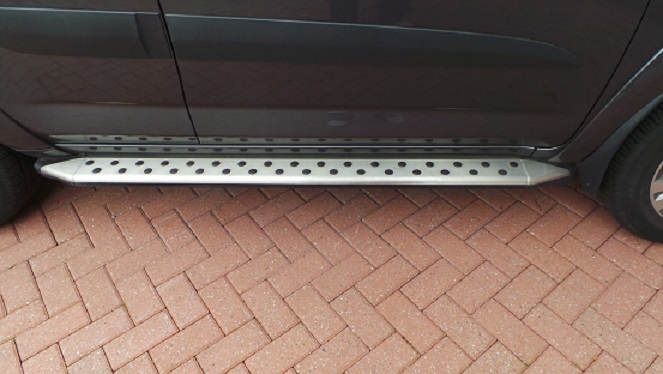

Hi there, when I bought my Rav 2010 SR automatic nearly five years ago I had the OEM steps fitted by my Toyota garage also mud flaps front and rear. These steps were the dotted ones, and did tarnish after about nine months. Later on I read in this forum (about four years ago) that this was due to a manufacturing fault,and if you took it to your Toyota dealer you would have new ones fitted free of charge. I did this, showing the Toyota dealer this reply which I had taken a photograph with my camera of the statement on my laptop from the Toyota forum. The reception chap took my photograph away behind the scenes, presumably to his manager and I was booked in for the following week to have new steps fitted to my car. That was four years ago and the stipulation with the new steps fitted was to wash them at least once a month with soapy water and rinse them down,post-77631-0-34173800-1439295604_thumb.jpost-77631-0-34173800-1439295604_thumb.j and they still look today as good as new. Hope this helps and no doubt that Parts King can verify this. Jock
