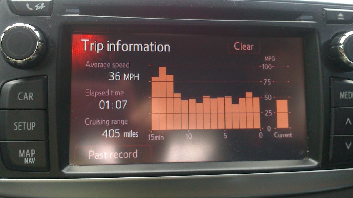

Hi All,
my journey to and from work takes me through a very flat part of the country on very straight 60mph roads. Typically I can sit in 6th gear at 60 mph and the MPG graph sits constantly around 75mpg. However, on a number of occasions over the last fortnight during this very consistent part of my journey the mpg has dropped to about 40-50mpg for between 13 and 18 minutes then shot back up to giving me around 75mpg again. If I touch the accelerator even lightly the current mpg drops to less than 50 immediately.
I assumed the car was doing some sort of regen of the diesel particulate filter, but if that is what this is why would it be doing it every 200 - 300 miles??
All opinions welcome.
Thanks,
MPG_Junkie

DPF regen is exactly what it'll be. Every 200-300 miles sounds about right, it'll depend upon the cars useage pattern as to how regularly it does this.

mpg_junkie,
Be warned, this is indeed a DPF regen, see the other threads I have been posting in "DPF Problem" & Yaris How "many mpg".
Mine is a long and bitter tale, still rumbling on, they changed the DPF last year in May because it was knackered. This last few weeks, the problems have started again.
The regen when my car was new occurred about every 500 miles, Then it got more frequent, eventually getting down to 120 miles between them.
At this point, the sump was also filling up with diesel fuel! This is a bad thing!
Check your oils, check the other threads, there is a Toyota fix for this, involves fitting a new short engine.
I have also been told by my dealership that the 5-year warranty doesn't cover the DPF, because it has a 3 year life. I hope this isn't true.
